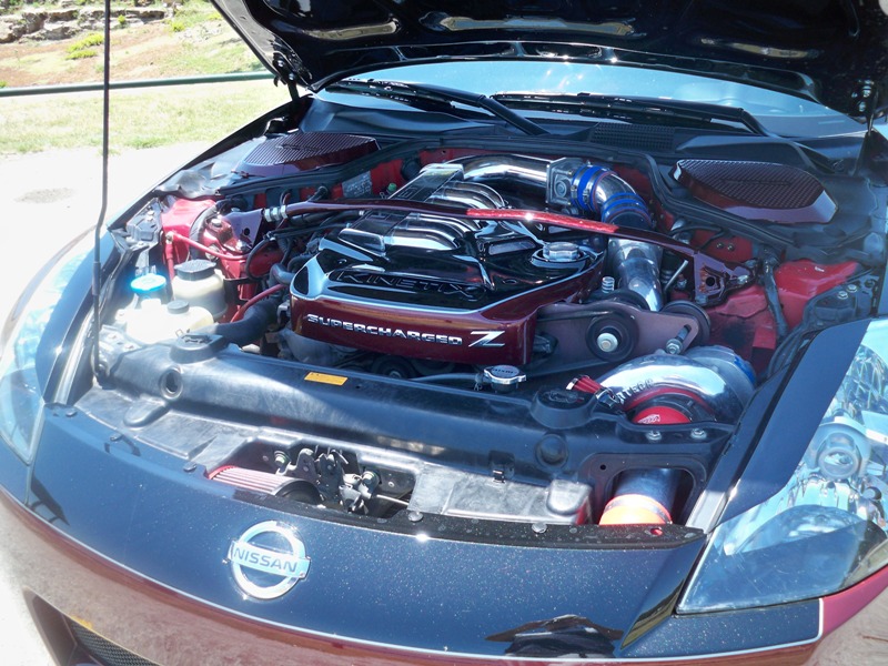

I have over 100k miles on my Vortech with the 2.87 pulley. I am on the stock clutch, never had issues with it. It's my daily driver. I am not on the track every weekend or racing every sports car on the freeway either. I get on on it like everyone with a FI engine does but I don't dog it out. Have never had any issues with the Vortech SC. I had to replace the blow off valve 2 yrs ago and 2 belts in the 7 years the car has been supercharged. If you burn out the clutch because you are granny shifting or not hitting your gears right, change it then.
