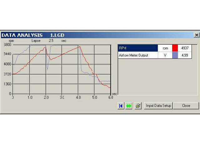

I attached a screen shot of the MAF input log/RPM from the E-Manage on my Z. It does show the airflow being maxed at 4937 on mine. Unless the MAF output voltage actually goes above 5.00v and the E-Manage somehow inhibits this I believe he might be right. I just assumed that the increasing fuel pressure from the DFMU was the only reason the car runs properly past this RPM. Should it not run right? I really dont know what else this implies? If this is correct the 350Z does not have any safeguards in place for bizare occurances in the MAF reading. Thank god. The Z is a big enough pain in the *** to tune as it is. I have many logged runs that show this very same issue. Car runs great, needs a little more fuel around redline still. Aint it interesting that my car maxes out at 300+ RPM lower than Gary's? Could also indicate part of the complex "why Swinke's Z needs more fuel than everybody elses to run happy" question. HMMM?

wow.....maxxed out with no reaction from the ECM???......at least something went right on this ECM.......since there's no reaction, is there any mod even necessary then?......are you thinking about trying out the MAP add-on swinke?
