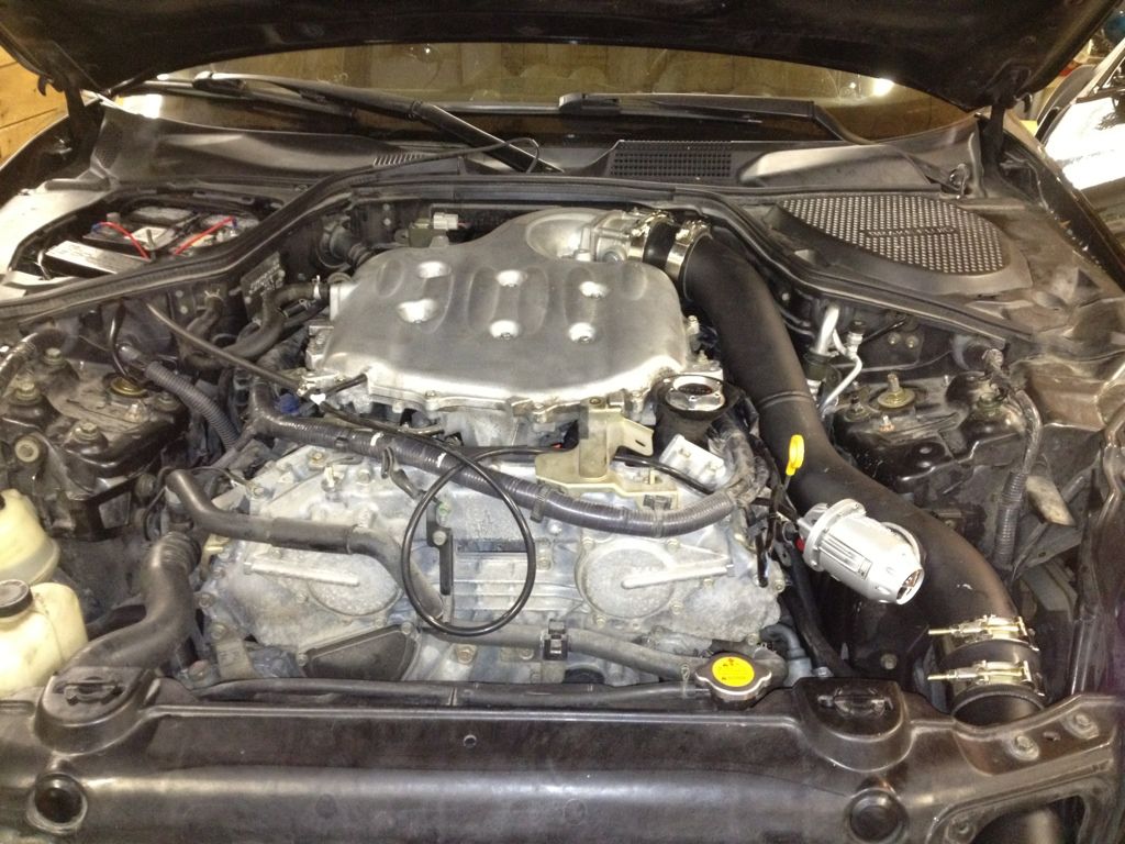

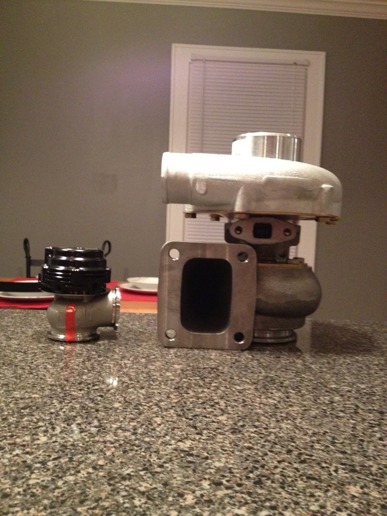

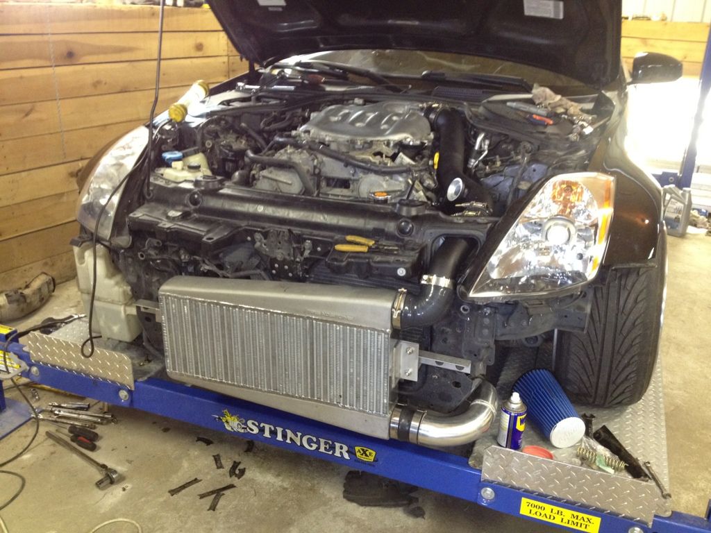

Finally pictures!

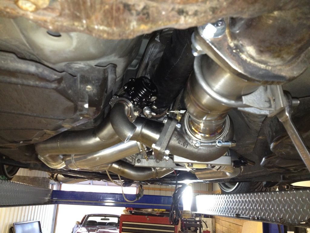

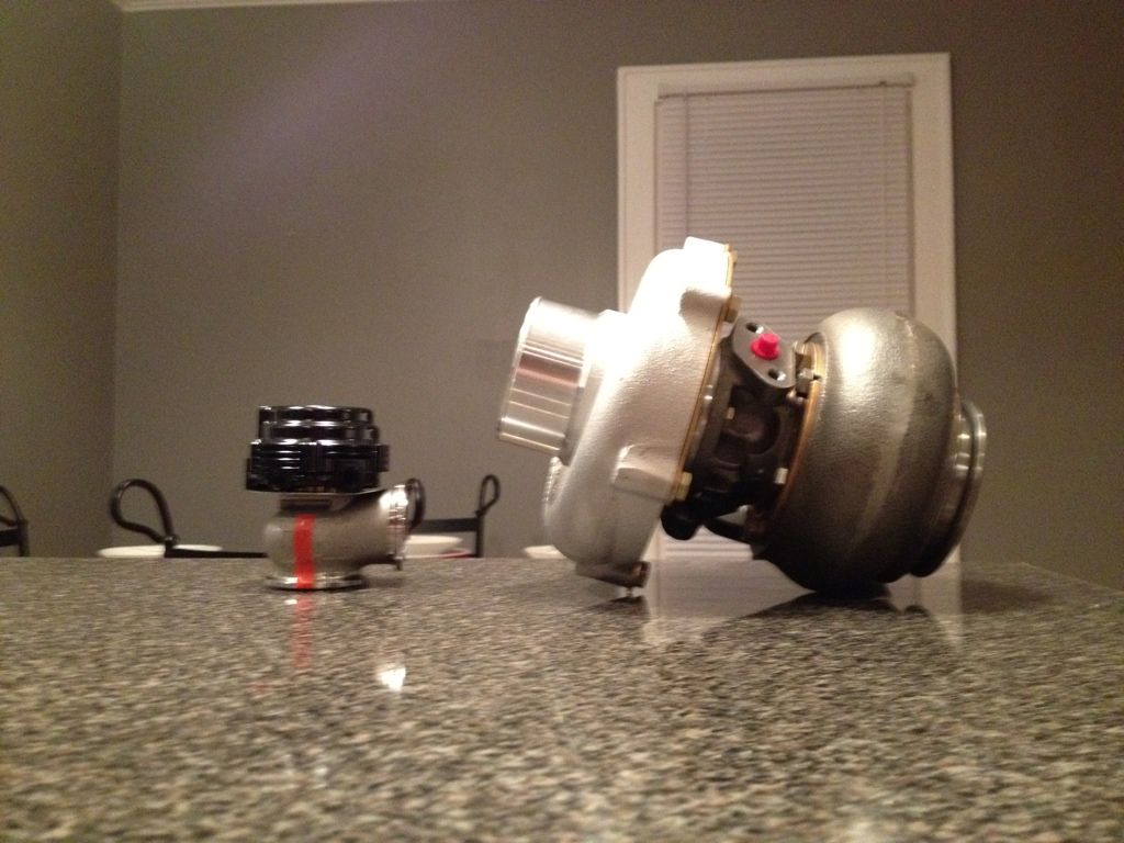

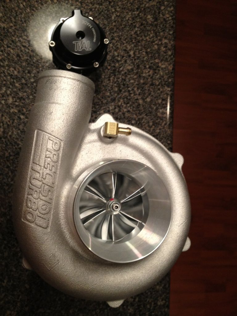

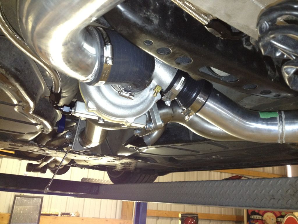

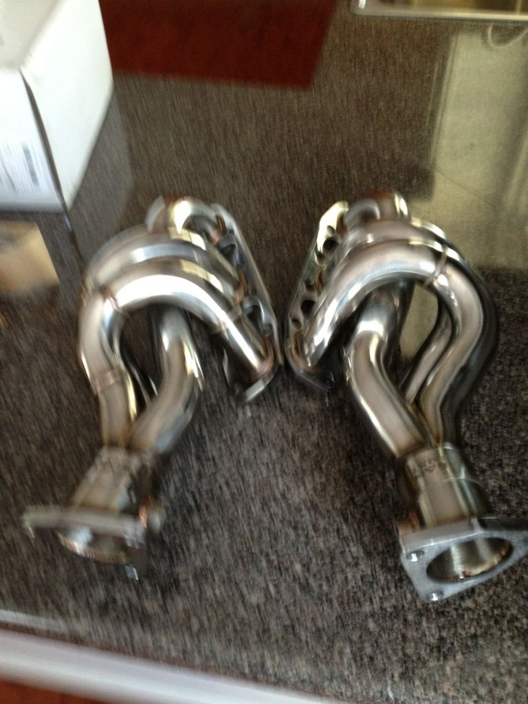

Can't wait to see what Hal can do with this 6266 T4 .81 a/r turbo. With the headers this thing should spool quick, and still have a lot left on the top. Wednesday right?

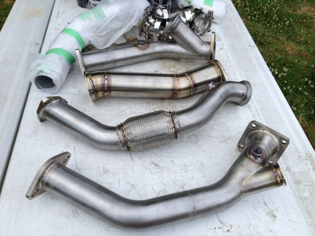

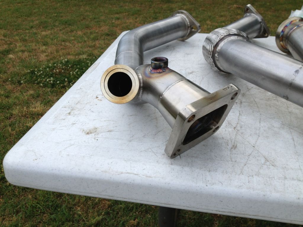

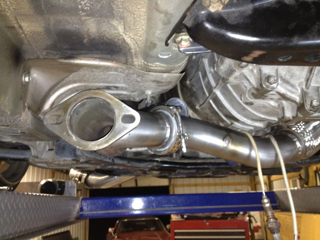

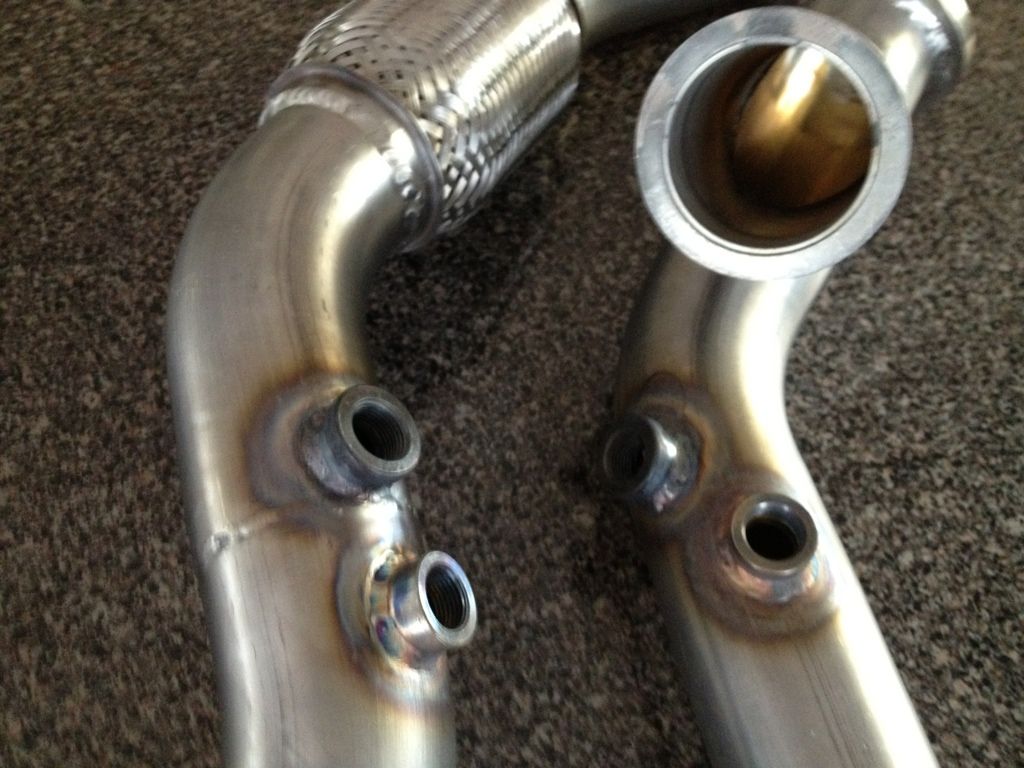

too bad it's not a built block to see what it will REALLY do.
i'm also curious what those divided housings will do. Like which size would be between .82 and .96 undivided flow.
Sasha, why did you switch the downpipe from the straight piece to a piece with pie cuts and welds? Doesn't that add more time into the build for you?
The 1.15 divided T4 would be about equal to the undivided .96 T4. The 1.32 is in a league of it's own, and a good match for a 67mm turbo when one is trying to get everything out of it (93.5lbs/min of air).
As for the down pipe, this works out well, it is a bit more work but I find that I can get more consistant results.

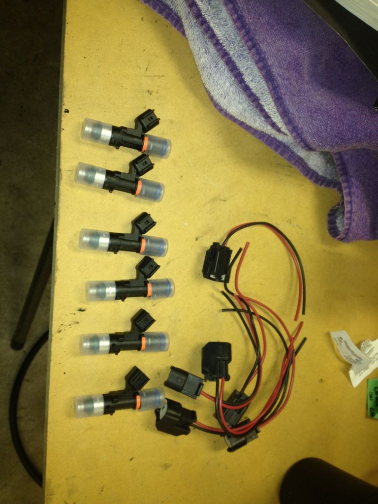

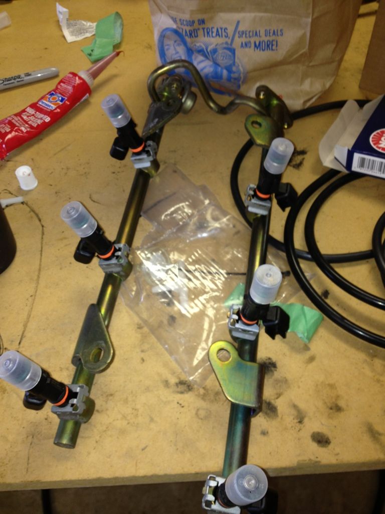

I'm throwing a random miss code it has to be fixed by tomorrow!

random miss is a fairly standard code on FI cars.
better tuning usually fixes it mostly, given proper plugs/coils, etc

You can feel/hear the miss at idle and while cruising.

Fixed! Pulled the plugs, and one of them looked brand spanking new! Wasnt getting fuel. The clip inside the Injector clip would push out every time you plugged it in. Thanks to Sasha and the guys at dynasty for putting up with my questions! Both are great! Can't wait for tune!
