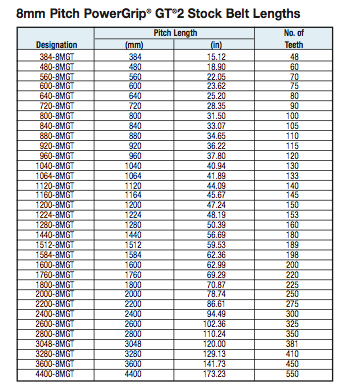

Ya, the revup is a different bracket and different center to center from blower cog to jaskshaft cog.
I'm 99.9% sure you need a Gates PowerGrip GT2 560-8MGT-20 (70 tooth)
http://www.royalsupply.com/store/pc/...005-p17521.htm
This should help you.....
And remember adjustment is very important. to tight or to loose is cause for them to snap or chip teeth.
3/8 to 1/2 play , dead cold.

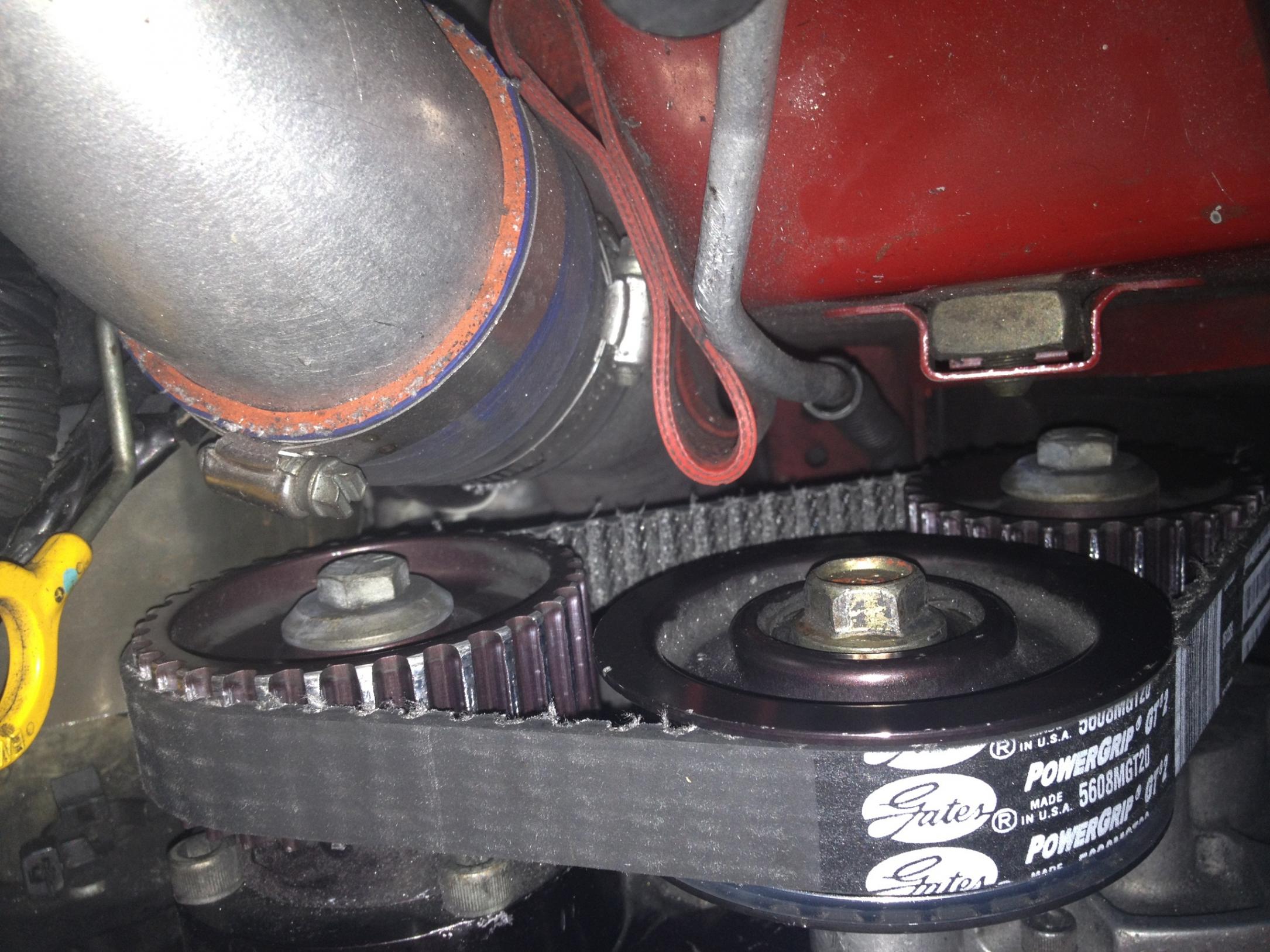

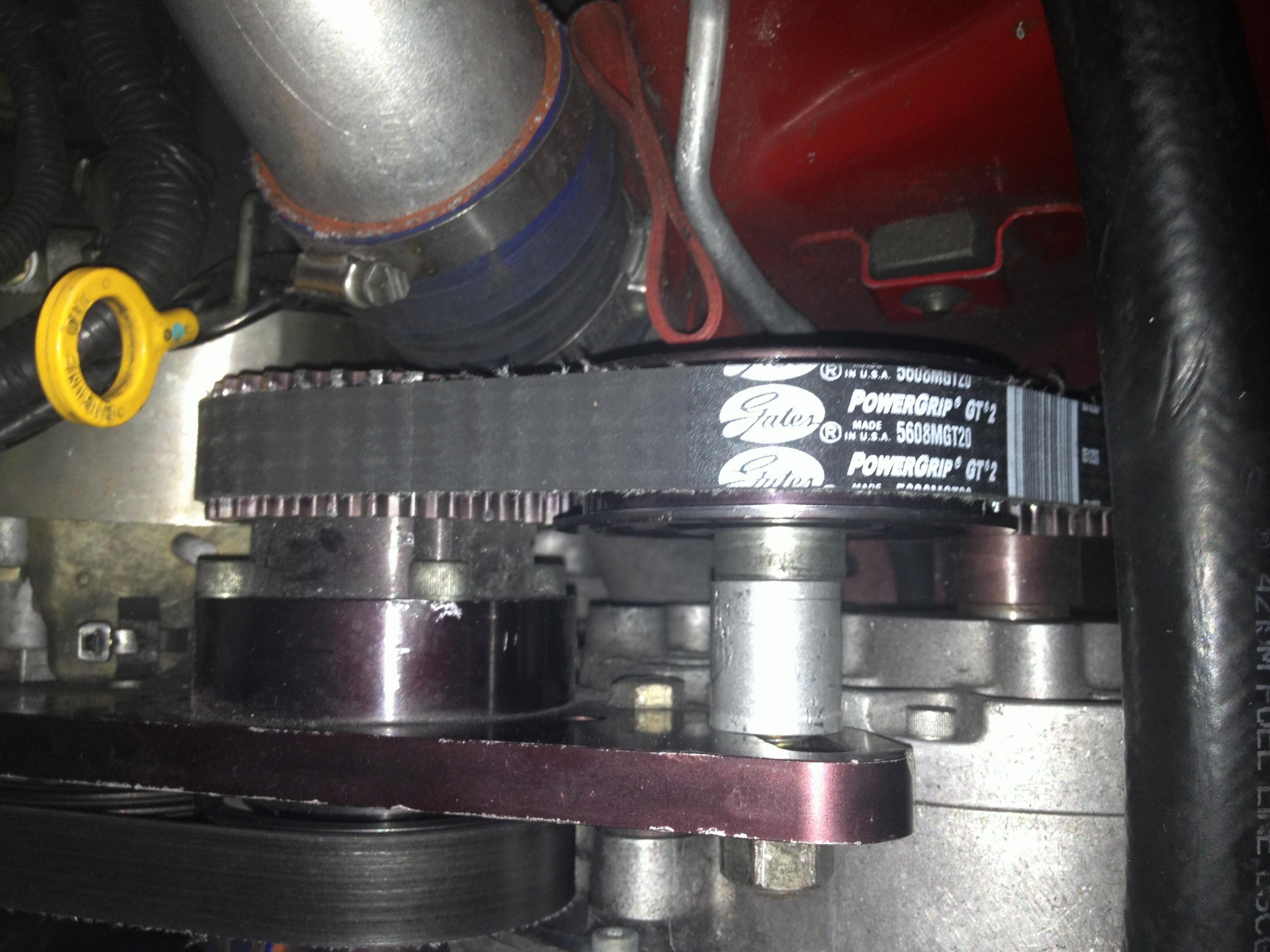

I got the 560 8GT 20 belts a few days ago. I installed one. They actually fit tight, however, they still only fit OVER the idler pulley. When I attempt to put the 560 belt below the smooth idler pulley, I can slide the adjustment all the way down until it is making contact with the S/C cog pulley, and the belt is still incredibly loose. So I am currently running it over the idler pulley for now (Like it was when I purchased the car).
Perhaps I'll get a few pics/video's and maybe someone can point out something I am missing.
Thanks
*Edit* Might be important to note, I counted the teeth, and I have a 32/28 Cog setup currently. I could have sworn Rev-Up was supposed to be a 34/32.
Perhaps thats why even the 560MM is not short enough
Attached Thumbnails Vortech - Replaced Cog Belt, Now Lower PSI-img_1652-1-.jpg   Vortech - Replaced Cog Belt, Now Lower PSI-img_1651.jpg

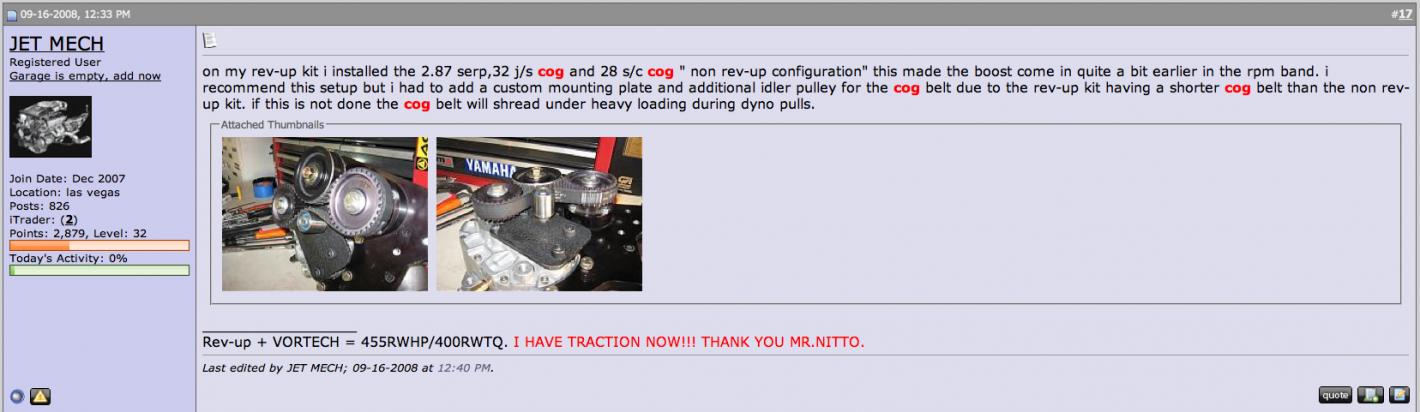

https://my350z.com/forum/forced-indu...or-pulley.html
You have a rev-up bracket with DE Cogs (32/28)
Verify Rev-up Cogs, I think 32 Jack Shaft / 30 Supercharger.
1. You can get the right cog pulleys, yours look very worn anyway, because of incorrect installation.
2. Or Do what Jet Mech did, see attached.
Attached Thumbnails Vortech - Replaced Cog Belt, Now Lower PSI-rev-up-cog.jpg
