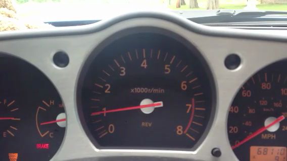

Here's a quick video I shot today. I'll have to get video under the hood whenever my friend comes over. The video doesn't quite get the sound fully over the exhaust, but you can hear the sound better right before I decel and during the beginning of decel.
http://i29.photobucket.com/albums/c2...ps33127c69.mp4

It sounds like a screeching wail, almost like a banshee for lack of a better word....
That's what it sounded like when I initially installed it, before I promptly destroyed it during my attempted tune....but it has an aftermarket impeller and new bearings now after the rebuild, and I never ran after I got it back, so I have no idea what it sounds like with all the new hardware in there...
Also, when I installed it in my car it didn't touch/rub or anything even thought it was a tight fit, but that being said I have revup kit so it mounts differently...
