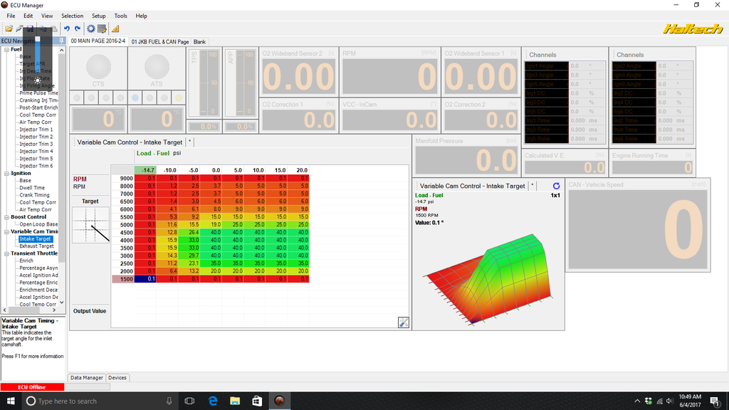

Went to a little show about 60 miles away - the car did well ... I had a few 65mph to 120mph pulls at high RPM/high load to check afr and look at my knock-signal (not that I know how I can tune ignition off it??).
I opened my variable timing control table (within the haltech) and changed any '0' values (which occurred at high & low RPMs through the entire engine load spectrum and at -14in*hg of vac) and changed them to '0.1' ...
I also added a digital gauge on my control screen for the output of the variable timing control and my output was reading a value as I would expect it.
Attachment 382194
