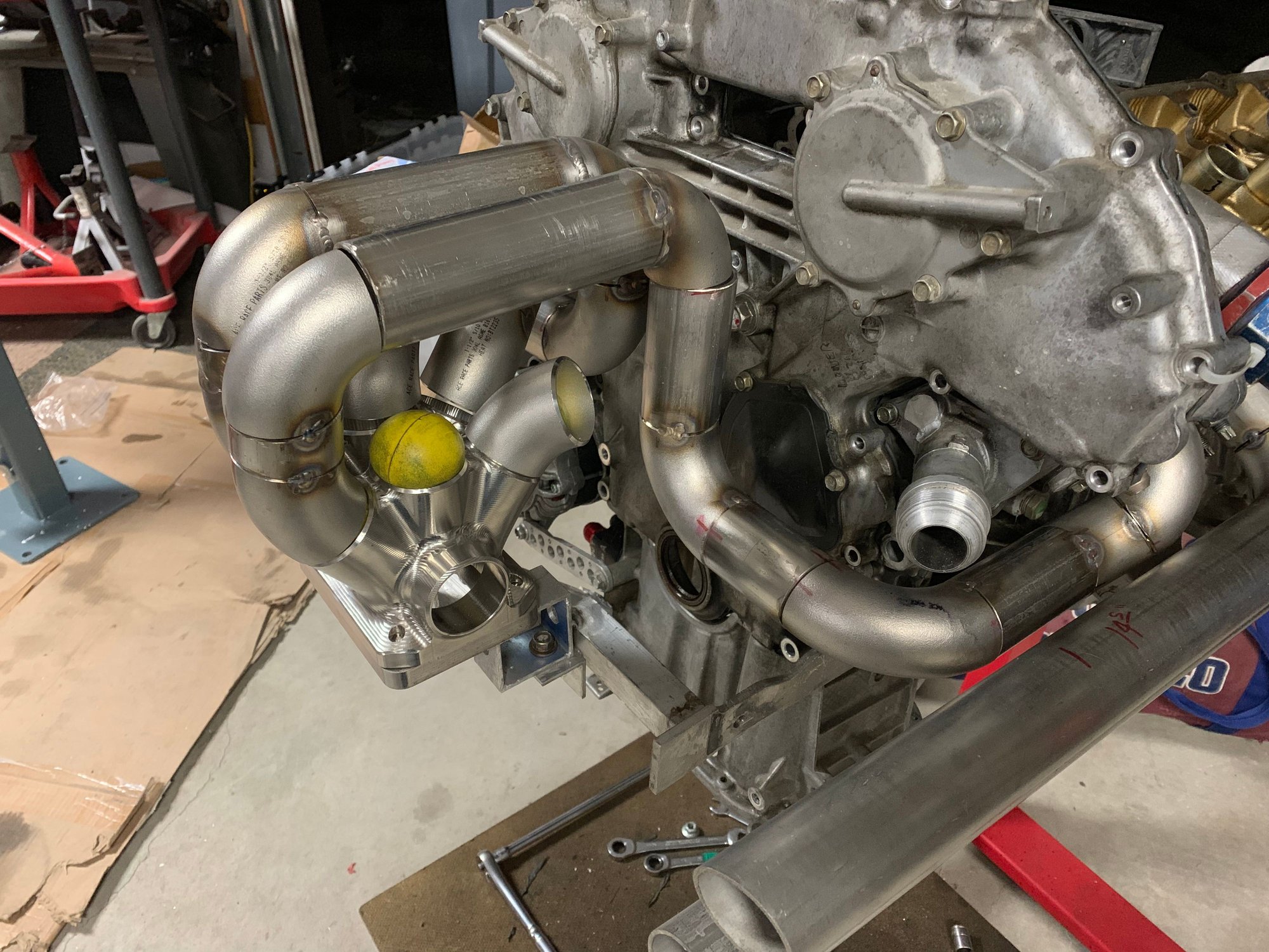

A few extra hours tonight and made it this far tonight...
Conflict #1 - The setup is sitting about 1/2" too close to the engine. I will need to push the assembly 1/2" to 1" forward to allow the serp belt to connect to the crank and alt pulley.
Option #1 - splice in flex sections - I wanted to do this anyways but might not a wise move - (Open to opinions on flex bellows preturbo - see pros & cons below)
Pros - offers heat expansion/wont crack welds, will easily extend the 1/2" I need to push forward, will offer some fitment tolerance
Cons - could leak at higher psi
Option #2 - I still want to install V-bands on each runner - I can add a 1" stub to each runner at this time
Option #3 - no flex pipe and re-size/extend each longitudinal runner (coming off the flange) by an inch. Additional pipe wouldn't be an issue.
Conflict #2 - passenger side waste gate may not clear the cold side housing. The WG may have to be angled or extended.

What are your plans for the radiator? Looks like there won't be much room up front.

I should have room - I'm not running OEM fans, AC is deleted, and my (aftermarket) radiator sits further up than the OEM location - sits about an inch forward of the main crash rails. I measured a few times and I think I should have 1" +/- on each side of the turbo.

Looks like you could also can't the turbo flange to pivot the housing forward instead of shifting it. Might be more work though.

yea - I see what you're saying - would be more fab time but I'll keep that idea in my back pocket.
I didn't realise you had a different than stock style cooling set up. I have less than 1" clearance between my pulleys and fan shroud with the CSF rad.

I have about 11" from the front of the crank pulley to back of the radiator and the widest part of the turbo (which is also about how I want it to sit when it's in place) is ~9". This doesnt factor in my single 16" fan. Which I may have to down size and/or add more than one fan. Also I can push the radiator out a bit. Worst worst worst case, I'll find a slimer radiator.

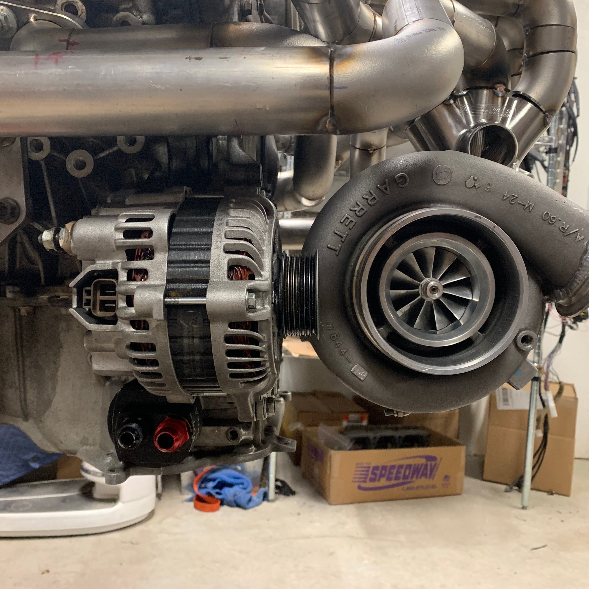

What size Waste Gates are you tying to run?
What is the shallowest angle you can use to get over the cold side piping? To steep of an angle may diminish the flow to the waste gate not allowing it to bleed off enough exhaust. I doub't you will have a problem since it's a twin scroll just food for thought.
I assume you're going to wrap the pipe to help keep the housing cool?
Also what's the plans for the waste gate dumps?

The ID of the collector-ports is 1.7" ... so ideally a 44mm? I wish wastegates werent so expensive bc I'd run 6 off them - one off each runner.
I might be able to install the WG stub right off the collector and run it perpendicular and still clear the cold-side housing if I angle it right. I hear your concern though.
Im likely going to ceramic coat - got a quote for $250 from a shop here locally - but yea, something to keep engine bay temps down.
not sure on the dumps ... either to atmosphere or into the exhaust line. I'd like to run them straight up into the hood but you run the risk of stuff dropping into the blower/WGs ... so maybe a side exit for track-days?

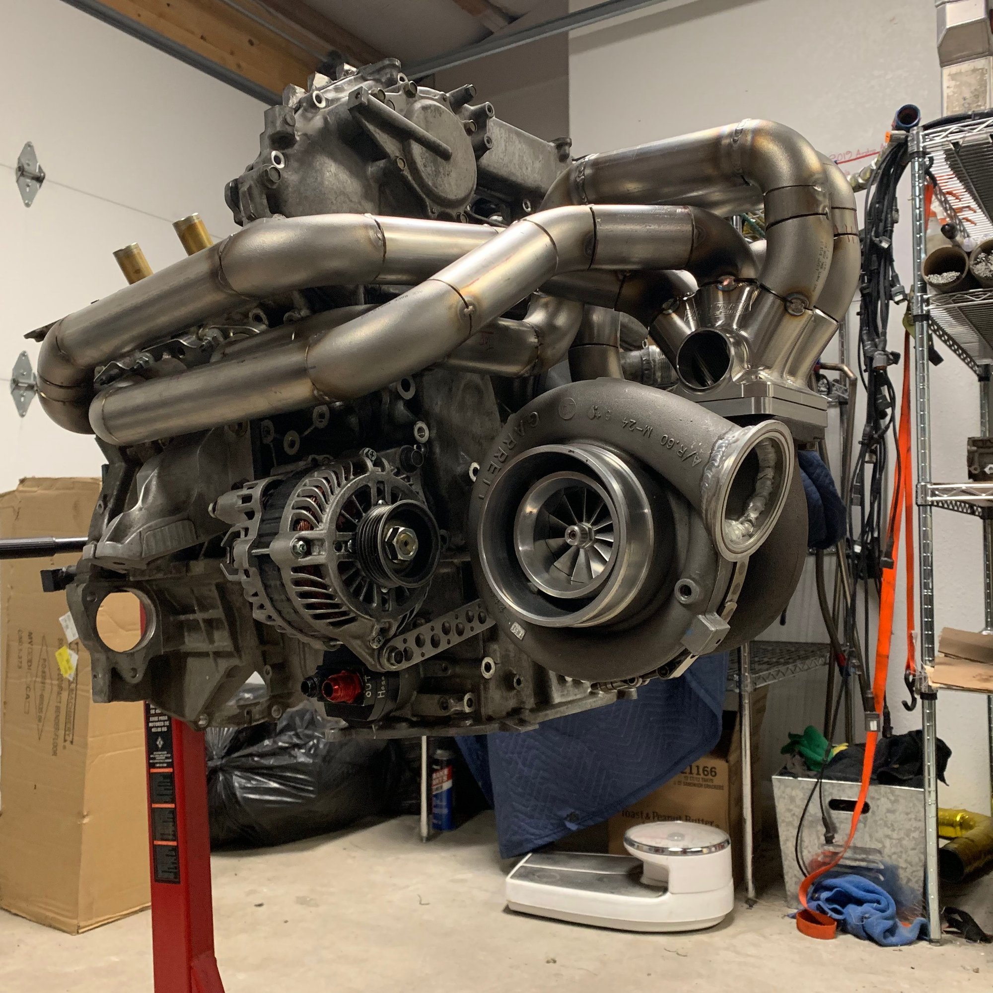

Got real with the headers/turbo setup. Im a solid inch too close to the block. Im a proponent of flex couplers/bellows to allow for heat expansion but I am not 100% sold on these particular bellows - I have a feeling despite everything being supported they may leak. Regardless - I got each runner cut so I can splice in a flex section. One side of the flex is tacked and the other side is free (where I can slide the entire assembly front to back right where I need it and I can weld it in place.
Before I can make my final welds I will need to do final connections between the collector and each runner. I established an order of runner welding so I dont box myself into a corner - I hope I'm right! From there my thought is to mount the blower to the front of the block by the three 17mm bolts.
