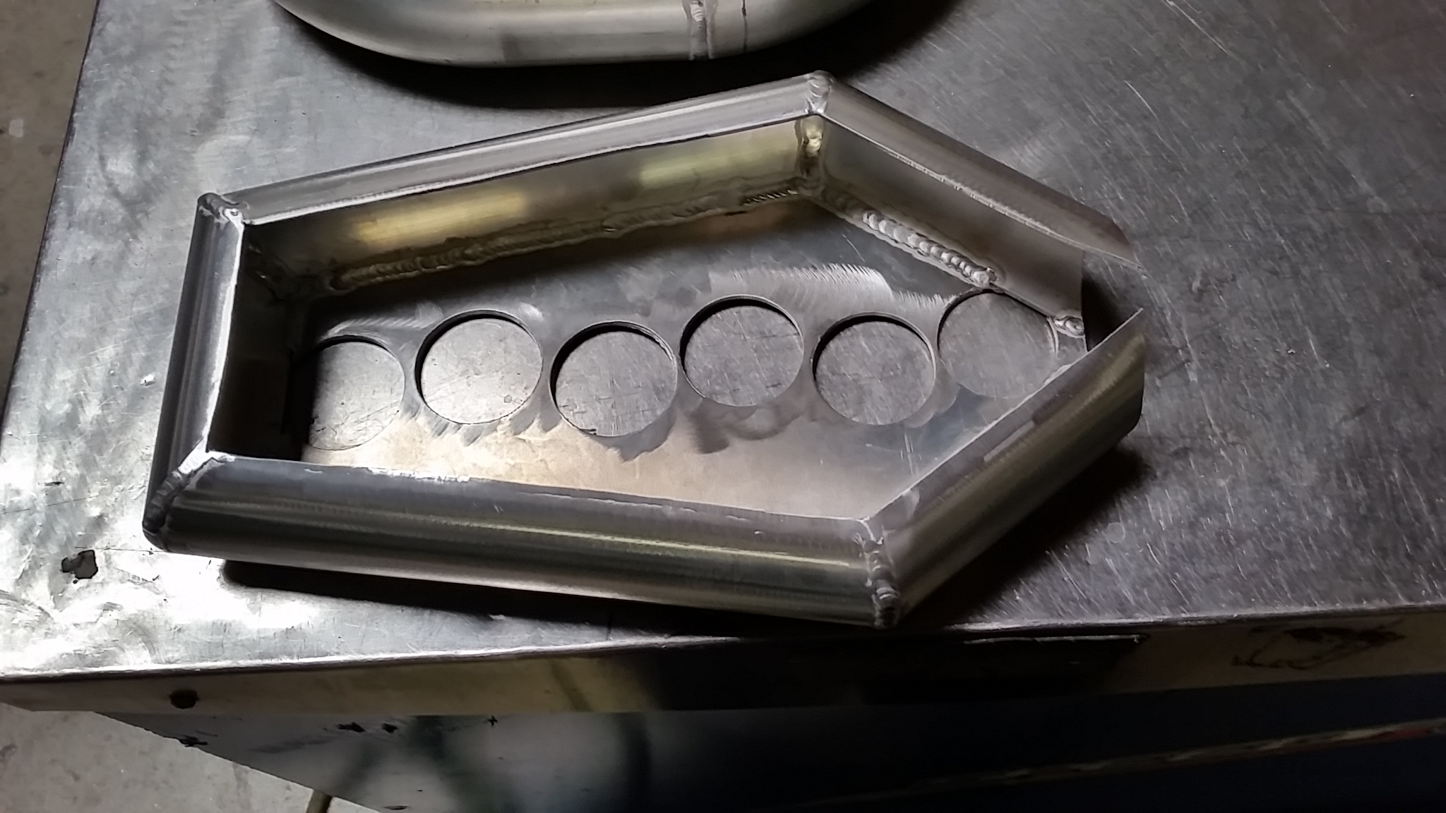

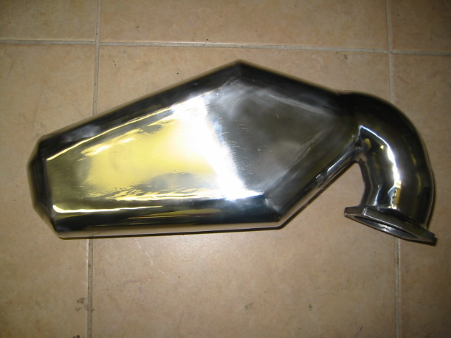

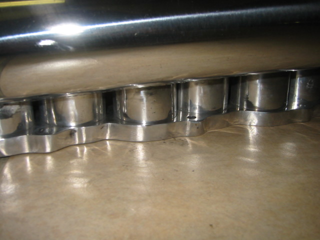

LOL... nothing would surprise ne anymore! just a good reason to go ahead with TH400...
intake being built.
Attached Thumbnails Sfr takeover-intake-manifold-inside.jpg   Sfr takeover-intake-manif8ld-outside-top.jpg   Sfr takeover-sfr-intake-manifold-short-runners.jpg   Sfr takeover-sfr-intake-manifold-python-head.jpg

  #195
RudeG_v2.0's Avatar
RudeG_v2.0
でたらめ検出器
Posts: 5,800
From: Phoenix, AZ
^ It appears you didn't reasearch before pulling the trigger on that intake. This was SFR's first intake version before they offered the twin plenum version. Its design has already been proven to be very poor and completely worthless (no better than the Kinetix you already have). It's runner design is nothing like CJM's intake. You will see no gains except in Tim's wallet. How much is Tim charging you for that POS?
You would be better off with just a polished OEM plenum and a spacer. If you want some bling, get a polished Cosworth plenum.
You've ranted and complained plenty about Sam and being *** raped by GTM, but then I see this horse$h!t... It's like deja vu all over again. Seriously dude... Pull off your rose tinted glasses about Tim and get your car the hell out of there before you waste any more money on snake oil, empty promises, and excuses. If you need any more proof, look at how Tim claims on his website that their built 5AT will hold 750whp! He told me the same BS on the phone years ago even though he has yet to prove to the community that he has even successfully built a 750whp VQ, let alone one with a 5AT. LOL

Old Apr 25, 2014 | 09:58 AM
  #196
str8dum1's Avatar
str8dum1
Joined: Oct 2007
Posts: 8,807
From: raleigh-wood NC
coffin intakes can make really big power. Eric, how do you know there are not velocity stacks inside that thing? What else makes you conclude its ****? curious?
I wanna get one kinda like that with a big inlet for a LS dbw throttle body.
Old Apr 25, 2014 | 10:17 AM
  #197
RudeG_v2.0's Avatar
RudeG_v2.0
でたらめ検出器
Posts: 5,800
From: Phoenix, AZ
Of course they can. CJM's version 1 intake is a perfect example. I remember some old posts and pics about this SFR intake manifold. NA results were similar to my experience and others with the Kinetix; a loss in power or no gains. It did not have smooth velocity stacks like CJM's. The inside was more like the Kinetix as I recall. Look how shallow/thin and flat that plenum is. It doesn't look like there is enough height/depth to accommodate decent velocity stacks. I remember seeing it on his website before he came out with his twin plenum design. But I don't see it on his website anymore.
Does that thing honestly look like it will deliver balanced air flow to all 6 cylinders?

Old Apr 25, 2014 | 09:52 PM
  #199
RudeG_v2.0's Avatar
RudeG_v2.0
でたらめ検出器
Posts: 5,800
From: Phoenix, AZ
^ True. But that coffin manifold looks like crap IMO. Here is a better pic of the intake runners from the bottom...
The CJM version 1 was a superior coffin style intake design. Look at the difference in the placement and orientation of the runners...
One of the big reasons the polished OEM+spacer and the Cosworth are so commonplace is because they work and are proven. If OP wants something different and more rare, the CJM intake manifold is a good option. I don't know if Charles will still make the coffin version though. I like the front throttle body location and larger plenum of the newer version, but that might be more difficult for OP to route to his horizontal flow GTM intercooler.
