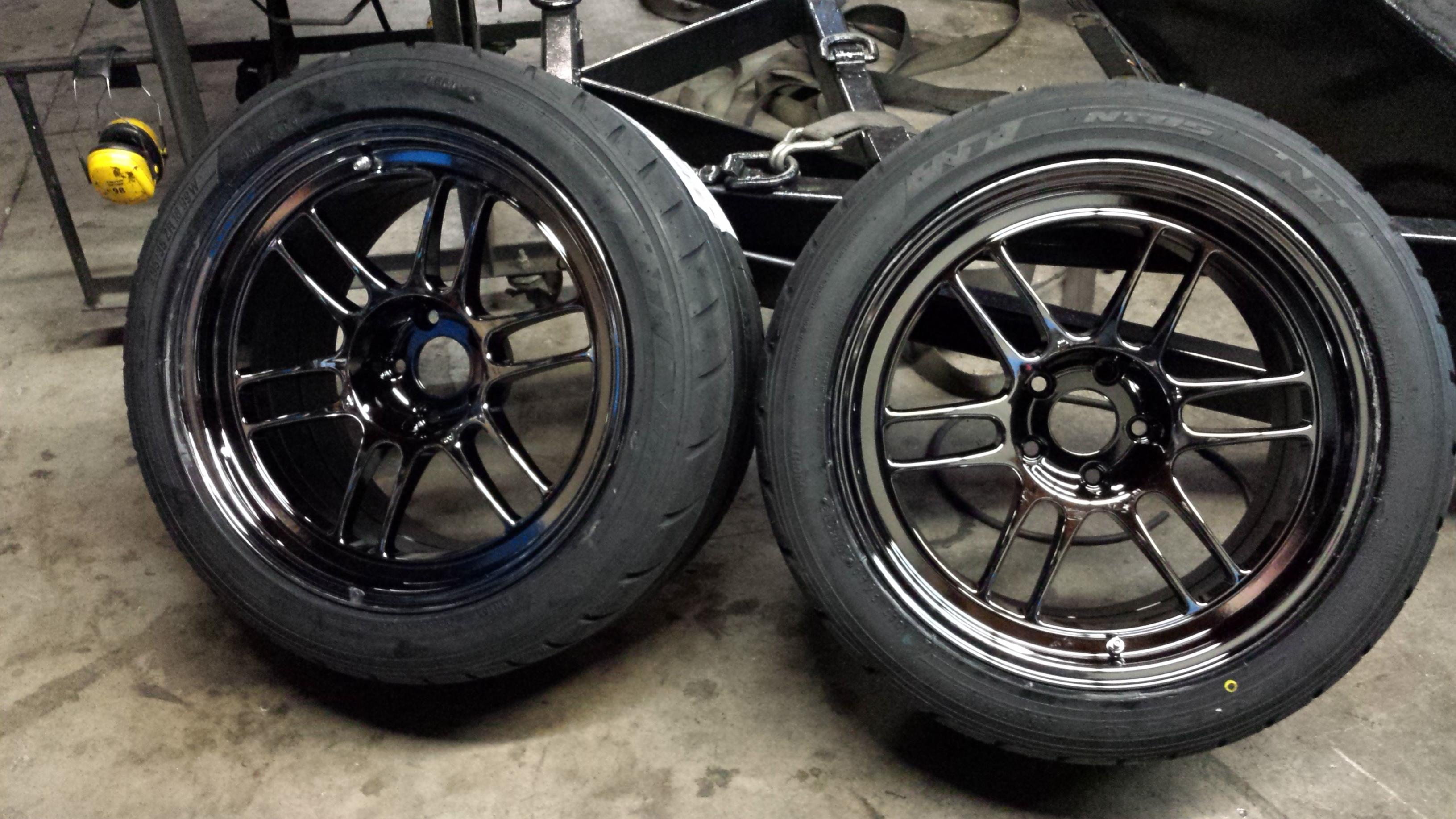

Tks J!...here are my new enkei SBC's with nitto nt05's....

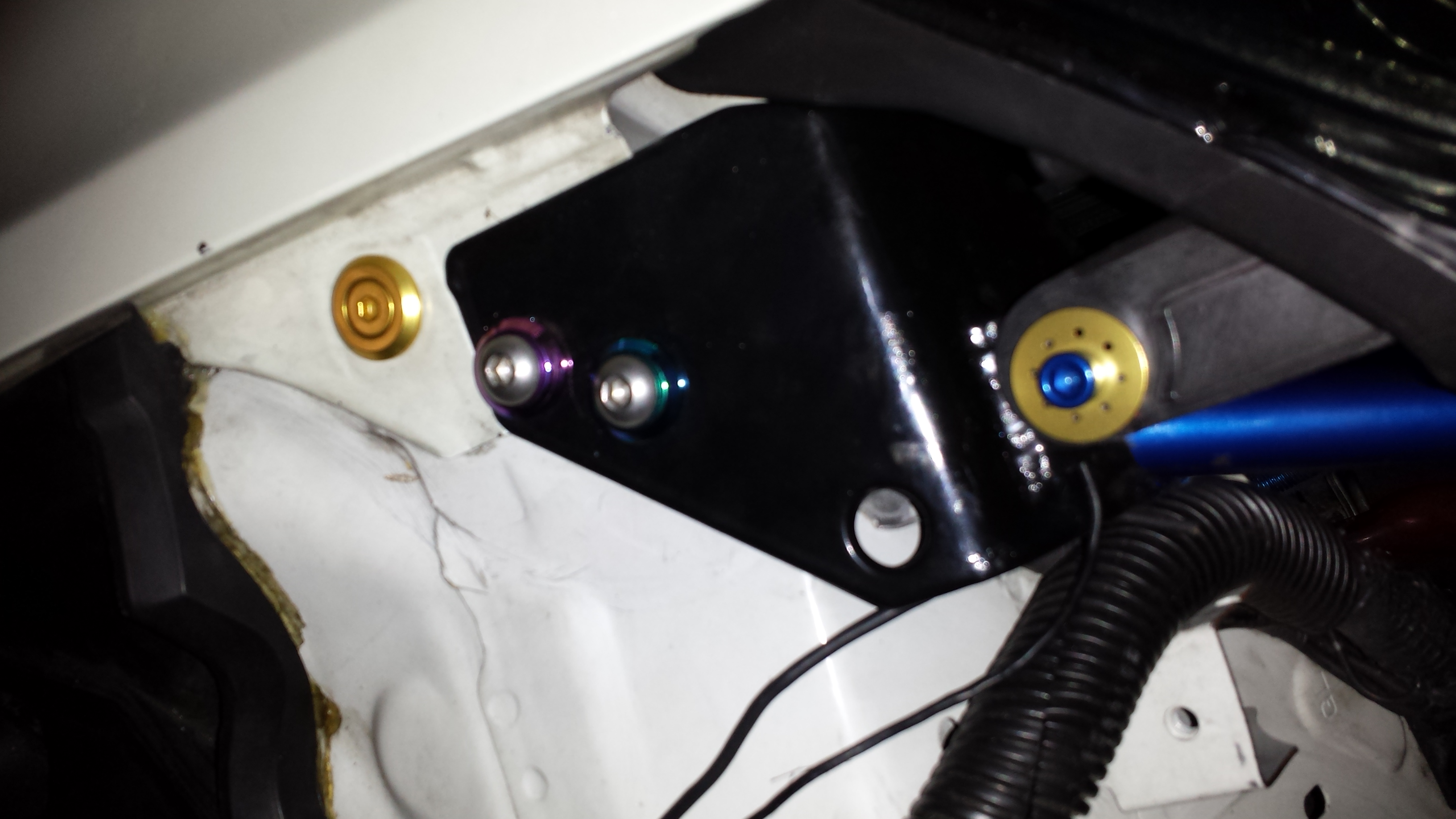

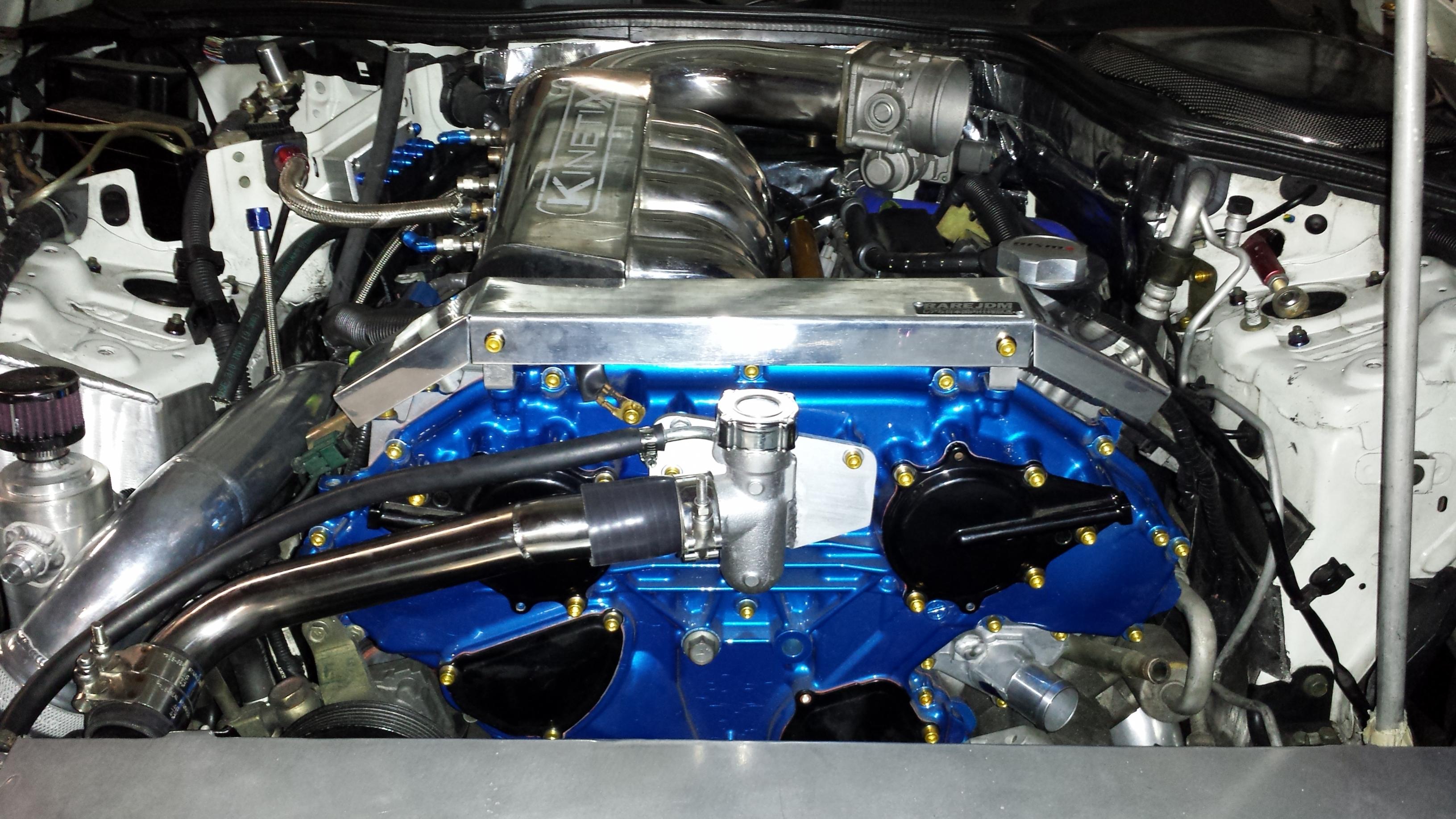

the latest pics...

Can you explain what is going on with the radiator hardline to the center of the motor?

It looks like he used the HR cooling pipes.

Sure, midz is correct...I used a custom made HR cooling setup (after GTM REFUSED to return the one they built), by SFR....decided I wanted the "hardpipe look", so Tim fabbed one up for me...lower is a hybrid of silicone and SS pipe (not shown).
I wanted to provide better cooling for the heads and get rid of all the extra crap on the passenger side of the engine...plus the HR style is easier to burp the air from the system...
Glad you like the build..I will have the car returned in Feb. as I will be going to SA for 2 weeks and want the car before I leave...

I see the Kinetix back on there- it just a placeholder for the custom plenum that Tim was fabbing up?
I haven't read anything good about the K plenum... not with FI (not with NA either actually) except that it looks "neat."

Yea, K is there for the time being..good for low boost break in anyway...Since I can't seem to get the GM tranny in at this time, I will keep it low boost until 5aT and/or K manifold craps out...

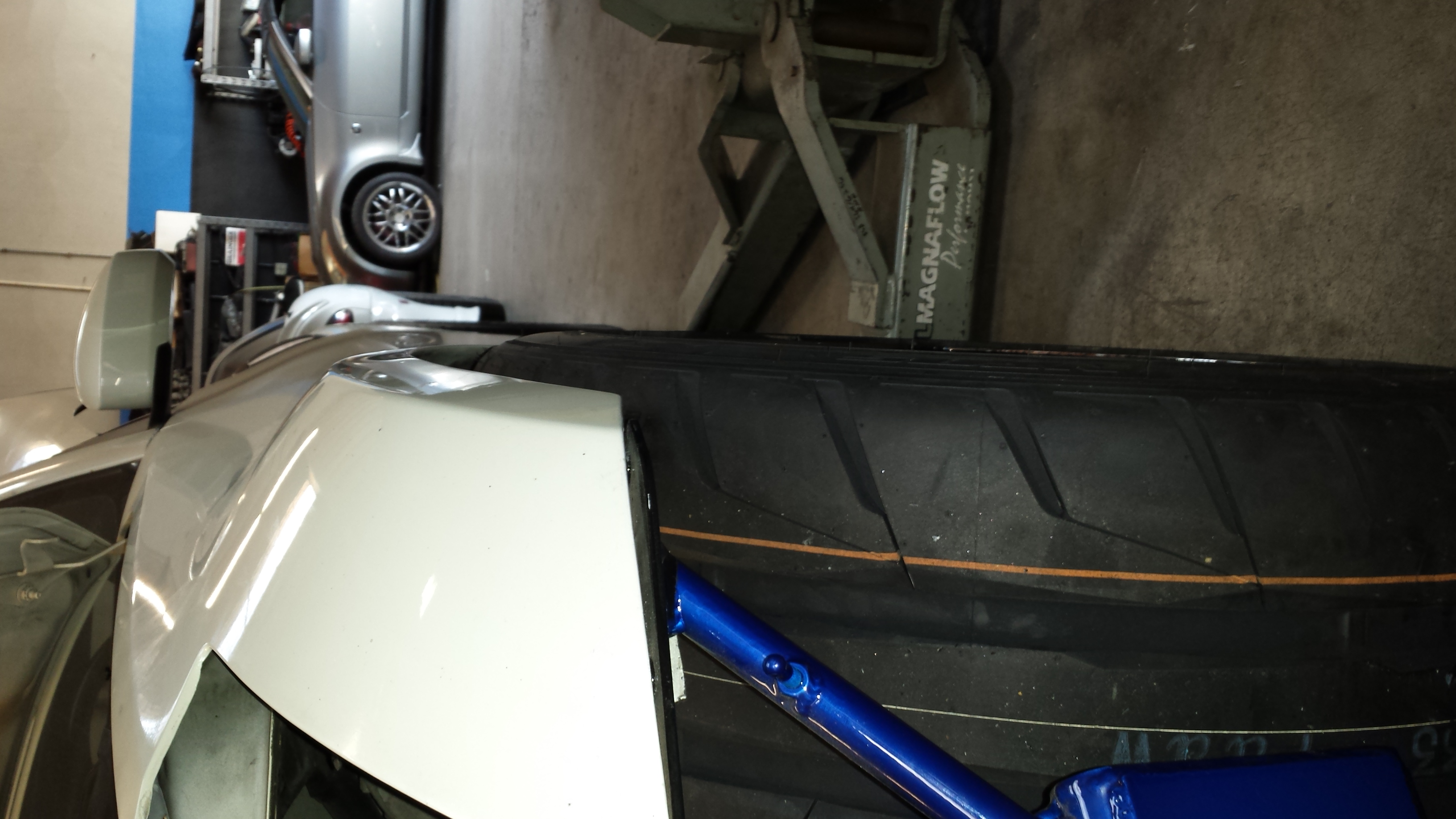

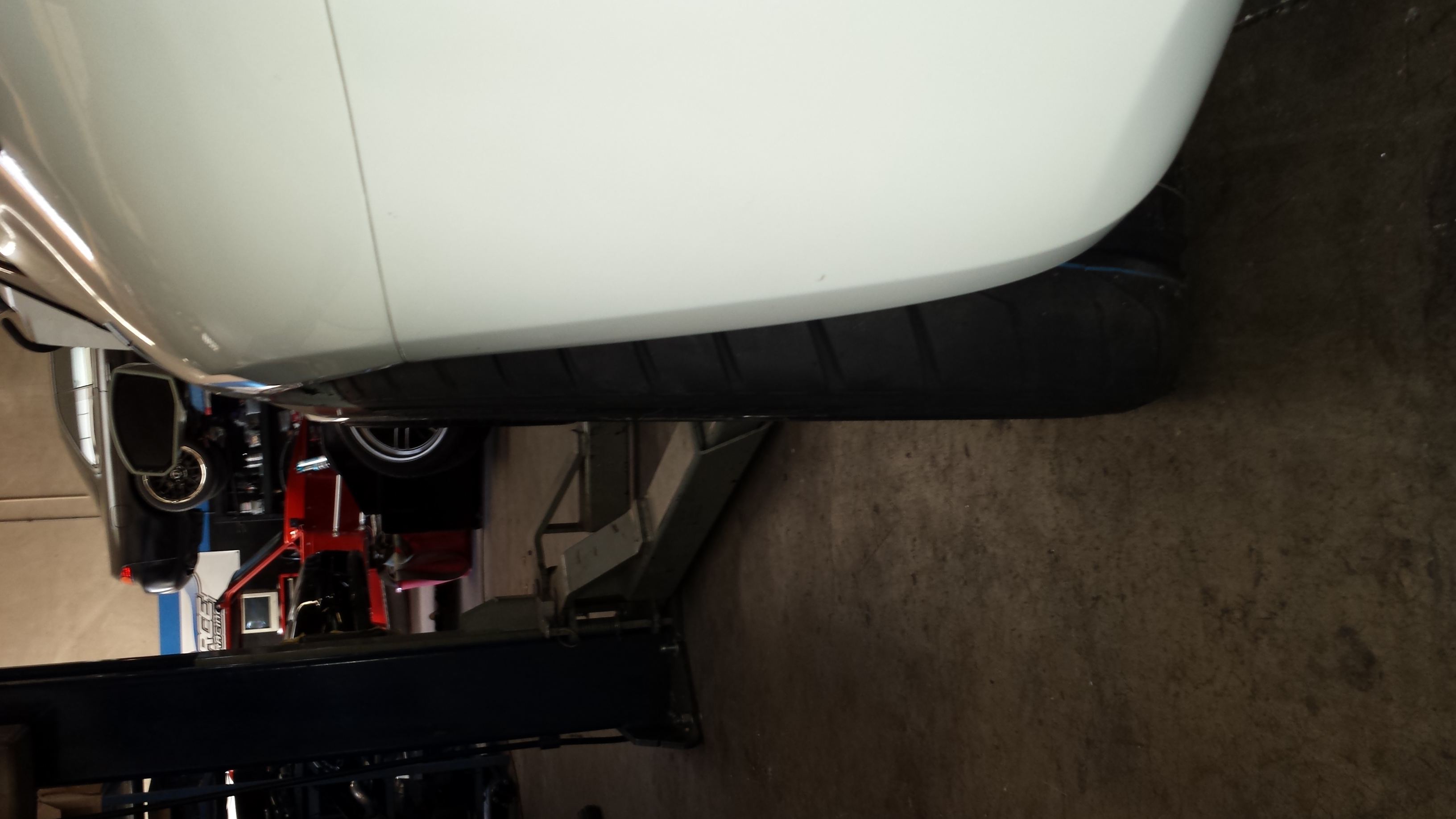

9.5-10.5 +15 X 18 and Nitto 05's 275/35 295/35...anyone see anything horribly wrong with fitment? Doesn't look too bad from what I see (rubbing wise).

Rear looks manageable with a roll and pull but the front might be tricky without some neg. camber. I say go widebody.

I'm looking at that picture of the front tire, all I see is my car sitting in the same spot it has been in for a year.
