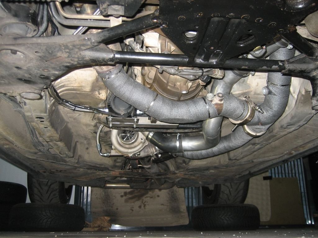

Pre turbo pipes wrapped with DEI:
Oil cooler relocated to driver side, custom bracket, hard lines above IC to help with heat dissipation:

Just fyi, spacers are readily available so you didn't have to grind down the manifold (would've just raised the manifold 1/4 inch). Good work though on the DIY. If you use -10 lines I don't think the oil cooling will be an issue either btw.
I wish I had the Fab skills to do something like this with my long tube headers.
