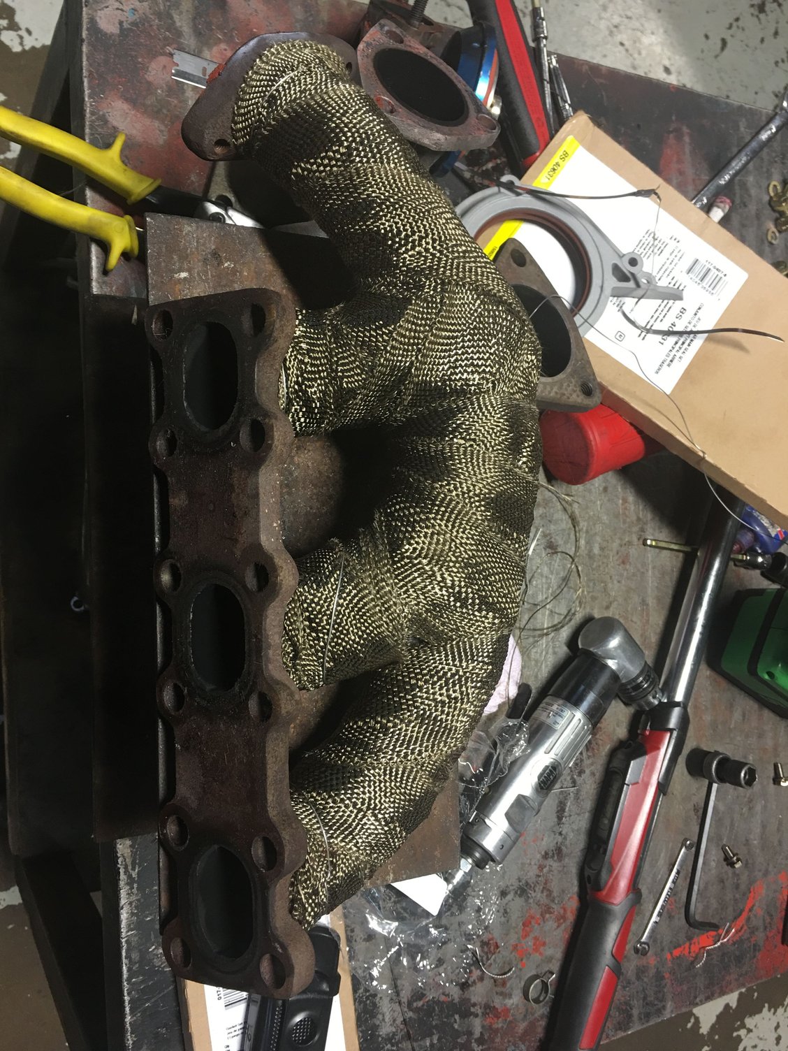

Heat wrap on the manifold!

I missed a small spot in wrapping but it's my first time. I moved the turbo blanket and it covers it.
Other side looks much better!!

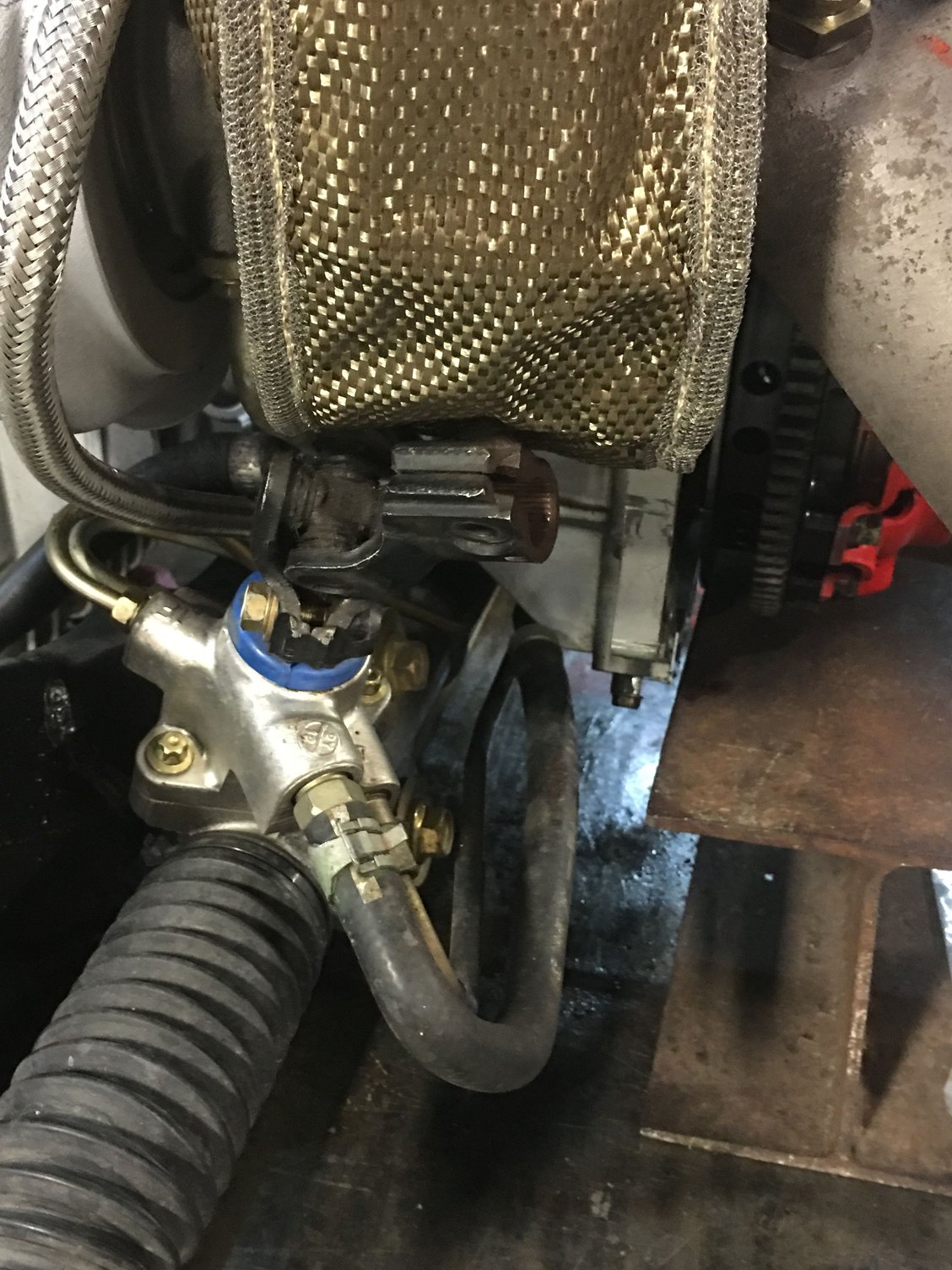

They didn't get the power steering line to us . So I have to wait to put the motor in since thanksgiving is tomorrow. I'll end up back at work so I won't be here for the rest of the work. . Only clearance issues I can see is the steering side turbo blanket rubs... But we let it rest in the engine bay, no problem clearing side walls! Atleast that we can see
The rub will happen, but it should be ok.

sorry to hear about the PS line.
nice. would you say the blanket is a bit big for the turbo?
I mean honestly, on the side without the steering joint portion it fits perfectly. Wraps all the way around and holds nicely fully closes. On the other side it's a little loose because getting it on there and secured was like impossible! So it's a little loser but not bad!
