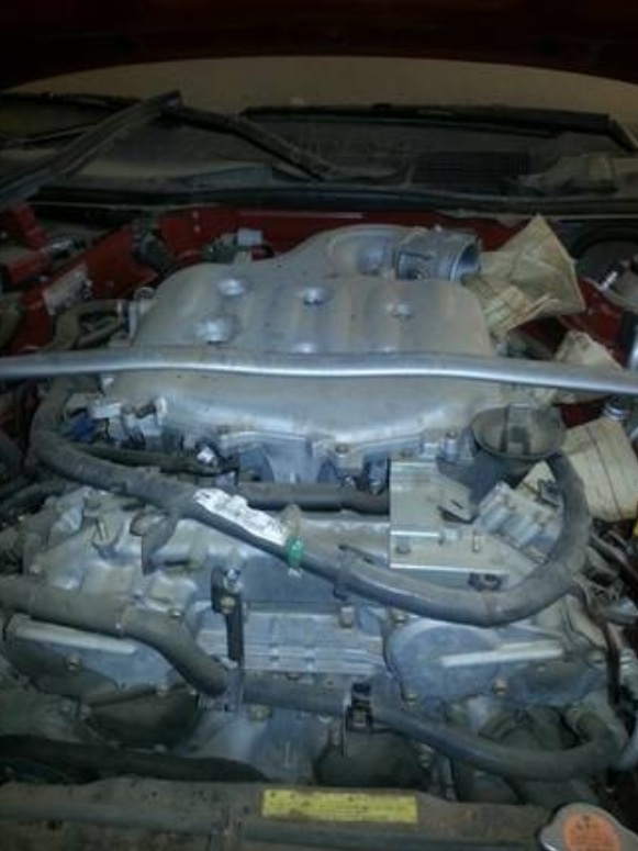

I posted in the new member area, but wanted to share I'm going down the long road of F/I modded Z. Now I know a post is nothing with out pictures and will update as soon as I get my car back from the shop. I bought an 03 350z with a blown motor and supercharger kit as well as an 05 parts 350z from the same person. I literally haven't seen the 350z since I purchased it back in October 2013. I work in Oklahoma and have my car at NTX Speed and machine in Dallas tx. So the long list of mods that I am attempting is as follows. Ditch the supercharger kit for Greddy twin turbos, and intercooler. Next I'm rebuilding the whole motor basically everything but the crank. The block will be sleeved with LA sleeves. H beam rods, JE pistons, performance bearings, arp head studs, Comtechi head gasket, complete valve job, and 750cc injectors. I'm actually not sure about cams and if I'm spending the money for little cost efficiency. Would appreciate y'all's input on the cams.
I will also add an Uprev emanage system, turbo timer, boost controller, aluminum radiator, J&S safeguard and Greddy oil cooler as well as the necessary gauges. Because there is no emission standard in Ok I will delete the cats and add RSR exhaust. I am driving a manual 6sp so it will get a Cyn R Gy stage 3 clutch and lighter flywheel. I may have forgotten something that I have and haven't mentioned but will update if I did. Now like I said I'm new to the forum and wasn't planning on joining one but I find my self on here reading y'all's builds and details so I figured I would join. (Started feeling at home) That's why there is a serious lack of photos, and I'm unable to take them when I'm in a different state. But I'll make it up to you guys and take as many as possible when the car is complete in the next 1-2 weeks or atleast that's what I was told. If you guys happen to see something you think I'm missing let me know. My HP/trq goal is not 750+ or even 1000+ I'm shooting for reliability and around 500whp. The car is not going to be daily driven, more of just a fun car for weekends and shows. With all that said, I'm excited to get to meet some of you guys at some car events. If you happen to live in the Dallas, tx area or the Oklahoma City area let me know so we could meet sometime.
~Chris
(I tried attaching 2 pics of my car and the parts car as well hope they worked)
