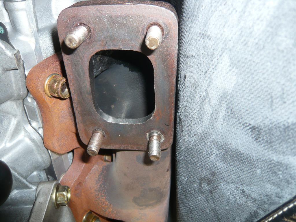

I'm kinda new working this deep in to a car project. Yesterday I removed the right turbocharger to do some clocking. While off I thought I'd clean up the stud threads (M8 - 1.25).
As you can see one stud backed all the way out and obviously at another time some one had trouble and installed a Helicoil.
I have never worked with these. Is this an easy fix?

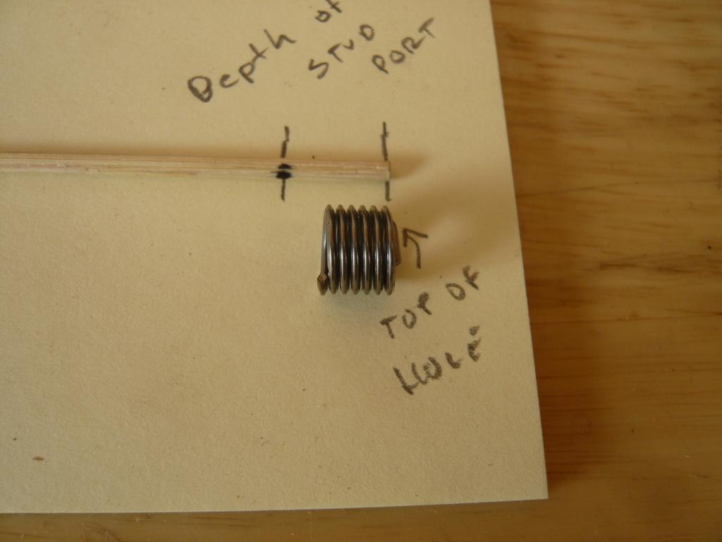

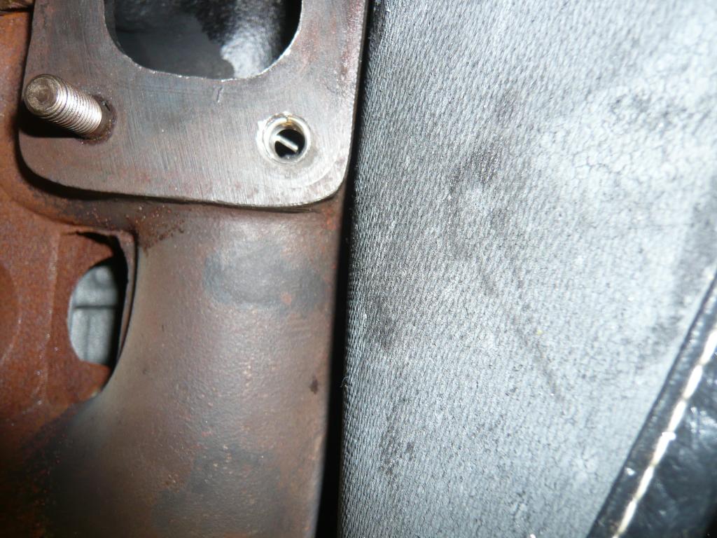

Bought the kit off Amazon ~ $20. Pretty straight forward. I did have to shorten the coil a little and breaking off the tang was a little challenging.
