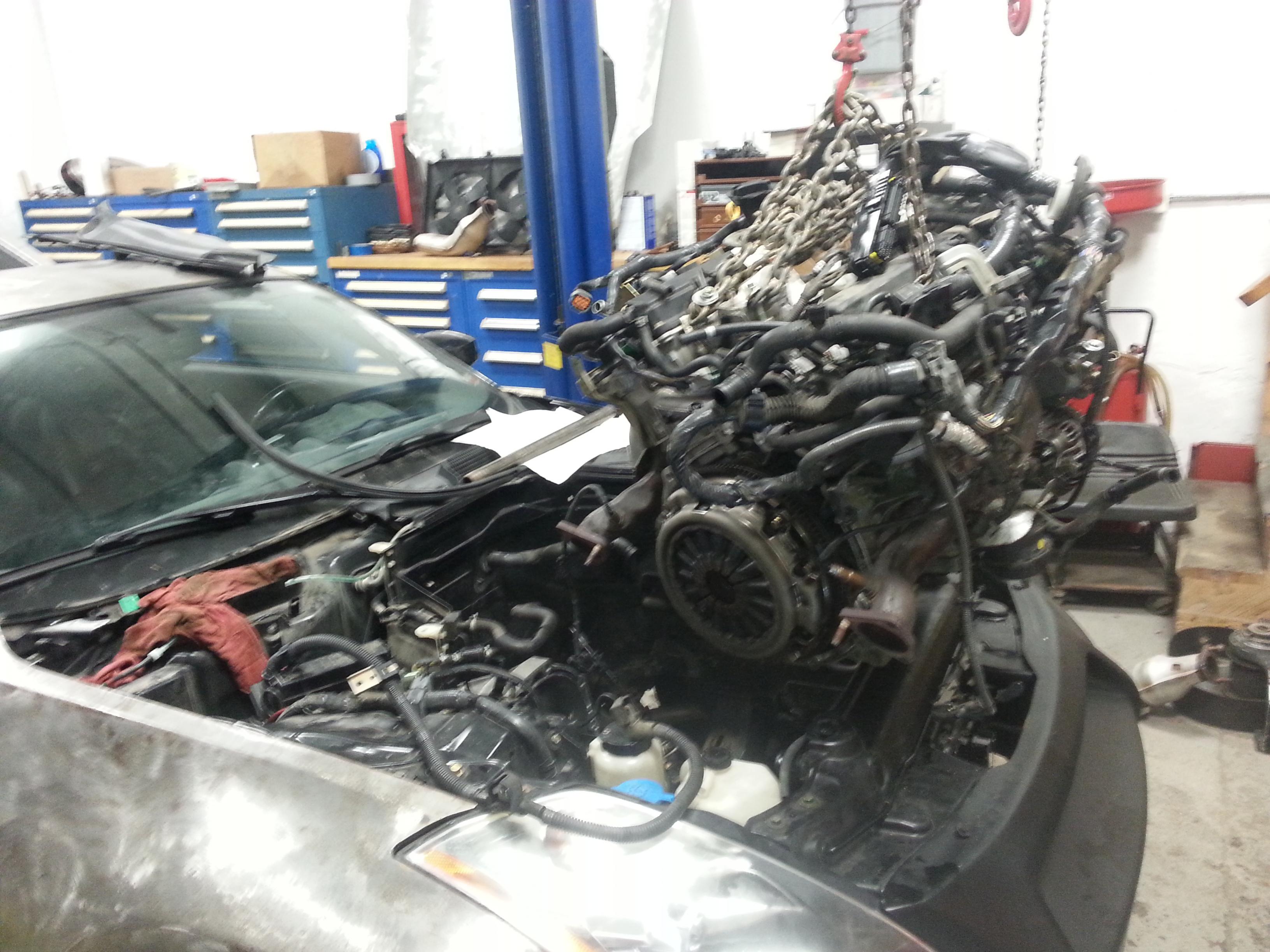

after doing a turbo build, a NA build and a supercharged build, i have pulled the motor on the ole Z quite a few times and am more intimately familiar with the engine compartment then i care to think about. having said that, i planned ahead of time to pull the motor in order to get these on. so thats exactly what i did. started by disconnecting the wire loom from the ECU. there are 2 things you need to worry about when doing this. first and foremost is the main ECU bus terminal. very self explanatory, pull the big white lever and disconnect it. the second part is a small white connector that comes off the main engine harness before the ECU bus. disconnect both and push that bad boy through the firewall. easy. then continue to disconnect all the other creature comforts from the engine that are typically necessary ( if you want details, feel free to PM me or email me and i will answer all associated questions). after you get all the fuel/ac/non main harness wires off the engine, pull that workhorse out of her stable. once the engine is out it will most likely look like this, unless youre on the wrong forum:

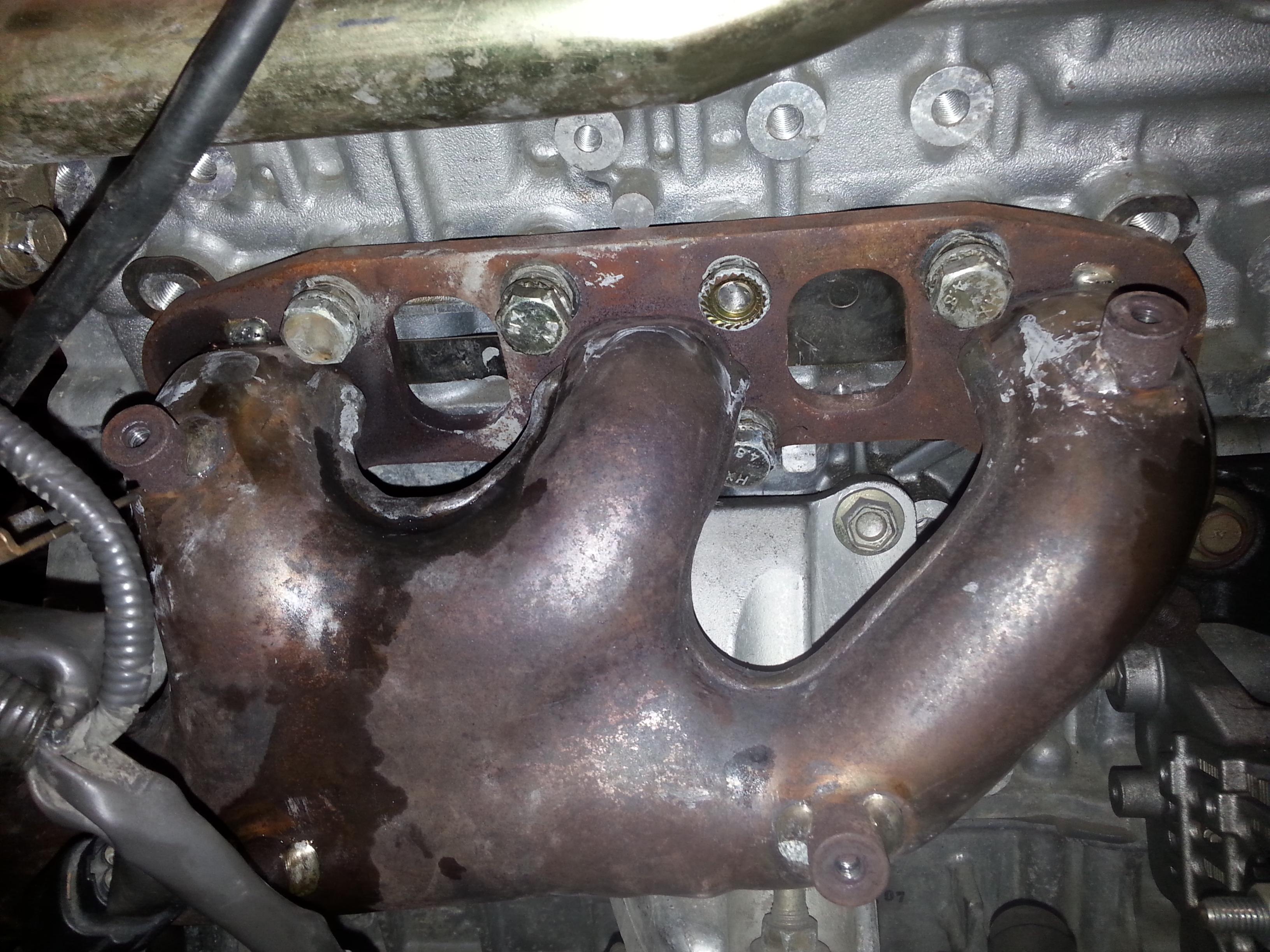

pull these guys off

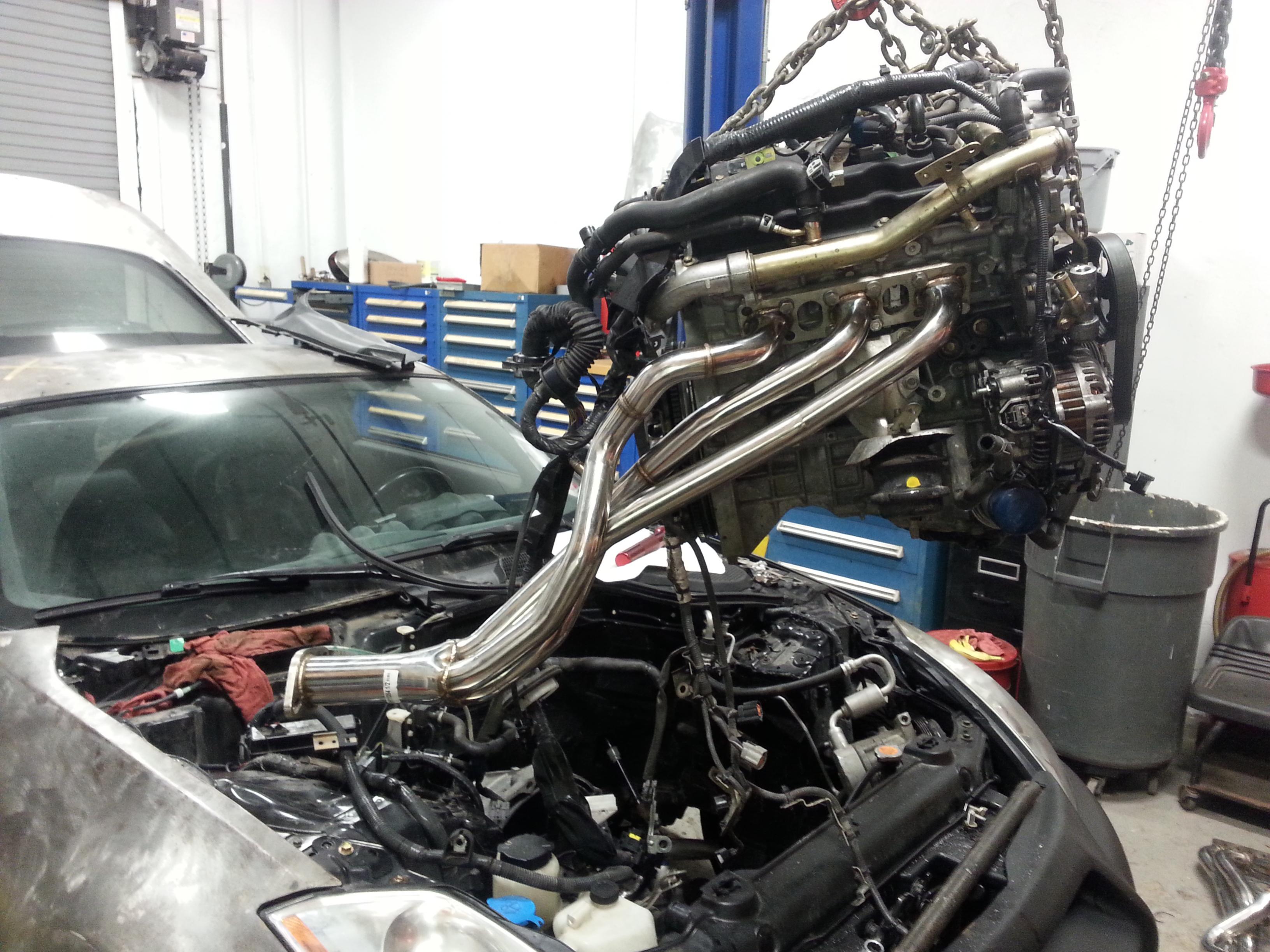

then go exhibit on that engines *** and make her look like this:
and this is where your life starts to get really complicated if you did things the way i did. it is at this point i would like to tell all my E-trolls that at the end i will explain how i believe you can make this process easier than the way i chose to do things. anyway, onwards. the next step is to disconnect your entire steering shaft where it connects to your steering box and move the shaft to the side. THIS IS ABSOLUTELY NECESSARY AND THE INSTALL WILL NOT WORK WITHOUT THIS STEP. once that is done, grab yourself a ratchet strap from your daddys strap-on drawer (what?). i got one from harbor freight for like 4 bucks. you may destroy it during this install so i recommend using one youre not attached to. take that ratchet strap and put it around the ends of your tubes and ratchet the living dick out of it to pull your tube ends closer together. this is only to clear the firewall and get your engine in the bay. once this is done, you may have to play with the straps and open/close your tube gap as required. i move the straps a few times but i assure you this is an absolutely critical step to getting this SOB to fit. if youre VERY lucky and you have a few friends helping you out, this process will take 1-2 hours (getting the engine in the bay) so overall install time with no hiccups, expect a minimum of 7 hours. obviously once the engine is in, spline that hooker up and bolt her down. another hour till running if youre experienced.

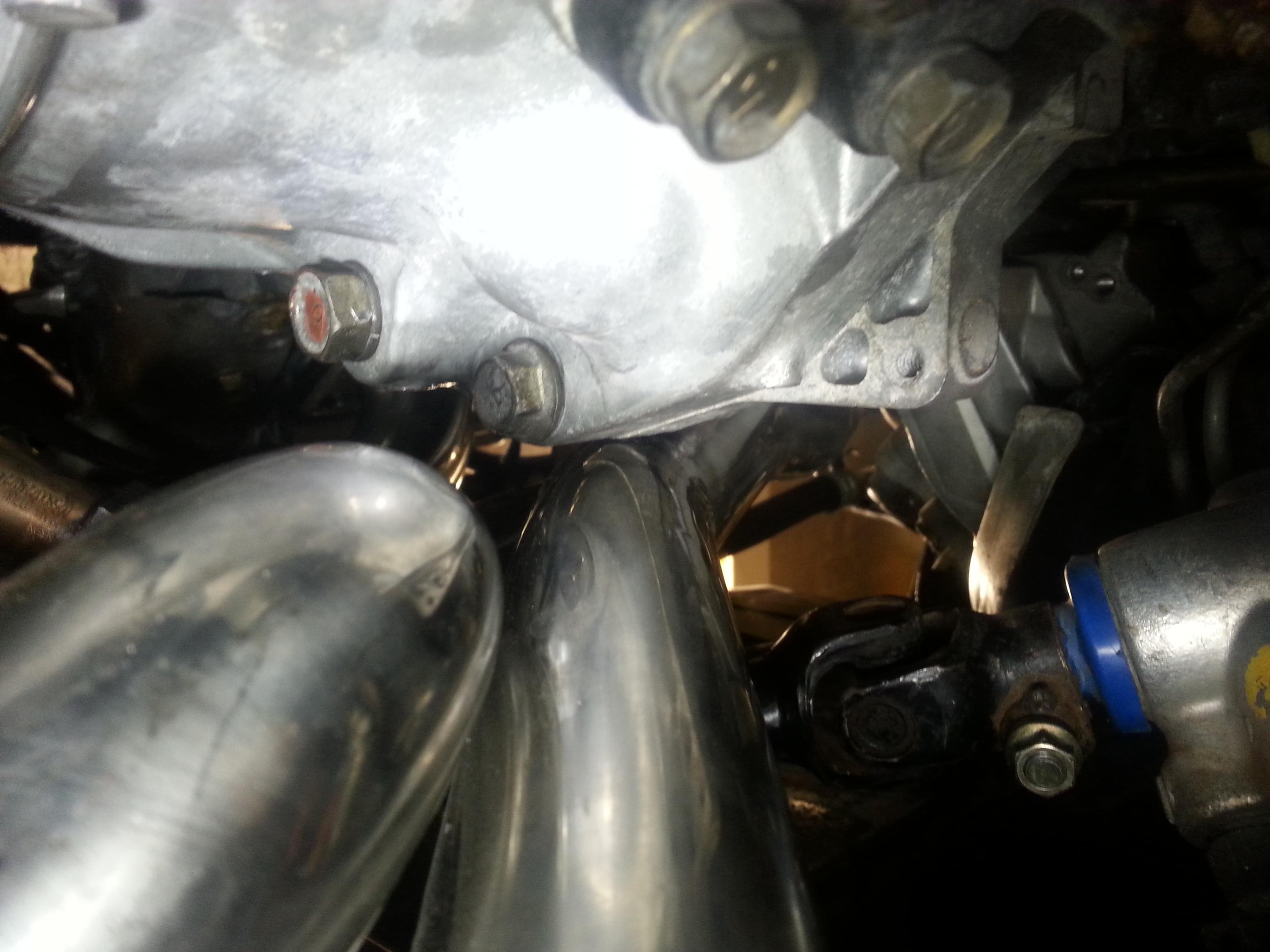

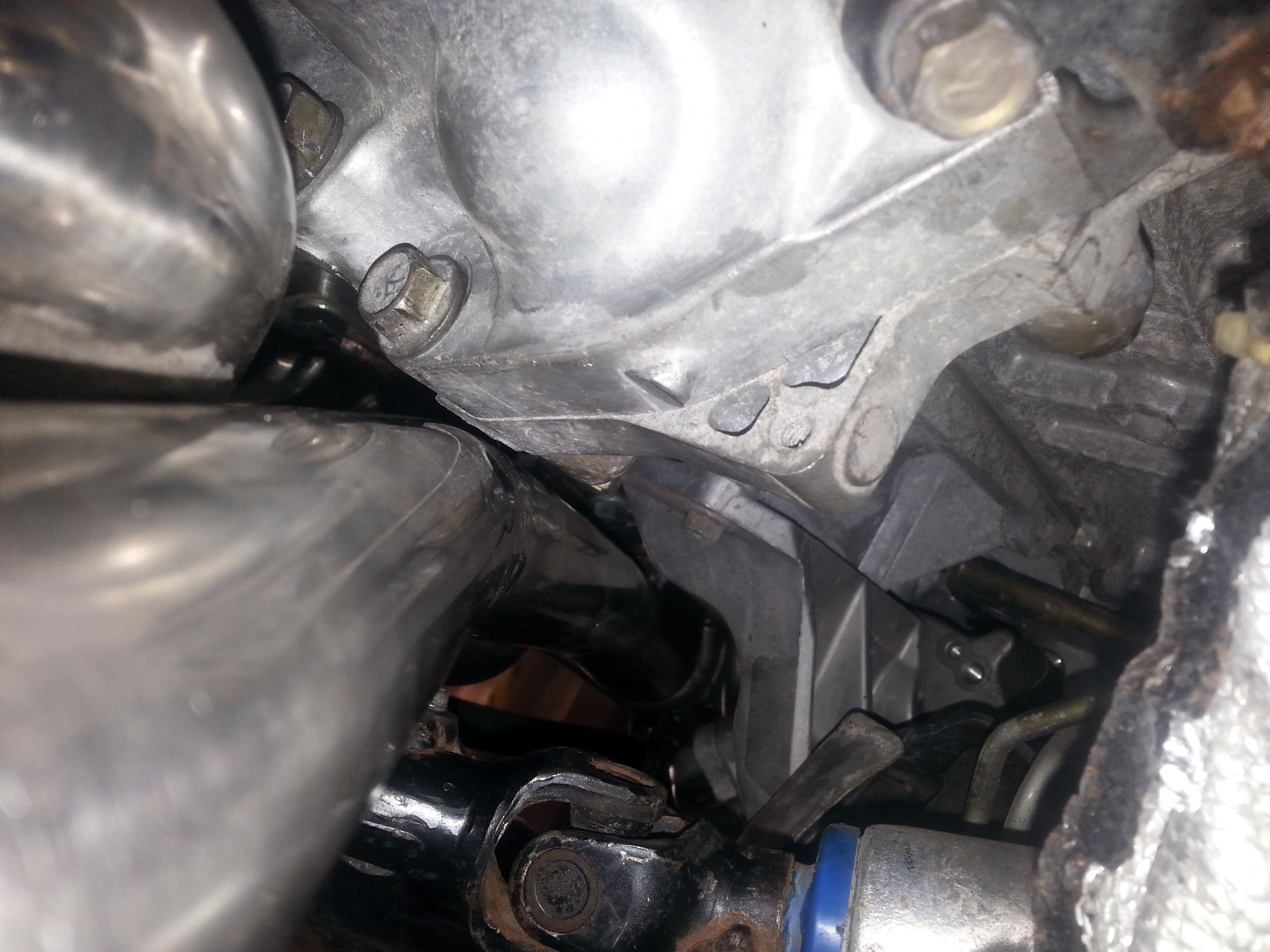

now for the important part so i can quell some of the hater-trash thats flying around the interwebs about these headers. the fitment on these things is absolutely insane. if either of them had been off by only a few MM's these things absolutely would NOT have fit. and for the court room, i now present my evidence. because i didnt specifically name any of these pictures and i am now a few sierra nevada torpedo IPA's deep, i am not going to explain what they depict. you should be able to tell what the story is. bottom line, VERY tight tolerances.
so as you can tell, the fitment is absolutely perfect. however, i made my job easier by cutting off the mounting tabs for the silly bracket that comes stock to link the 2 sides of your exhaust, this may be visible in the pictures. i took a cutoff wheel and went to town on the little tab in order to make the engine insertion into the bay easier. trust me its necessary and the tabs are worthless.
