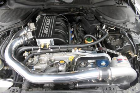

So, I'm in the market to supercharge my 08. I was looking in the direction of a procharger setup because I like the idea of the self contained lubricating system.... Now I'm seeing that procharger doesn't have an hr setup?.... Is this right?
I've done a little research on this and have a lot of experience on doing many different turbo builds as well as tuning on other vehicles, but I'm pretty set on trying my hand at supercharging the Z. So just a couple of questions for you guys... (Which I'm sure will lead to more)
1. What options for a self contained lubrication SC kits are out there for the HR?
2. Would a SC setup for a DE work and I would just need to fab up piping for the dual intake?( I think I was reading the timing cover and sc bracket was different DE to HR????)
3. What tuning options do you prefer with the HR ( I'm looking to street tune on the fly with a wideband if needed.. Nothing preloaded cause my home and nearest city are about 4k feet elevation difference).
Any constructive advice would be appreciated!

Stillen makes one for the HR if that's what he was referring to.
