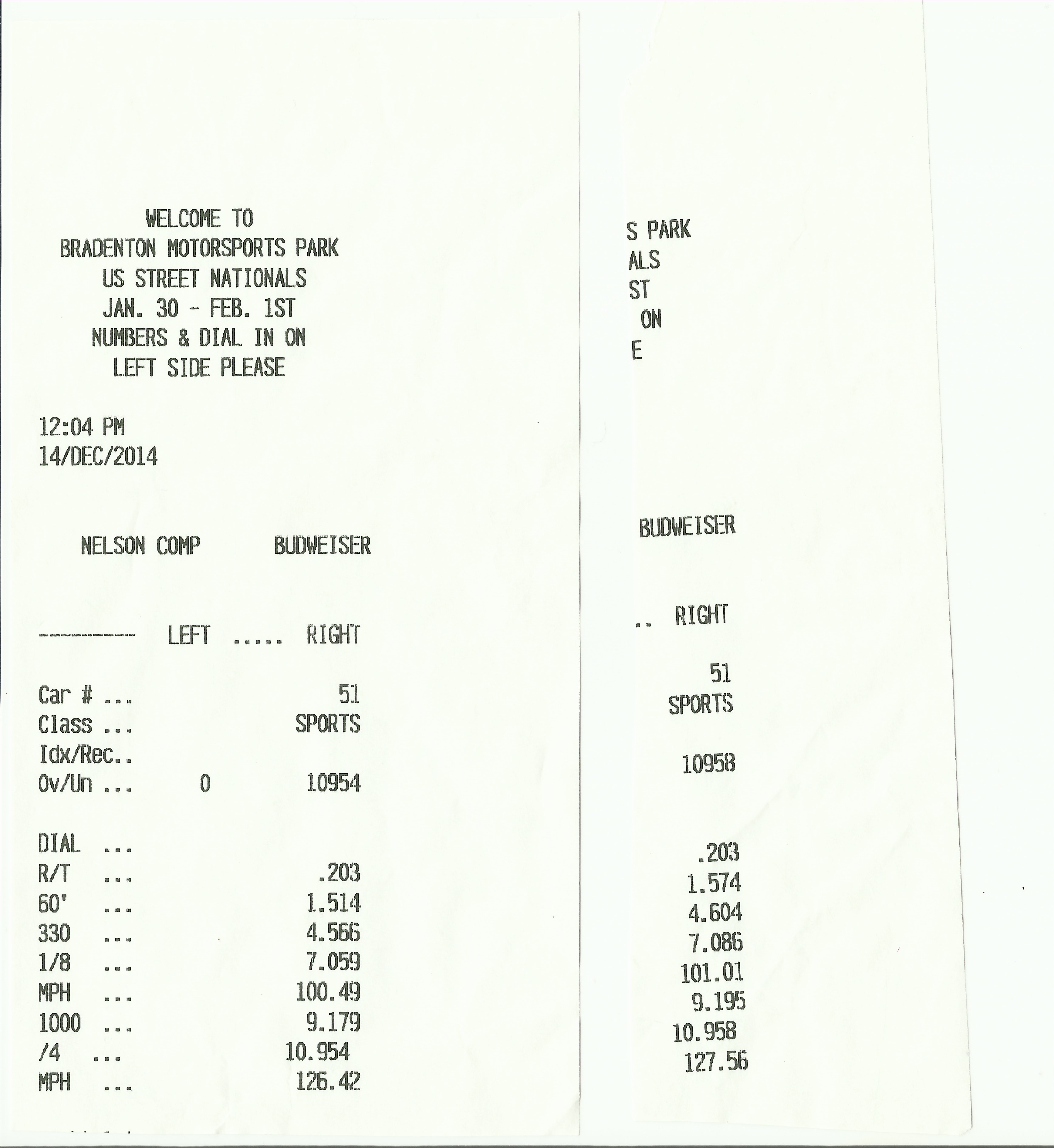

I Finally put the First 350z or G35 with a Stock motor and Full Weight in the 10's.
To my know age there is no other in the 10's anywhere.
TimRod's Un-Touched Stock Motor Full Weight 2003 Touring 350z
Best to Date;
60ft 1.514 10.954@127.56mph
Attached are two back to back runs.
This Video was my First Run and Worst Run of the Day 11.06, AFR's were Very Lean, and the only footage I got
Please if you know of anyone that has beat this time, please post....

Yes!
1. Installed a RJM Clutch Assembly
2. Installed Tuning Gear, so I can Tune at the Strip. This was Huge, and in the first pass was Extremely Lean.
3. Went to a 75% c16/ 25% Pump mix, vs had a 50/50 mix.
4. Added 1* of Ignition Timing in Across the board in boost.

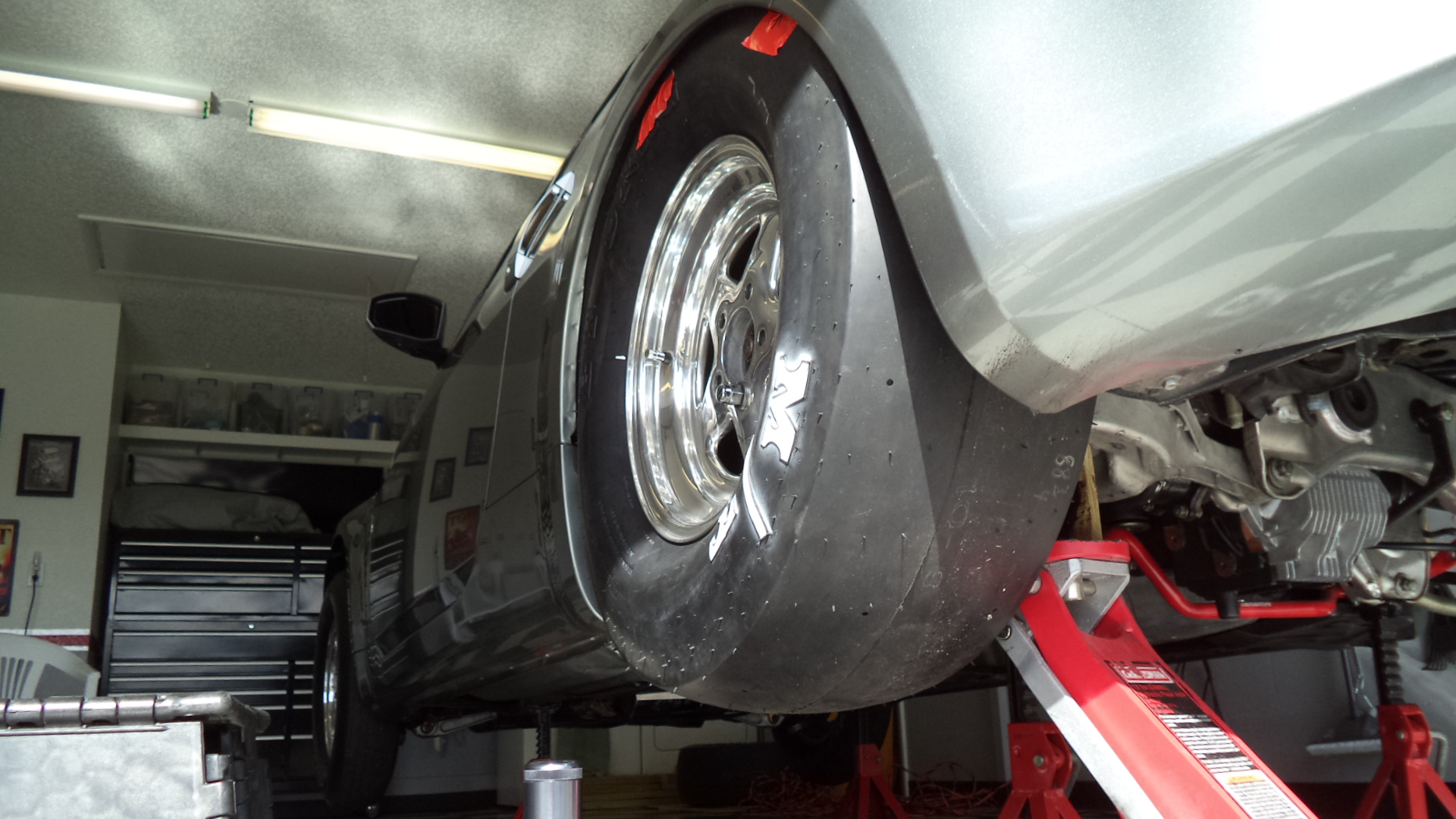

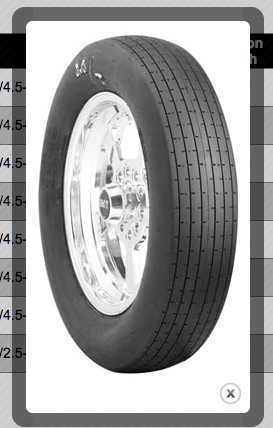

Wheels and Tires
Fronts are MT ET Fronts 27.5/4.5-15 mounted on Weld Prostars 15 x 4 with a 1/4 inch think spacer to clear brakes, and longer Lugs.
Rears are MT ET Drags 3055S 28.0/10.5-15S mounted on Weld Prostars 15 x 8 with 5.5 B.C.

How well do the mt tires fit on the back or did you have to do some fender massaging.

I had to trim about 1/2" off the Flange around the wheel well.
They Fit Nice!
