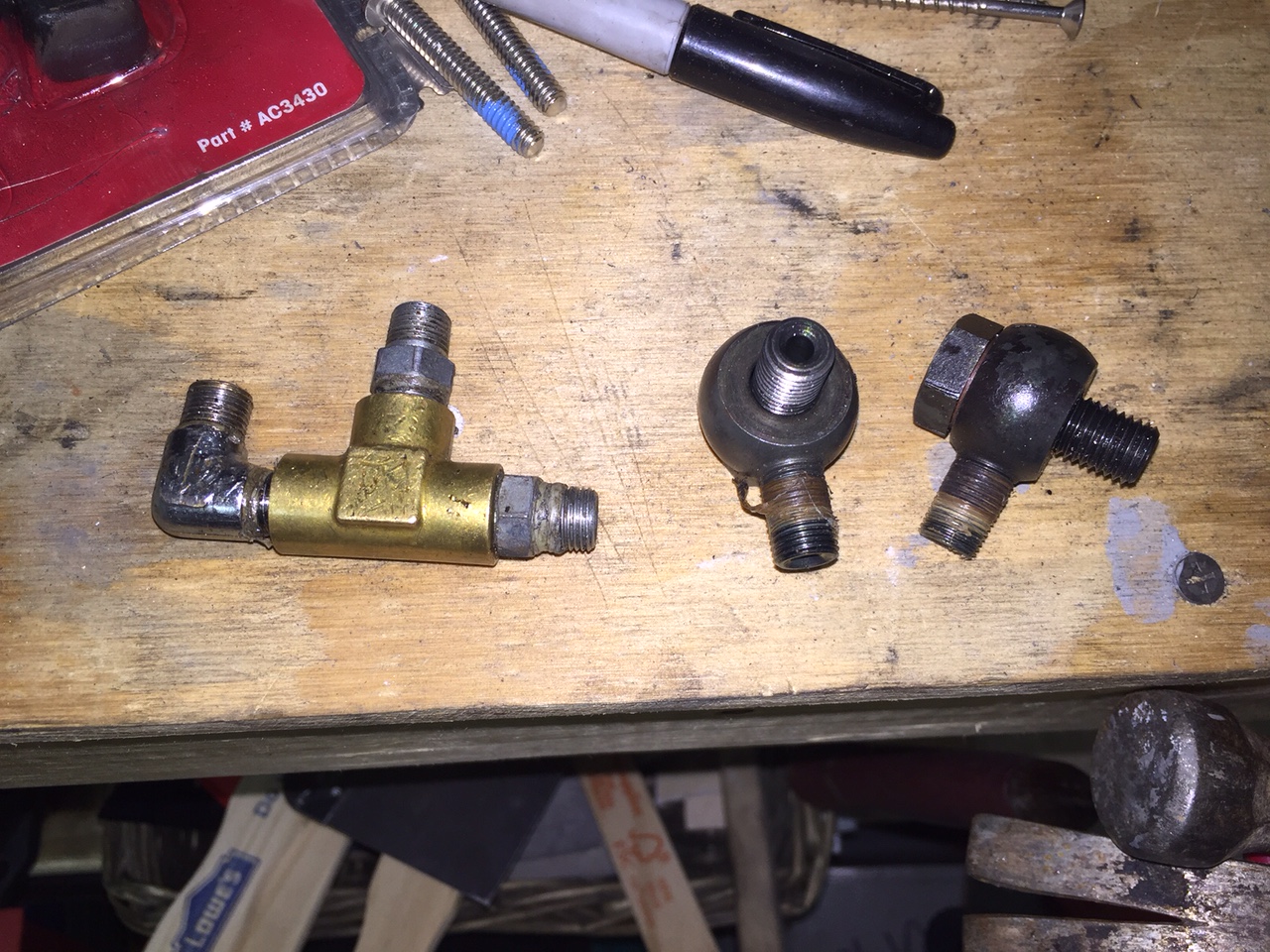

Hi all, So I bought a used 18g greddy kit off of one of the members here for my ZR. I have just about everything I need and the car ripped apart and ready to put back together with the goodies however when purchasing this kit I had bought a fuel return kit from the seller initially prior to purchase the kit. Unfortunately the seller sent me all of the oil feed fittings (that tap into the block at the oil pressure switch and add outlets for the greddy feed lines) with the fuel kit and when i went over parts for the fuel kit I had no idea what they were, I asked the seller and he didn't know either. So assuming it was a piece of random brass fittings irrelevant to the fuel kit and since I hadnt purchased the turbo kit, I like the dumbass I am, threw all those fittings in the trash since I thought theyd make a ugly paperweight.
Long story short does anyone know where I can go get those brass fittings? I'd rather not go through the waiting game with greddy. I checked menards and nothing was small enough. Also I am in need of a banjo fitting for one of the turbo feed lines, for some reason one of the lines didnt have one. And also I need those copper washers for the banjo fittings as well. If anyone can guide me as to where to get them it would be greatly appreciated, summer is starting and my roadster is in pieces

is this what you need? pm me
Attached Thumbnails Greddy Twin ZR build... need help with oil feed fittings-img_5460.jpg
