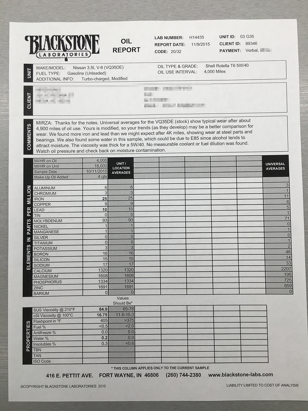

When I was on pump gas I was burning what I’d consider an acceptable amount of oil, since I’ve switched to E85 its roughly doubled… when I got the car back from the dyno I was running very rich though, AFR on E85 was in the high 7’s, I realized it after about 1,500 miles and then pulled some fuel to bring the AFR into the 9’s. I was wondering if that might’ve done it?

Finally got my first oil sample back from Blackstone:
Attached Thumbnails E85 Built Motor Oil Consumption-blackstone_vq35_turbo_built_1.jpg
