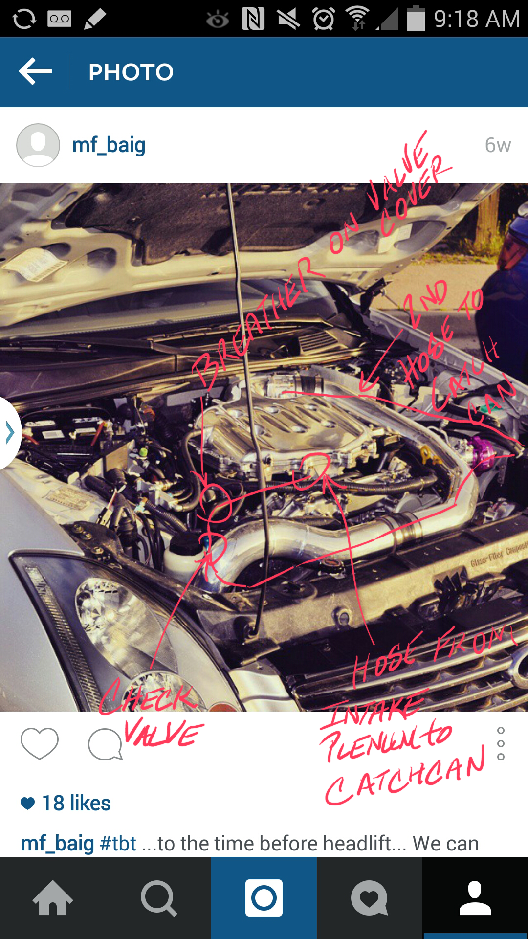

Old Jun 29, 2015 | 08:30 AM
thatv35guy's Avatar
thatv35guy
Joined: Dec 2009
Posts: 723
Likes: 59
From: Gilbert, AZ
Here's a quick diagram of how I routed my catch can, I'm not sure if it was routed correctly...
Attached Thumbnails Changed catch can and now burning tons of oil?-screenshots_2015-06-29-09-24-01.png
