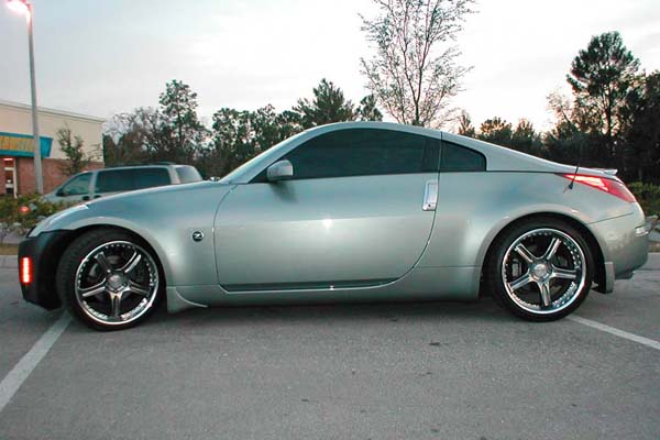

Default Vortech Install
Finished........

so hows the new ride..overall thoughts and impressions? How bout a review and dyno?

how about some pics and commentary??
Old Feb 14, 2004 | 10:04 PM
MY350Z.COM's Avatar
Posts: 579
an engien bay pic would be more appropriate.

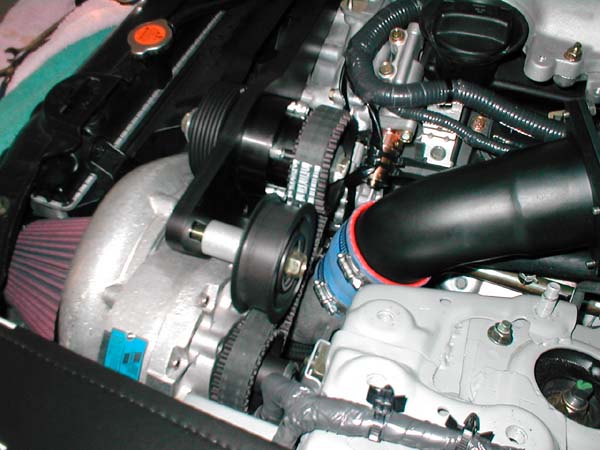

It was not an easy install......
I live in florida, the gas here is 93 octain, so I think tuning would help, but it runs well as it is...
My first real drive was yesterday. The roads were a bit wet due to rain. So I eased down on the throttle in 3rd gear, but the tires (285/30/19's) would just spin @ 65-75mph.
I waiting for the roads to dry today for a real test.
