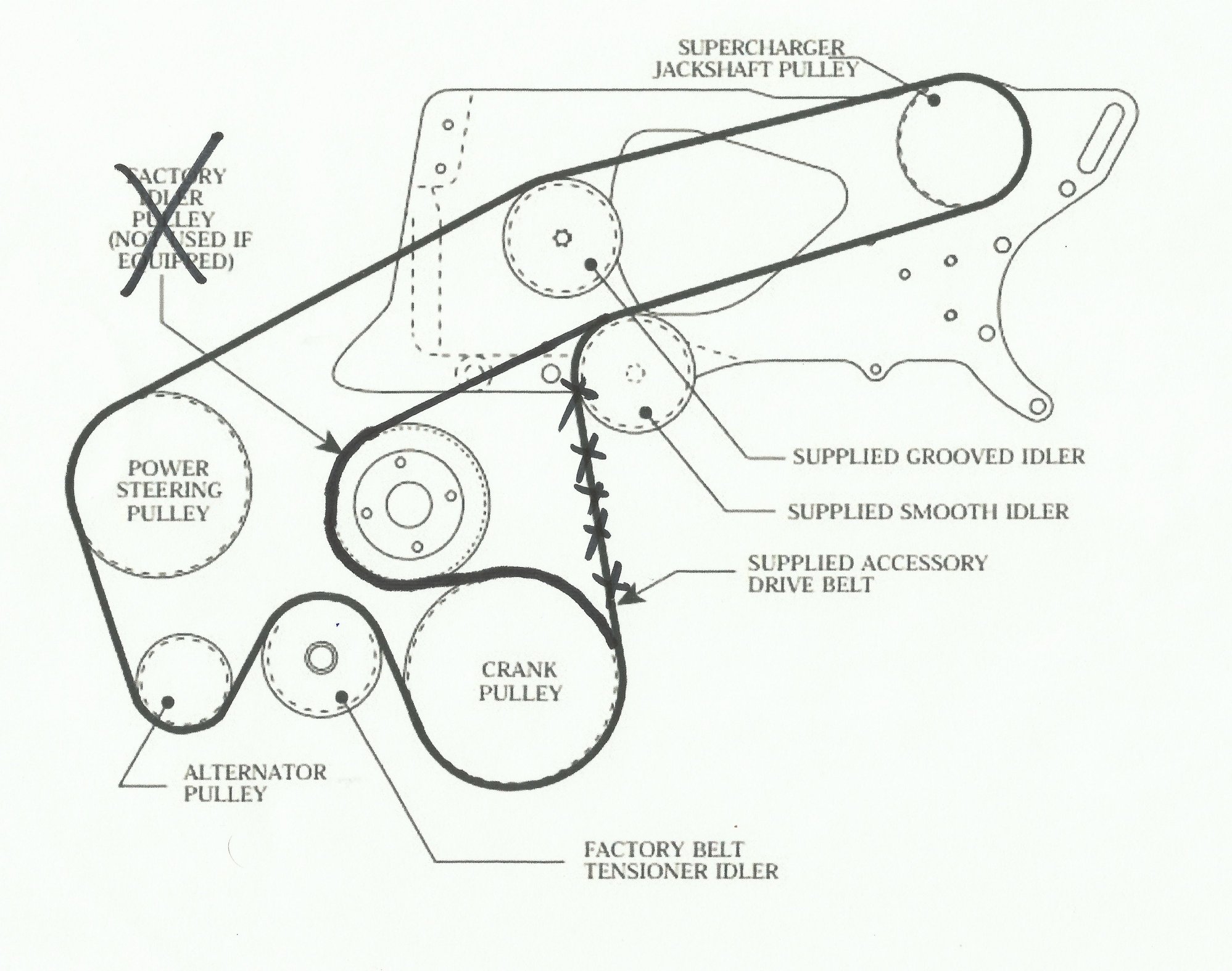

You have extreme belt slip, look at all your pulleys.
Do this, See Below. This will Rap the Belt around the Crank pulley at least 90 degrees more, limiting belt slip. Search back to 2004 for my belt and pulley modification.
If you have a larger Crank pulley, then you will have to make a smaller diameter fixed idler pulley.
Get that fixed Before you go back to the Dyno!

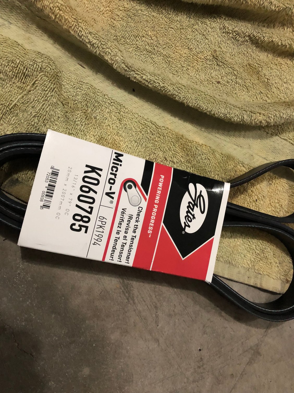

Bought a new 78.5 Gates in town with some more slack to use. Checked all pulleys and none were worn, wabbling or making any odd noises. Going to have to research more on getting a tension pulley in place of the OEM idler location that fits that style and bolt pattern. Worst case is to find a machine shop to grind down my old stillen lighweight idler and remove the V teeth and smooth it out. Then there is getting the correct belt size again after that...

I can get you close on the belt size.

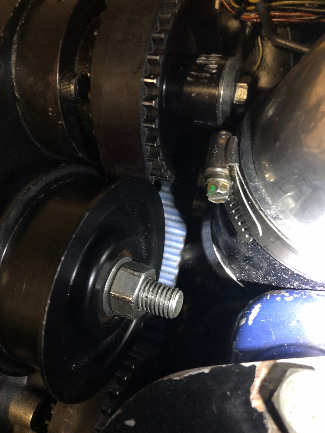

Quick question, did you check your alignment on your pulleys?
Before on street pulls, I would eat a belt every time I try going WOT. Tried checking alignment and found out my Blower bracket was warped. (Swapped it and now my belts are fine)
I don't know if it's Vortechs design, but that bracket isn't nowhere near strong enough that it should be. (Also note that I'm using Timrod's radius rod too)

Hey Otaku, from what i measured all my pulleys are aligned. Bracket is not warped at all. With the Fleetrunner belt i was using at the dyno, there was no belt slip whatsoever and no breakage, only when i pullied down to the 2.62 with a generic gates belt is where i had the problem of it snapping. My belt was literally banjo tight, could barely turn it, which is why it probably snapped once it hot hot upon operation. Im going to be running a Gates RPM belt instead of FleetrunnerHD because they dont have the size i need with this 2.62 pulley setup.
I have Timrod's Brace as well, i didnt notice any flexing of the bracket at my dyno session at National Speed so i say its doing its job

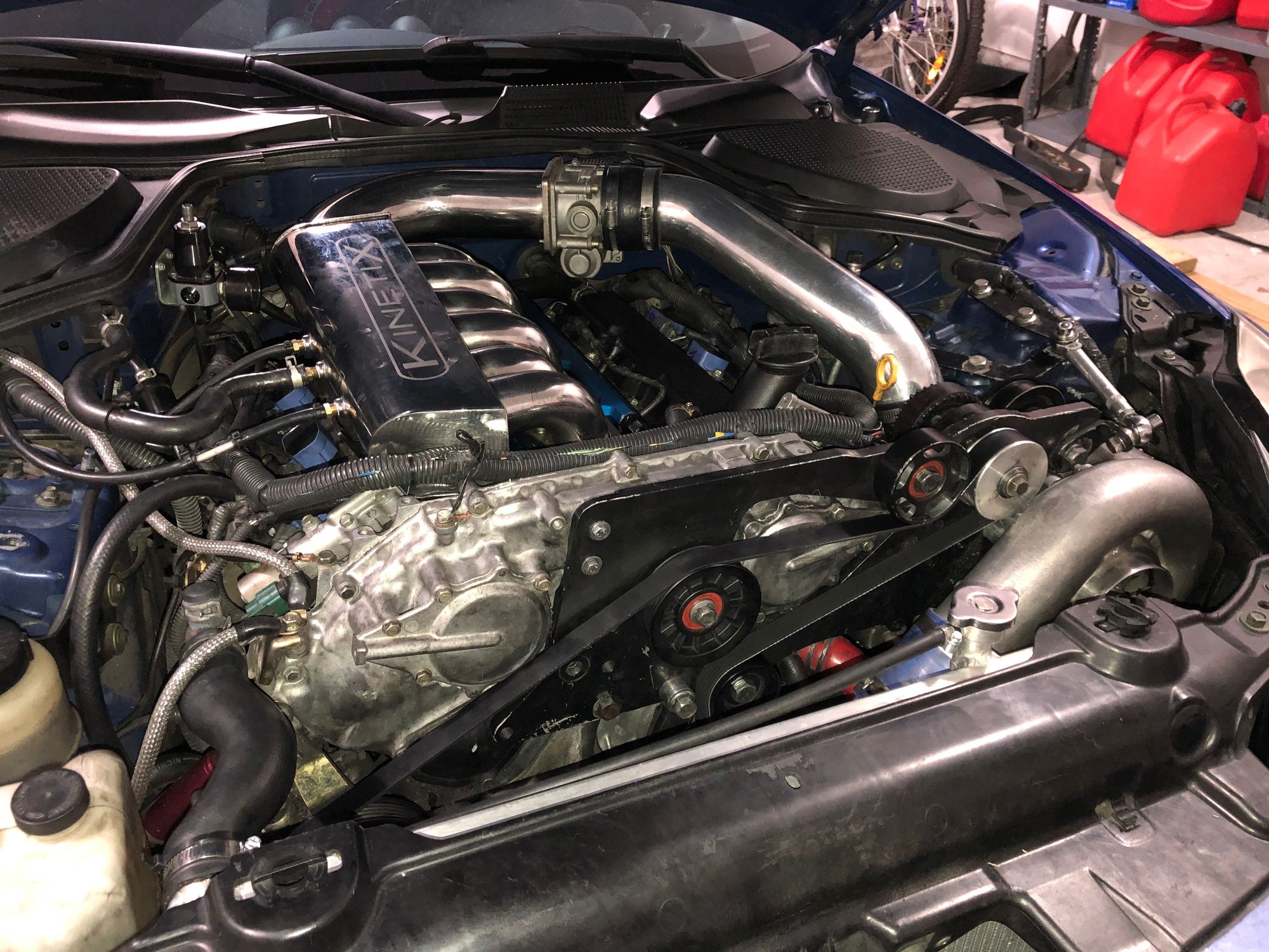

Update on the car. Put about 200 more miles on her after the new belt. Per 0taku's advice, i steadily revved the car under light load to redline to make sure the belt would hold and there were no problems or belt material in the engine bay. Car is driving well with no obvious issues.
Forgot to update on my base fuel pressure when i was getting tuned earlier this month. I am at 32psi at the FPR. I believe Vlad was able to idle the 2200s alot better at this rate, not going to question it. Car drives fine. Just needs to be dialed in for WOT and perhaps a higher idle once the engine is warm.
