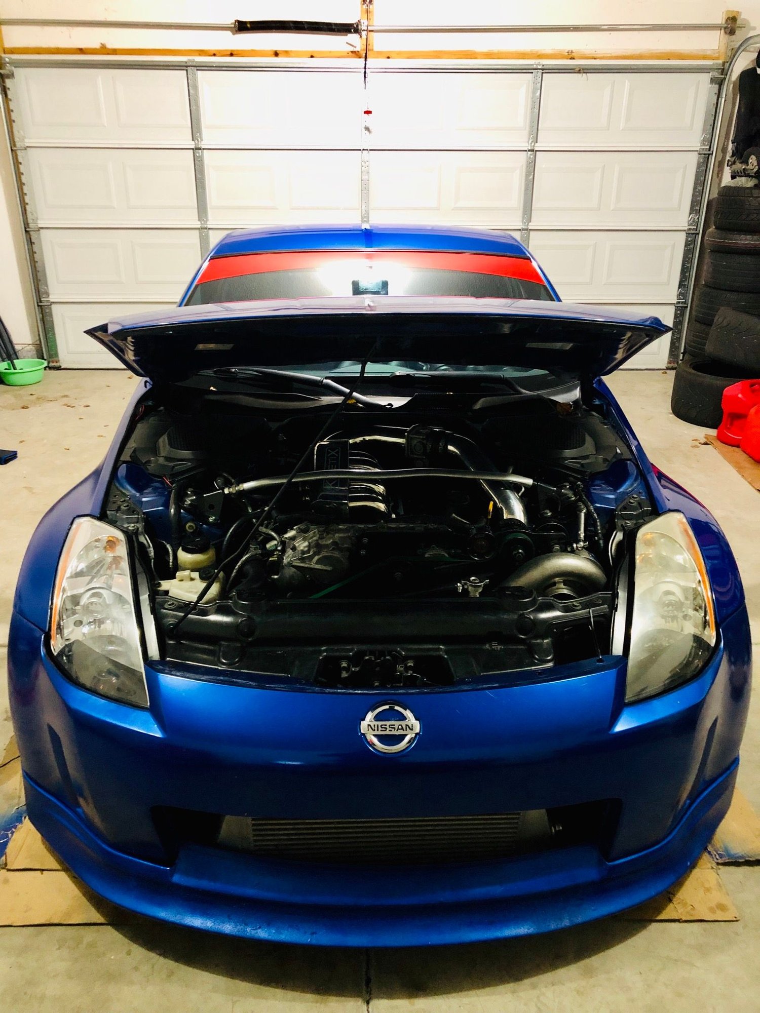

Car is driving better now after constant logging and tweaking of my tune, but not perfect. Its as good as its gonna get right now until my Tune at Soho (looking like Feb of next year timeframe) Wont be updating much as this time of year giftshopping and other expensive purchases for the holiday take priority.
Bealljk, wasnt able to improve the idle rpm fluctuation, i believe its my flywheel because it did this before with my 1600cc's. Less mass = less rotational inertia so a slight difference in power will change the speed of the flywheel rotaion rather quickly.
That's a great pic - I'm not sure if you meant to shadow/adjust the aperature but the strut bar, kinetix, intake, blower, etc but it's a pretty sweet effect.
Yea - in general idle is weird without an ecu that can correct for it and/or not having an idle air control valve...my biggest thing was the haltech would drop down to 600rpm and then bounce back up...doing that over and over and over, over 8years may not have been the best for the engine longevity. It can be something the tuner works on. definitely in for results!
(by no means am I taking away or coming off critical) I would look into hood dampers. I bought an unbranded set off Amazon for $80 and it cleaned up the engine bay and made raising & lowering the hood much easier/cleaner.
