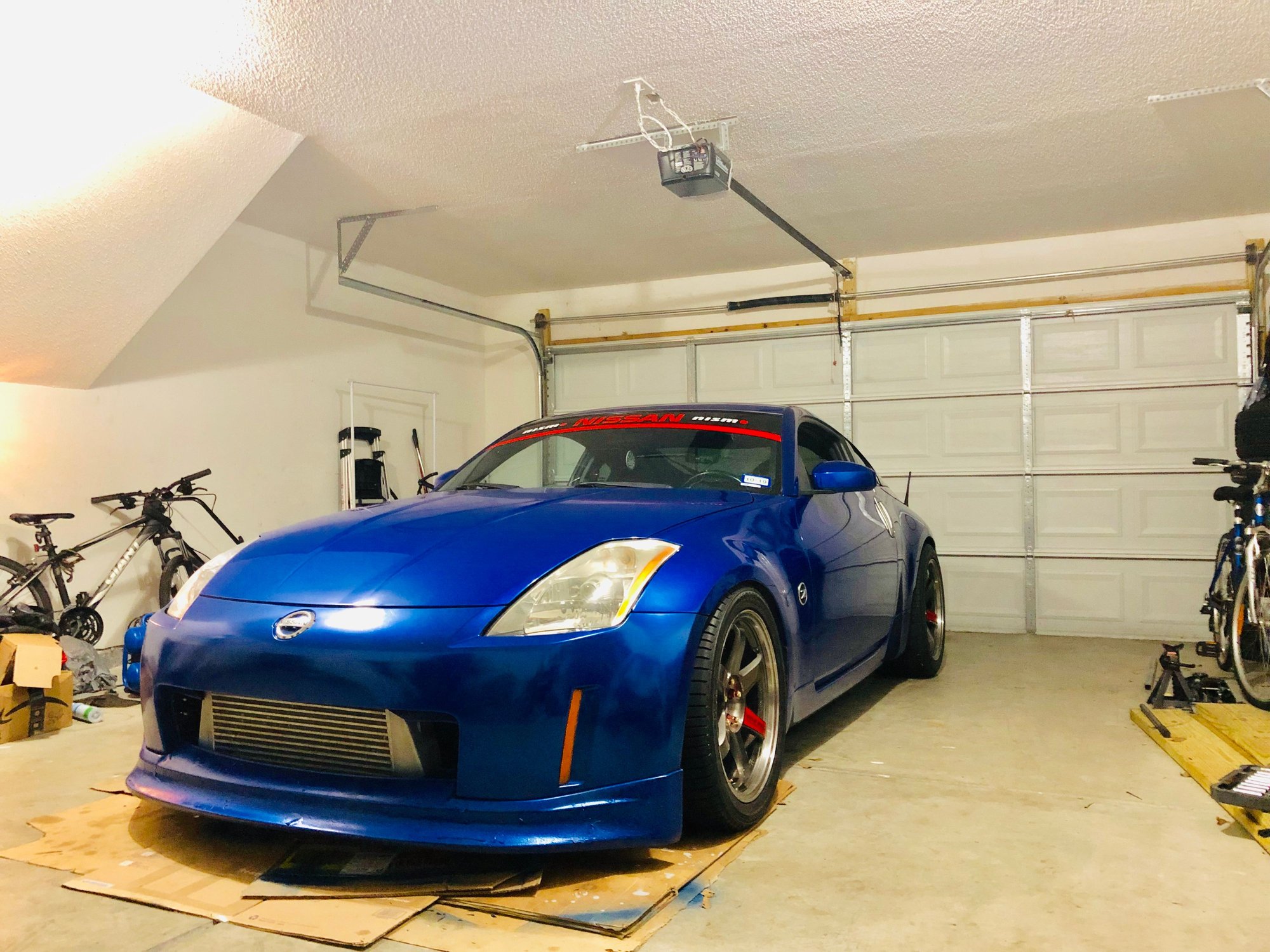

Not much of an update but changed up some cosmetic details. Changed up my windshield banner, Not sure how i feel about it, will let it sit for a few days. Car has been bada$$ besides that. Just waiting on Tune day.
tbh, I'm not a fan ... I like the 'nissan' ... I dont like the 'nismo'.
Regardless - some great shots of the car!
Thanks B, the thing only costs 30 bucks so its not a loss if i peel it off.
