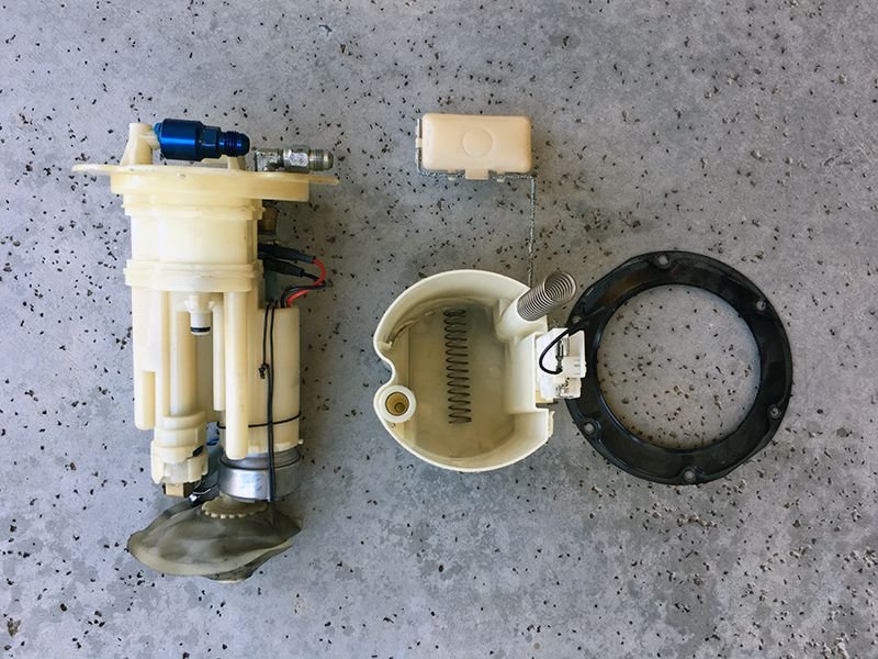

Quick update, looks like my Walbro 450's on its way out. I noticed the car was cutting boost and turning up the injectors at high RPM, etc. e85tz33 gave me his spare 450, I'll be dropping it later today and make a few test hits.
The pump had about 25k miles on it, primarily on E85

Yea that filter is pretty dirty. Nice of your buddy to come thru with the hookup...
