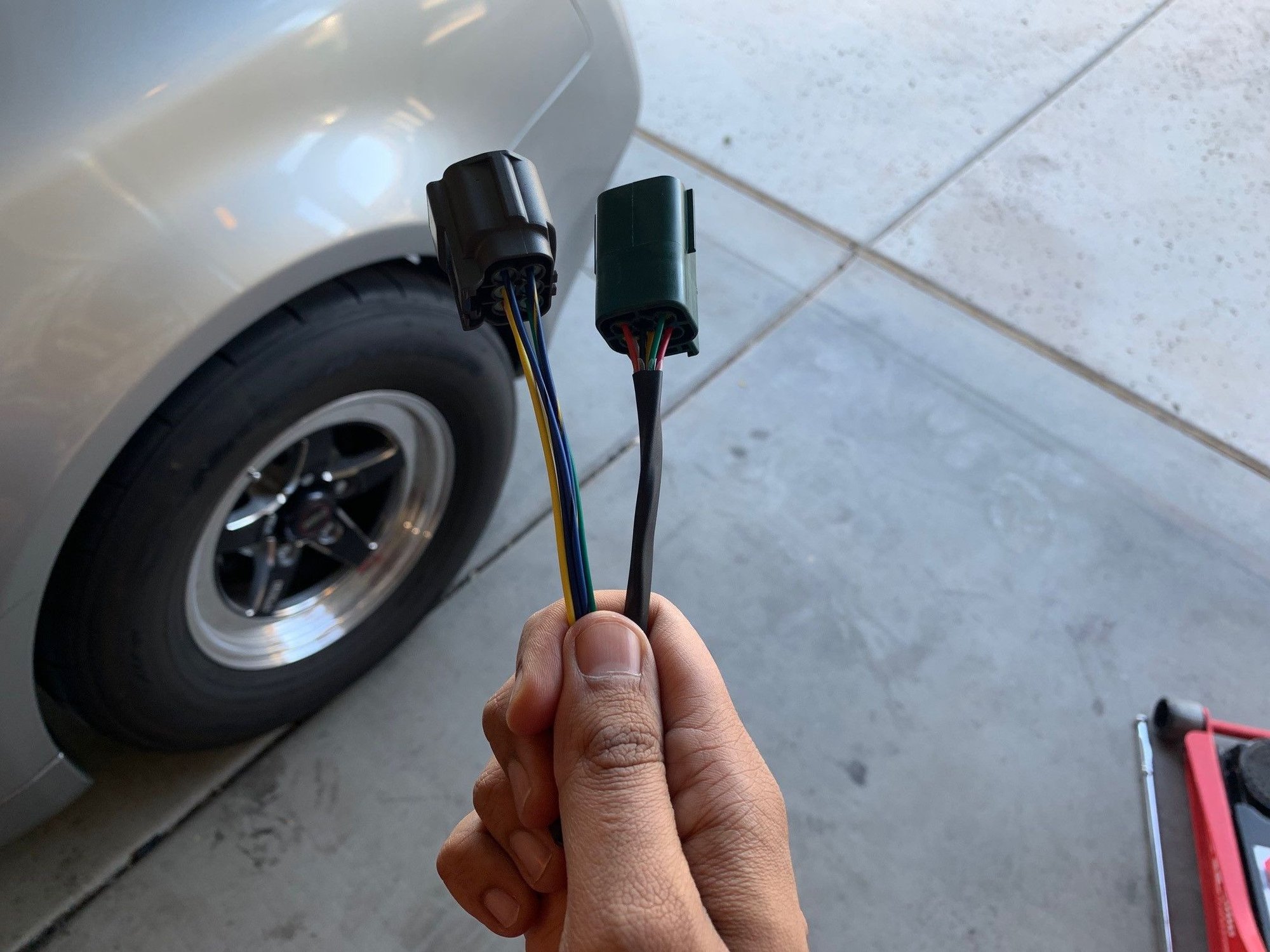

Working on making a jumper harness for the OEM throttle body and LS3 throttle body
This is amazing
