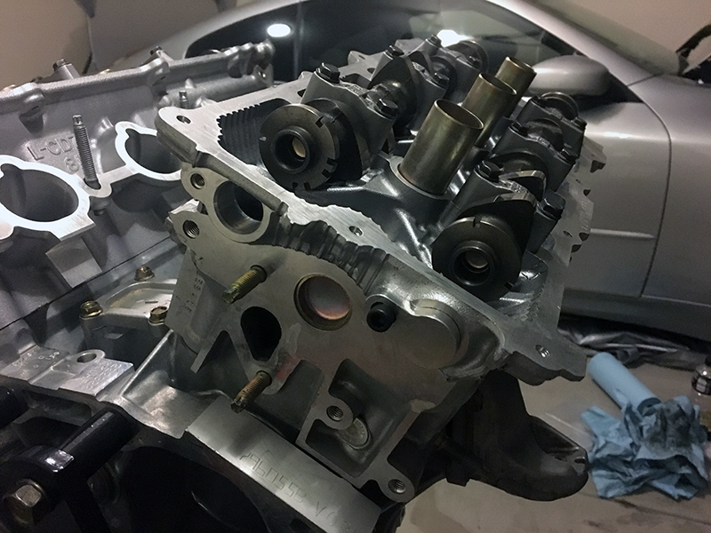

I've done it on 2 cars now with the engine in place. Putting that front timing seal on was no problem at all. I put the bottom in first then tilt the top into place. Never had a single leak from it.
The hardest part of doing it in car was getting the header bolts out. Other than that it wasn't an issue. I stripped the whole front clip off the car to get access to everything. The core support comes off with only a few bolts. Without taking the core support off I think it would be a nightmare.

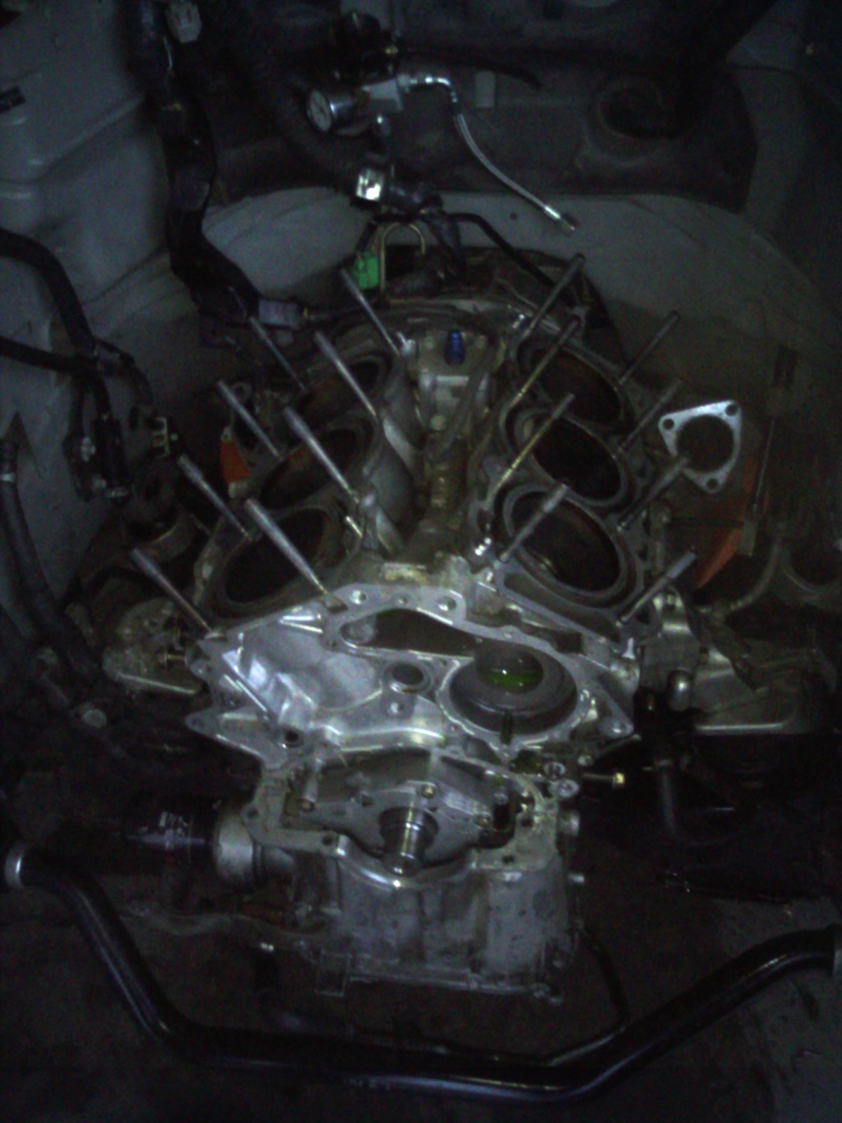

Here are some pics of it out. The second one is dark but you can see how much room there is to work with that lower timing cover mount.

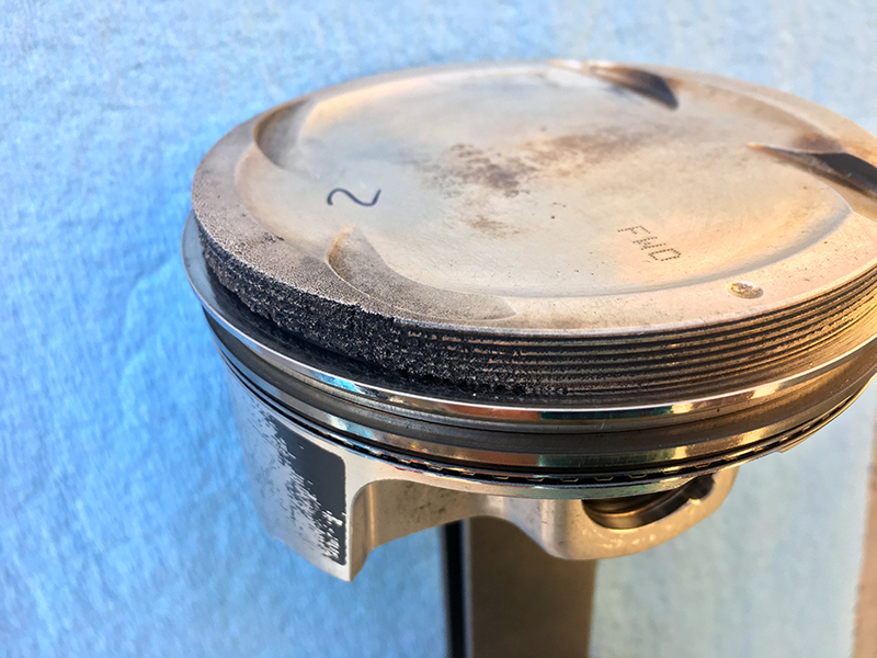

Welp... we ended up pulling the short block, long story short pistons are done.
I was cleaning the carbon off the piston tops and noticed a a very small crack at the top ring land of cylinder 1's piston. Ended up pulling the block to disassemble it and see what the other cylinders looked like, they all have some damage at the top ring land area, this piston's probably the worst.

Based on what I see on your heads and now pistons, I believe you had very high heat at the top of the cylinders. If you developed an air pocket around the top of the cylinder cooling jacket you could have detonation from the heat without any tuning failure. I chose Evans coolant for this reason. It does not boil in the same way that water does. Less heat carrying capacity, but I think it would have prevented this. When my fans failed following an airstrip run, I think I got coolant temps close to 300 degrees (while idling!) but with no deleterious consequences whatsoever.

So, all six pistons actually had similar damage, this was just the first to have a crack form, but all of them had some damage at the top of the piston, if heat was the issue wouldn't the damage have been confined to the cylinder with the air pocket? FWIW, I've never had this car overheat, even when it was pushing coolant.

how was this car tuned?
fuel used? E85?
if all cylinders had the same issue, I would have to say fuel/tuning related

The car was dyno tuned at ProEFI, most recently about 10-12k miles ago when I installed a flex fuel system. Since then the car's been running E85 almost exclusively.

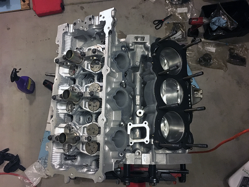

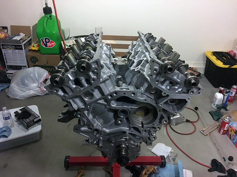

Build number 2 underway...
Rev up core
Wiseco 9.5:1 compression 95.5mm pistons
K1 connecting rods
ACL WPC treated main & rod bearings
ARP main studs
ARP L19 head studs
HKS head gaskets
Dynosty cam sensor plugs
Attached Thumbnails -hks_head_gaskets_l19s.jpg   -hks_head_gaskets_l19s_2.jpg   -hks_head_gaskets_l19s_3.jpg   -hks_head_gaskets_l19s_4.jpg   -hks_head_gaskets_l19s_5.jpg

I just thought I might add a little bit. Copper head gasket spray really doesn't do anything other than make the customer happy. I have never experienced a situation where the copper head gasket spray will prevent a leak. Either you have true surfaces and correct torque and pressure, or you don't.
Good luck, and watch that ignition advance. Beautiful setup.
Yeah, since I ended building a new motor with newly machined surfaces I decided to pass on the copper spray.
