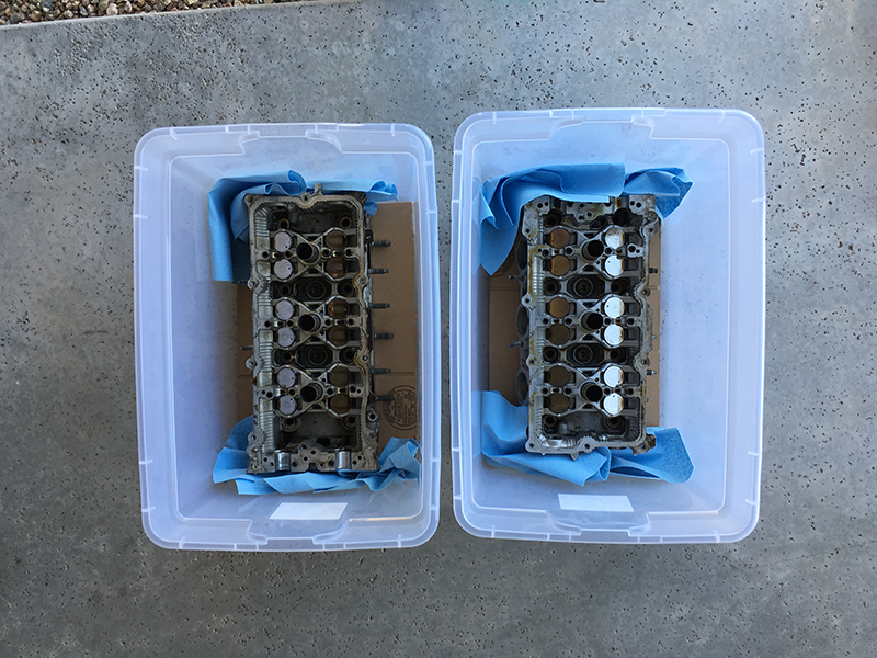

So, we started pulling the heads on Friday, finished up Saturday night (thanks to wtfmike!). After we pulled the heads I boxed them and dropped them off at the machine shop on Monday (APD Power Center in Tempe), got a call the next day, they found detonation damage on the heads at the edge of the combustion chambers. The option is to have the heads welded and completely repaired (complete dis-assembly, valve job, etc.) or to finish resurfacing the heads and throw them back on.

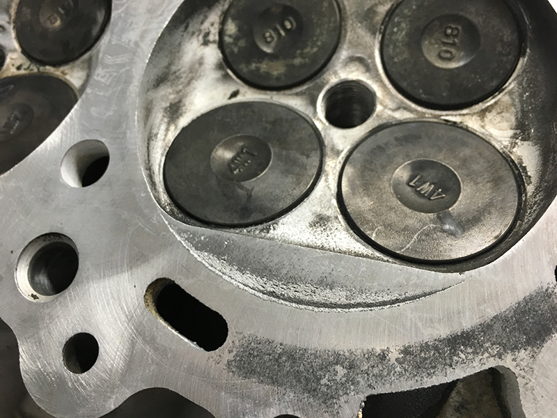

Close up of the damage, this is the worst cylinder...
Thinking I'm going to go forward with having the heads welded, etc., the damage seems too close to the sealing surface... I really don't want to have to pull these heads again either.

I am not sure the pitting will affect the headgasket seal at all. If those are stock heads might consider finding another donor. What cylinder is that? I would just machine flat and then focus on the cause of the detonation. Do you have a cosworth manifold? That sends more air to cylinders 5 and 6.

That was the worst cylinder (not sure what cylinder number that was), but they all had some trace of pitting/detonation.
As far as the cause, my guess was that after I initially lifted the heads I stayed on the throttle for several consecutive pulls… and on the last pulls, that’s when I noticed detonation, I lost the plug ground and electrode on one or two cylinders then. That was roughly 5k miles ago.
