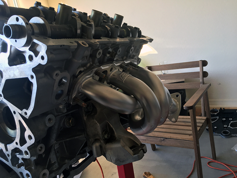

Adding headers this time around too.

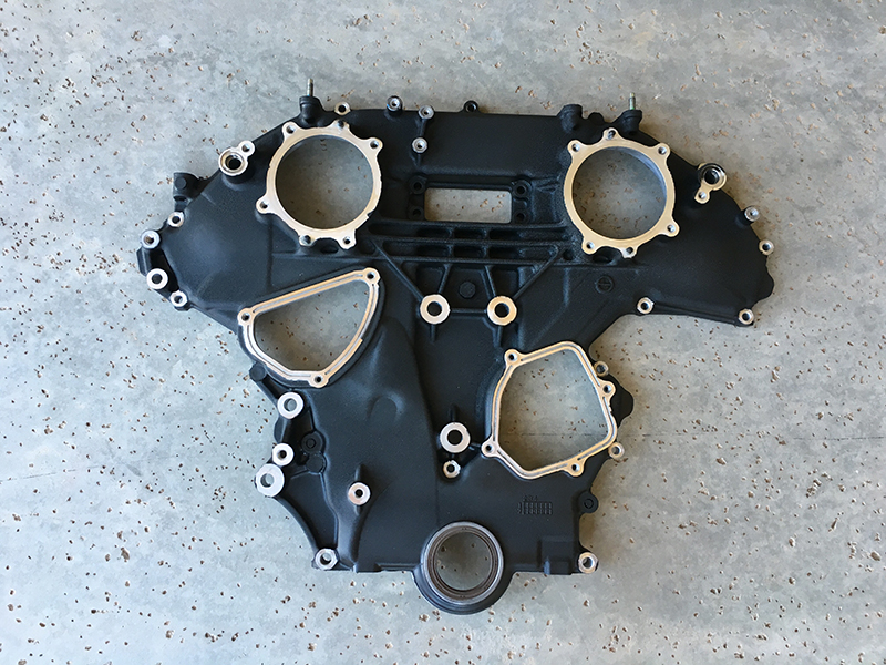

Also, ended up painting a spare timing cover wrinkle black (got tired of trying to keep polished timing covers clean), turned out pretty good IMO. I got the idea from an R35 owner: http://gtrlife.com/forums/topic/1078...e/page__st__80
Just a layer of primer, a wrinkle black coating, and heat gun. Just need to clean up a tiny bit of over spray.

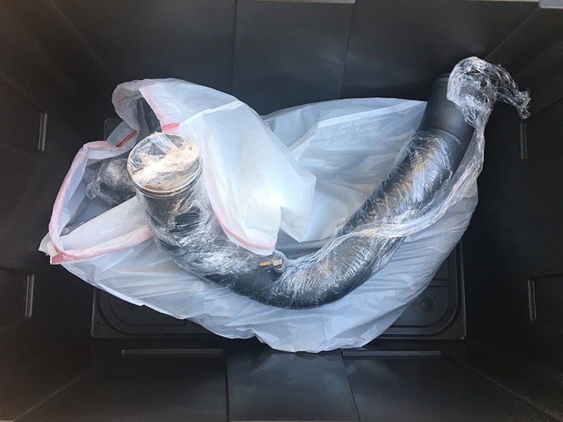

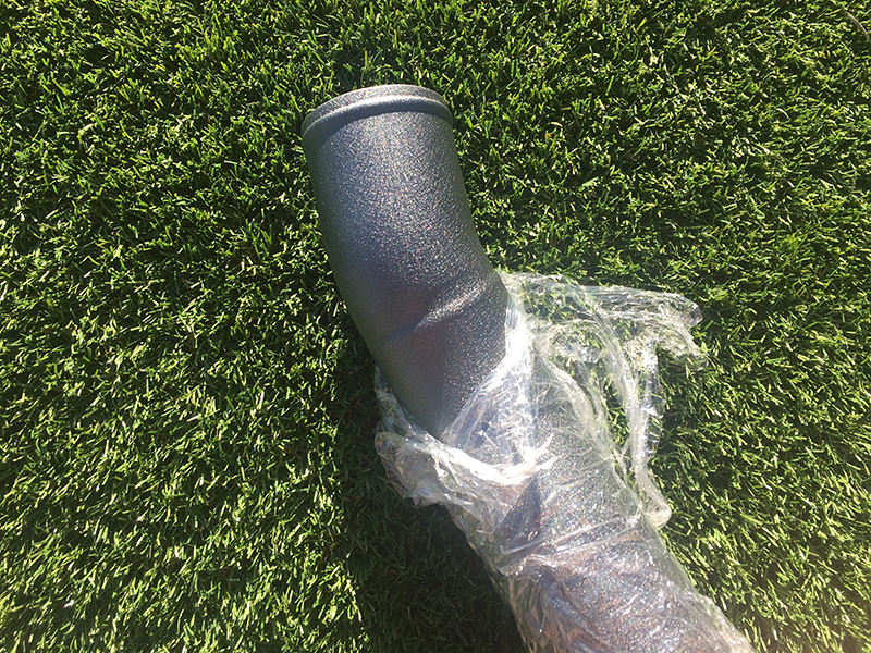

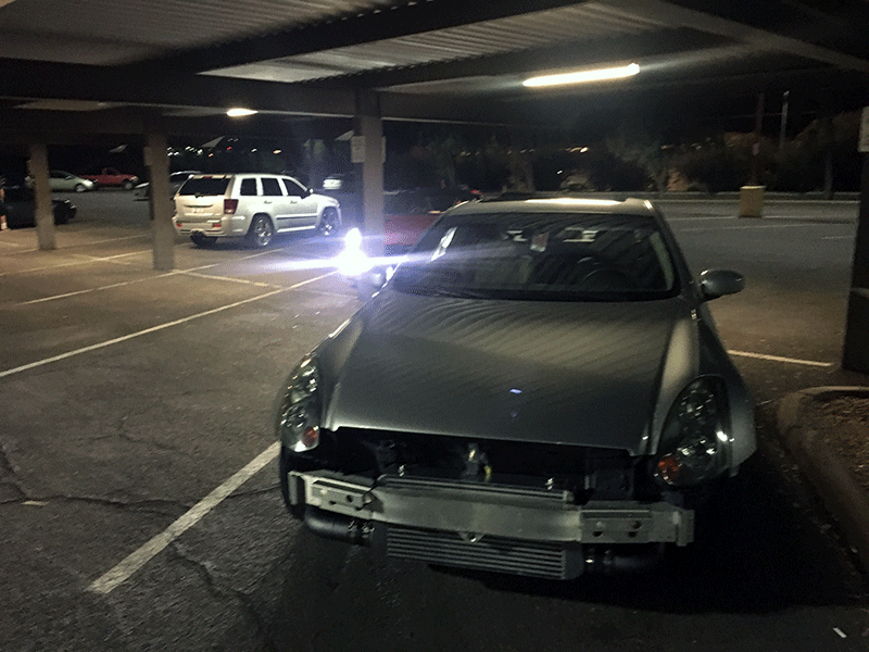

Quick update, we’ve been working on the car very intermittently, finally wrapping it up though…
The new motor’s in, timing set, turbo kit bolted up, etc.
Also polished my intake plenum & had the cold side piping powder coated a wrinkle charcoal metallic:

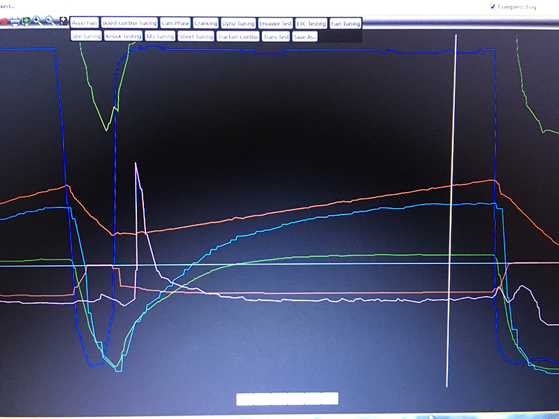

So, no dyno tuning yet... but I took the car out to make a few pulls on a back road just to get a preliminary feel for the car and make sure the AFR was sorted out.
Couple things I've noticed:
1. I've had to make very little adjustments to my AFR
2. My exhaust back pressure ratio has dropped fairly significantly, I was previously seeing a ratio of 2 to 2.2, with the new 6266 upgrade I'm seeing an exhaust back pressure ratio of 1.6-1.7
3. I'm making 1.5 to 2 psi of boost over my target boost level
