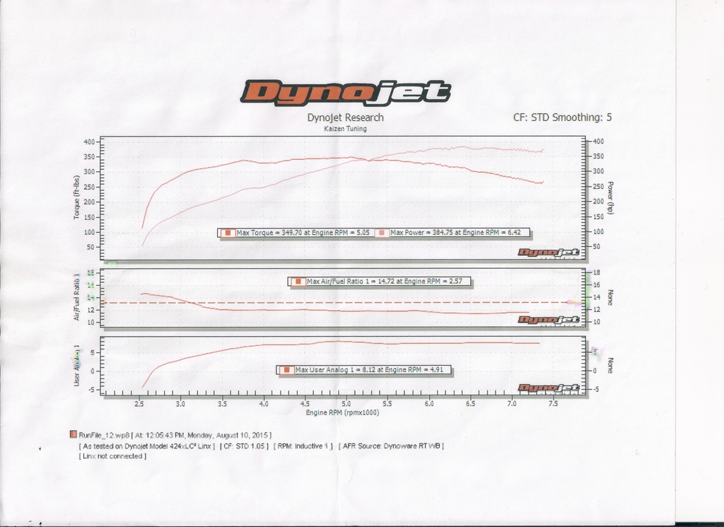

Hey guys hows it going ? So i have an aps tt kit (with the original bb garrette turbos- gt25's maybe? w/internally gated forge actuators) I'm just wondering when you guys are hitting full boost? I'm only hitting full boost(8lbs) @ 5k rpms which seems high for two small itty bitty turbos. I'm thinking it should be reaching that at around at least 3500 wouldn't you say? Just looking for some input. What could be the issue here? It gradually creeps to 8 lbs , i would think it would be almost instantaneous for small turbos.

Looks like you're hitting boost right after you start accelerating on the dyno.
Doesn't say psi on the graph.

[QUOTE=iideadeyeii;10750368]Looks like you're hitting boost right after you start accelerating on the dyno.
the bottom graph is the boost curve, at full throttle on the street it wont hit full boost till 5k.
