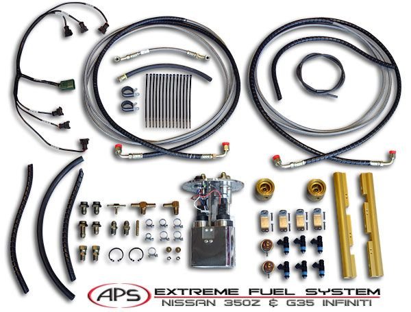

Well, still sorting through issues with my recent rebuild. Car currently sitting at mid 400's with about 11 psi of boost. had fuel issues that kept us going higher. Working through those issues, tuner advises to install 10 micron inline fuel filters.
He recommends a set of fuel lab inline filters placed as close to the rails as possible. Problem is, each bank is fed by its own fuel line from the front of the engine. this leaves very little room for this type of filter. The short filters state they are 3" in length. there is definitely not 3" of space in that area.
My thinking is I have to pull the lines and cut each of them into two pieces. This would allow me to install the filters inline as they run along the firewall before tucking under the intake mainfolds. not the easiest install, but I think it might be the best. obviously before I go to this extreme would like to know if anyone has a better solution.
For reference
as you can see, the fuel lines are a single line running from the pump all the way to the rails. in the pic, they are the two long lines in the upper right with the red caps:
here is the front of the engine where the lines feed the rails. very little room for inline filter:
this is approximately the area I was thinking I would separate the feed lines and have new fittings install to accommodate the inline filters:

the standard sock in fuel pumps is usually 100 microns, thats about .004 inchs for a fuel that is atomized to damn near a gas state when sprayed thats huge especially when you consider the holes in most injectors are .003-.004 inchs. even if the holes where twice the size it dosnt take long to clog, your average automotive fuel filter is 65 microns and after about 20k miles without changing it(an actual filter not the sock in the tank) they will get so clogged from pump fuels you can even blow through them. the after market ones can be cleaned out but i can tell you in professionally built systems you will usually have a 100 micron pre pump, with both a 65 and 10 micro post pump that get serviced every couple oil changes depending on use of the vehicle. the entire factory fuel system is actually complete ****. distance to the rails the only reasoning i could imagine would be long term to capture particles as the inside of the lines degrade.

The white plastic fuel pump module that you insert the pump itself into, is the filter housing. This is why its important to add an external filter under the car when using twin pumps (CJM or the old APS), because these units do not have an integrated fuel filter in them (no room for it with 2 pumps anyway). IIRC, the Aps Extreme fuel system lacks any proper filter at all, depending on the fuel pump pickups as the only filtration. That sucks pretty bad. I would send the injectors out to be tested or replace them if its been run like this for a long time.
