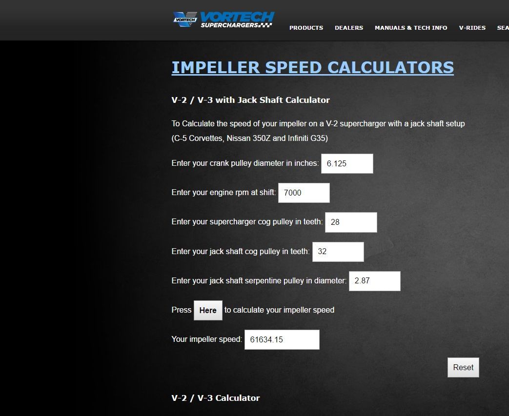

Hopefully that little difference past 60k wont be too crazy on the impeller.
If only I could swap to 2.37 and just wastegate the boost....but that doesn't cancel out the faster impeller speed. *sigh*
All the parts came in for the engine build, except K1 Tech decided to give us VQ37 rods so now the build is on hold again.

I spin mine faster than that.
Best way to go is a 34 tooth cog on the back of the Jackshaft.
Bleeding off the Boost is a waste of time and money.

Originally Posted by OldManZ350
I spin mine faster than that, over 40,000.....
Wait, you spin yours @ 100k+??
That's pretty intense, I'd be worried my impeller would freak out.
Thanks, it's just after the first pop I got a bit concerned. It's my first serious build I finally pulled the trigger on since I have a daily driver now.
Well the thing is there's always going to be SOME belt slip. So the calculations are always going to be higher than what the blower will actually see.
