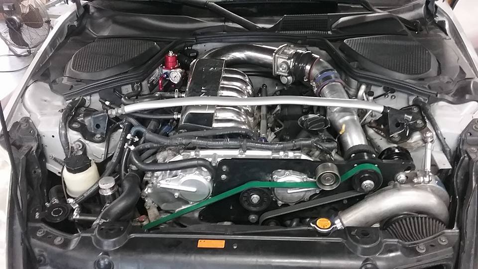

I am trying to get my Zr to 500whp on a vortech.
The motor:
Arias 9.5-1 pistons
Pauter I-beam Rod
Port and polished
3 angle valve job
balanced and blue printed
bored .020 over
wsx dry film lubricant on all bearing/friction surfaces
heat treated coating on pistons, valves and combustion chambers
Micro polished crank
HKS head gasket
Nissan HR valve springs
Arp head studs, main studs, and rod bolts
ACL rod bearing, main bearing, and thrust washer
Pathfinder cooling mod
Fuel system:
DW 1200 injectors
walboro 485 pump
Admin tuning Dual feed return system
exclusively on e85
Forced induction:
Vortech v3 sci
287 pulley and fluidamper
GTM pulley mod
Kinetix SSV (new style)
TIMROD
Exhaust:
Invidia N1
Momentum cat delete y pipe.
Tuned on uprev.
I am making low 424 whp and 380lb/ft of torque in hot and humid Lousiana at 12 psi on an extremely conservative tune!
How do i get to 500?
Thanks in advance.

Your on E85, with a built motor crank up the timing and raise your redline to 7200ish.
Quick question why do all that work and not put good springs and cams in the car?

OldmanZ350 has a Treadstone TR1245 Intercooler and sees great gains from his car, if you are using the basic Vortech Intercooler or an eBay cheapy like me, your intake temps are probably very high from ambient under boost. Cooler air allows for more advance timing and in turn more power.

I bought the motor used. I would have gone with cams, but it was too good of a deal to pass up.
I was also told that the HR springs would be sufficient for my needs.
Cams are in the plans. Maybe by the end of the year.

Ok then lay on the timing since your on e85

Gonna be pushing that sci hard to get the power you want. I would send blower to Vortech for the si upgrade. It's cheap and makes great power. 550hp@17psi on my old setup.

What IC do you have?
You will never make 500whp @ 12psi on your setup
1. change out the Intercooler to a TreadStone TR-1245
2. Change to a V2 Ti-Trim
3. change to a 34T/28T Cog setup
And you should be good for 625ish who Range
And YES, you can Advance the Ignition Timing a bunch more with E85
Hope this helps

I have the stock intercooler but i am about to order the one that you suggested, right now.
How much whp do you estimate (you would have the best guess) do you think i can get with the new intercooler and a lot more timing while still keeping the v3 sci head unit?

Will a quility Tune and E85 should be able to make 560-580whp IMO
You will need a free flowing Intake and a free flowing Exhaust to get that though.
And you need to step up the speed of the SC with the 34T28T Cog setup

I've got very good breather mods but I'm a little surprised that you are at 424whp making that kind of boost....
Granted we spent days on the dyno trying to get the powerband I wanted (road race car), but we peaked at 427whp on a 3.33 pulley (8.3psi) before backing it down to my class max of 410 (flat as a board from 6000-7100rpm). 2.87 and ethanol would put the car around 500whp w/o a whole lot of issue. This was on a dynamics fwiw.

well, motor showed low compression and some scoring. also overspun the crap out of that si.
getting a 11:1 comp motor built, c2 cams and upgrading to TI trim.
