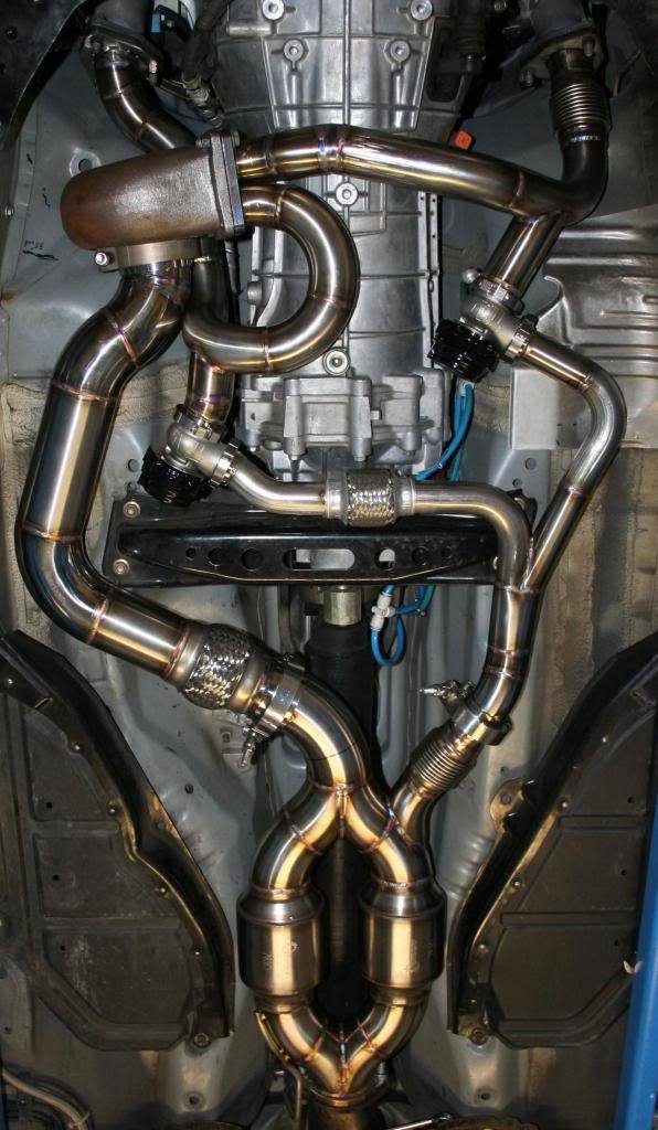

This was my solution:
These are two Mill-spec 100 cell 3" converters. Took care of the problem, without much sacrifice. I din't want to put just one in, as it would restrict flow more than I like.
I had made another for a customer using Vibrant Performance converters...these were not cheap:
