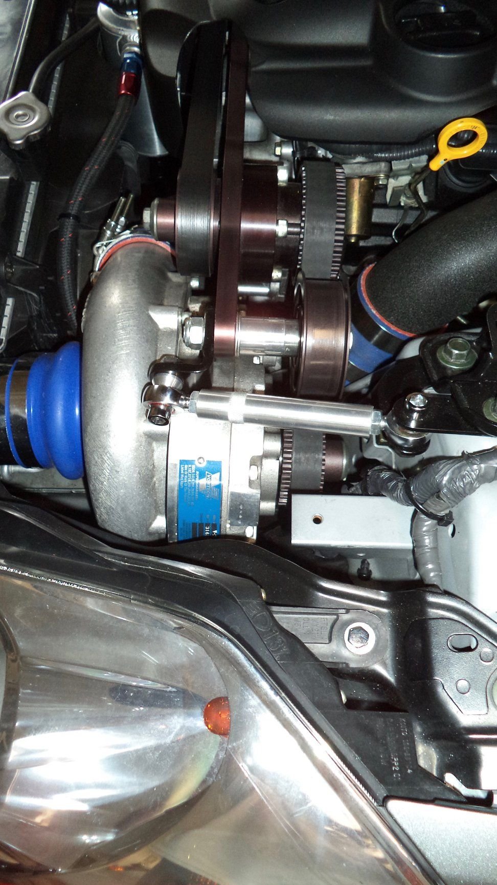

That's an Old Pic, I use a Gates Green Back HD Belt
Great Job on the 10 Rib......

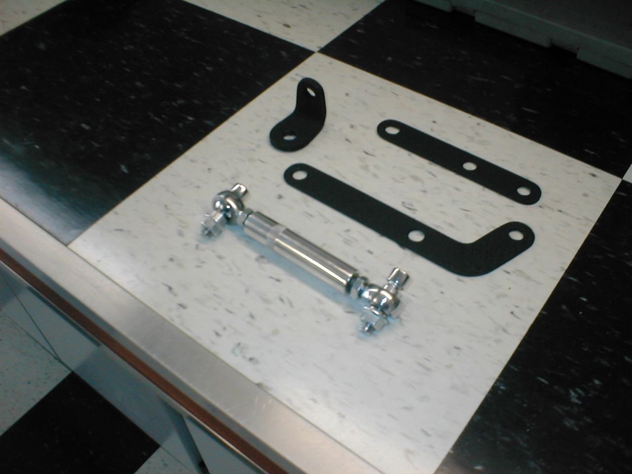

This is my solution for belt slip, a TimRod Radius Rod, It's held so far to 32 psi on my friends car.
