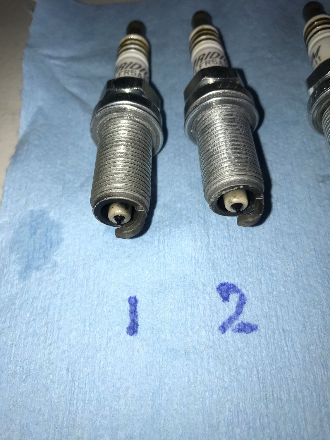

I don’t think so, I pulled the plugs this morning and all 6 of them were wet with gas and there is a strong gas smell from the cylinders. The plugs themselves don’t look to bad they were brought over from the old engine and I had changed them recently, probably less than 4k miles on them. Do you think I fouled them with the large injectors? I have to oem injectors in now and have the fuel pressure set at 52 which is what the Haynes manual has listed as the oem fuel pressure, do I need to drop the pressure for a return style system?
here are what the plugs looked like this morning when I pulled them
Plugs for cylinders 1&2
Plugs for cylinders 3&4
Plugs for cylinders 5&6
A brand new plug for reference
I have a cheap set of plugs coming today that I’ll try after the cylinders dry out, also have a set of unused LFR7AIX plugs but I feel like those are way to cold to use in a 8.8 compression engine and while the engine is NA at that

I doubt it's the plugs ... they'd all have to be 100% fouled for a no-start and they dont look that bad.
I would do your best to verify spark and then mentally prepare yourself to swap harness ...
