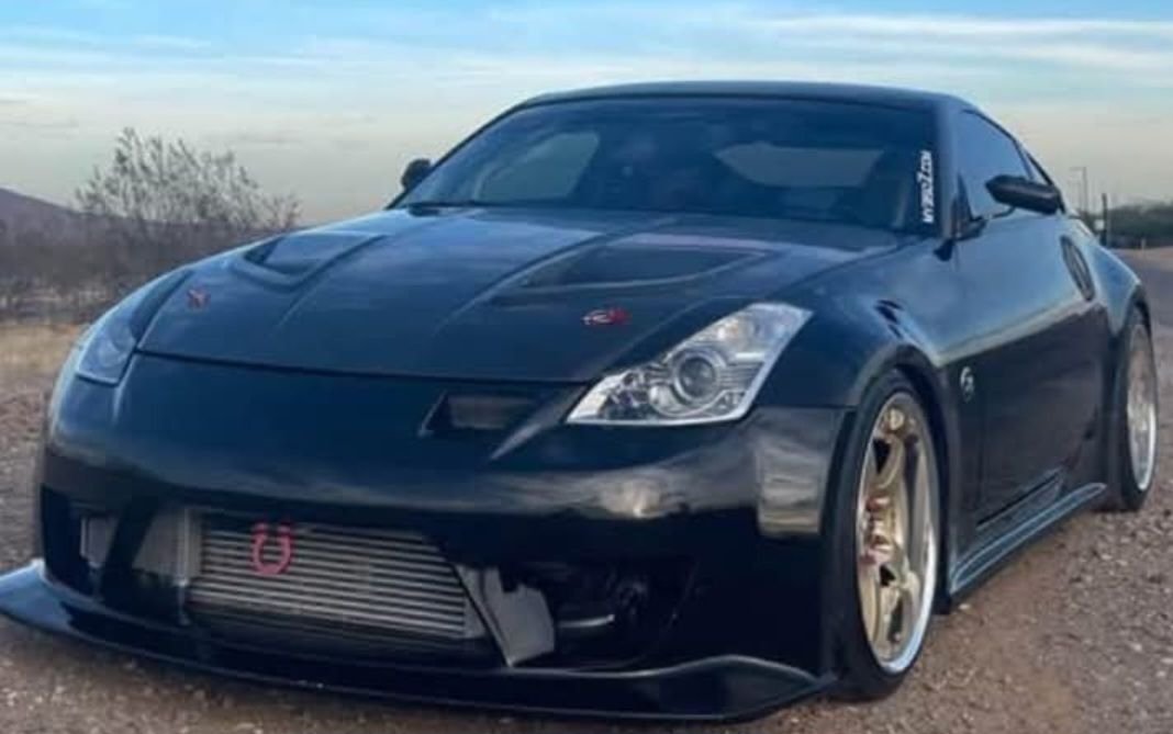

Nice ride. My hood is vented but not in the middle. My biggest data point is that my temps only rise at highway speeds. I think I need to get rid of turbulent air behind the rad and I need venting in center of hood.

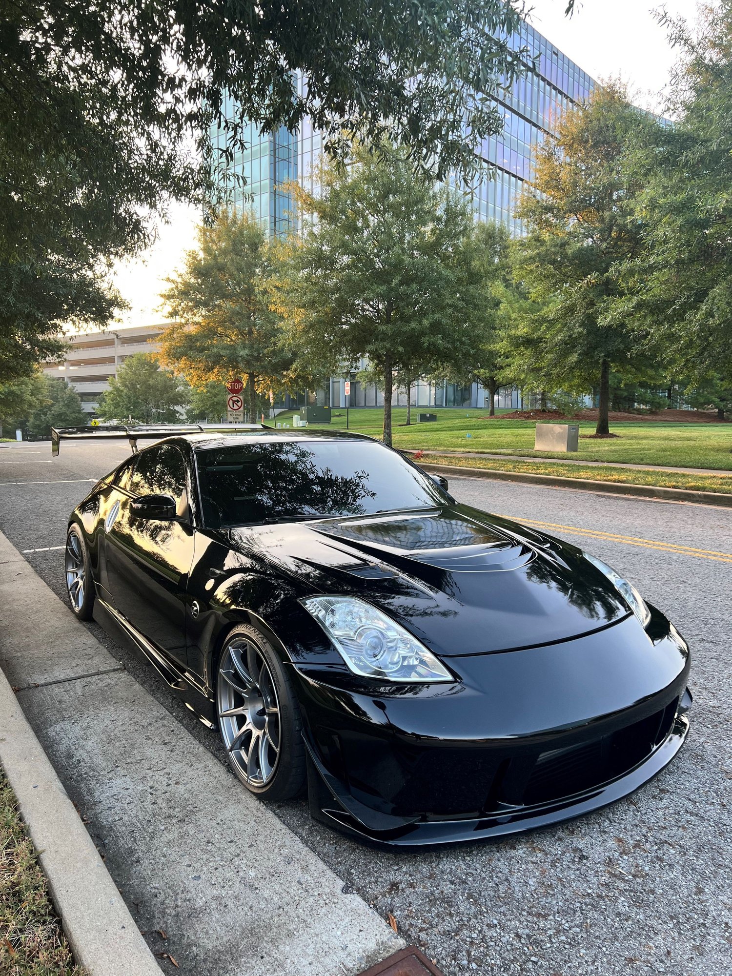

Car looks awesome, I love the Volk GTS (used to run those as well back in the day). Mine is also an '03, so small world here!
It is a bit odd that's overheating at highway speeds...does seem like there's some kind of issue with turbulence and getting the heat out...also curious if you're even able to get the oem aero pieces behind that bumper...my chargespeed bumper has that issue with the intercooler (not enough room really). The heat in AZ is serious...I do think there's a good chance a different hood would help, but might have to look into the radiator and fan/shroud combo as well.
