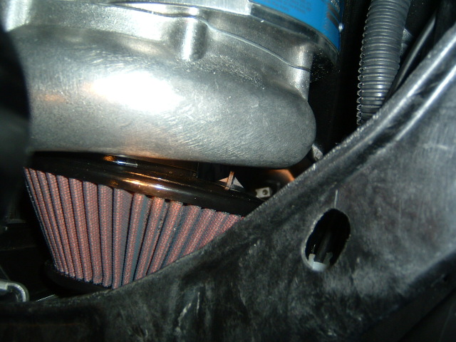

this filter installs and removes w/o any blower movement.......
the Z comes w/ a different size/shaped conical filter, taking better advantage of the space infront of the compressor (the coupe has little room whatsoever infront, whereas the Z has a window going thru the rad. support)
you can always request the filter for the coupe, if you buy the kit!!

I have the smaller filter as well. It is the G35 filter. It looks clean and fits a lot better than the 350Z filter.

The air filter CAN be removed with out taking off the blower . Remove the inner front wheel well [easy] Losen the clamp on the filter .Push the filter down and to the right , and it will come out easy . Clean and replace in reverse .This is for the G35.

for mine, i would just loosen the hoseclamp (via flathead screwdriver), and thas it...
the filter then comes off, after a few turns/tugs....

So do you just request the G35 filter in order to be able to get the filter that you can remove without removing the whole SC unit??

sure, i guess? (*shrugs*)....
get steve to make sure it isnt already on the Z kits now....... (should be, IMO)
