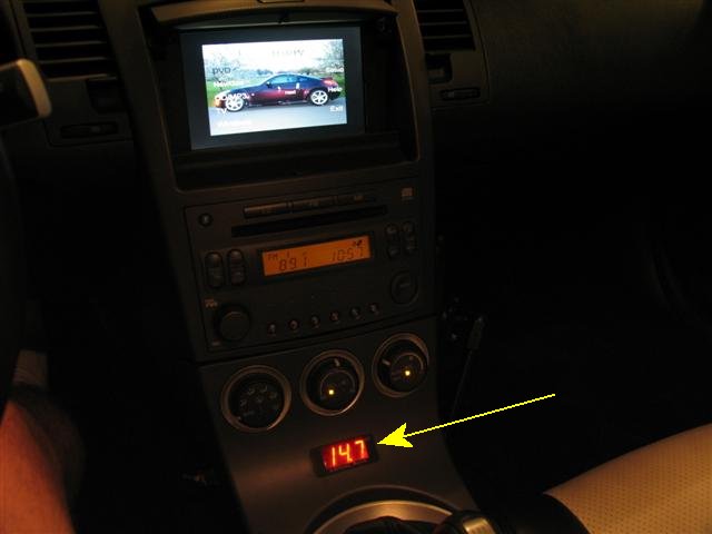

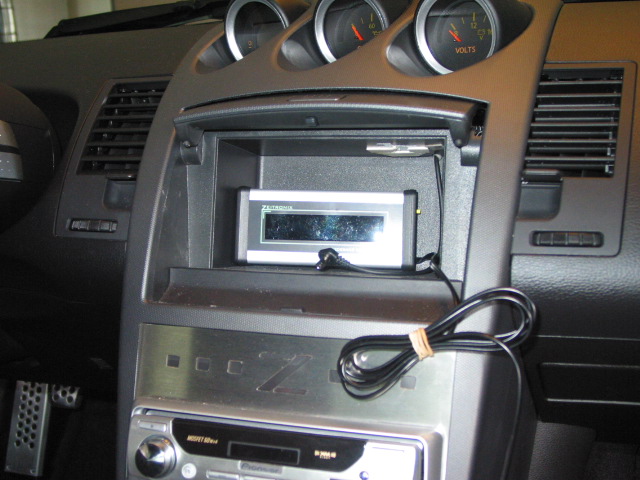

Chris, I think it works great. I've used mine for 2000 miles so far with no problems. I got the display and I think it looks great. It's aluminum trim matches the Z's interior great. This is a pic before I mounted in the top of the nav box.

Chris, mounted mine like CaneZMD inside NAV compartment on a a piece of CF from www.reenmachine.com. Ran the wires through the "firewall" where the wires lead to the ECU inside the battery compartment.
A bung in my driver side R/t Cat for A/F. A tap in my passenger side Cat for EGT. Mounted "boost " sensor just outside the battery compartment, next to the firewall.
