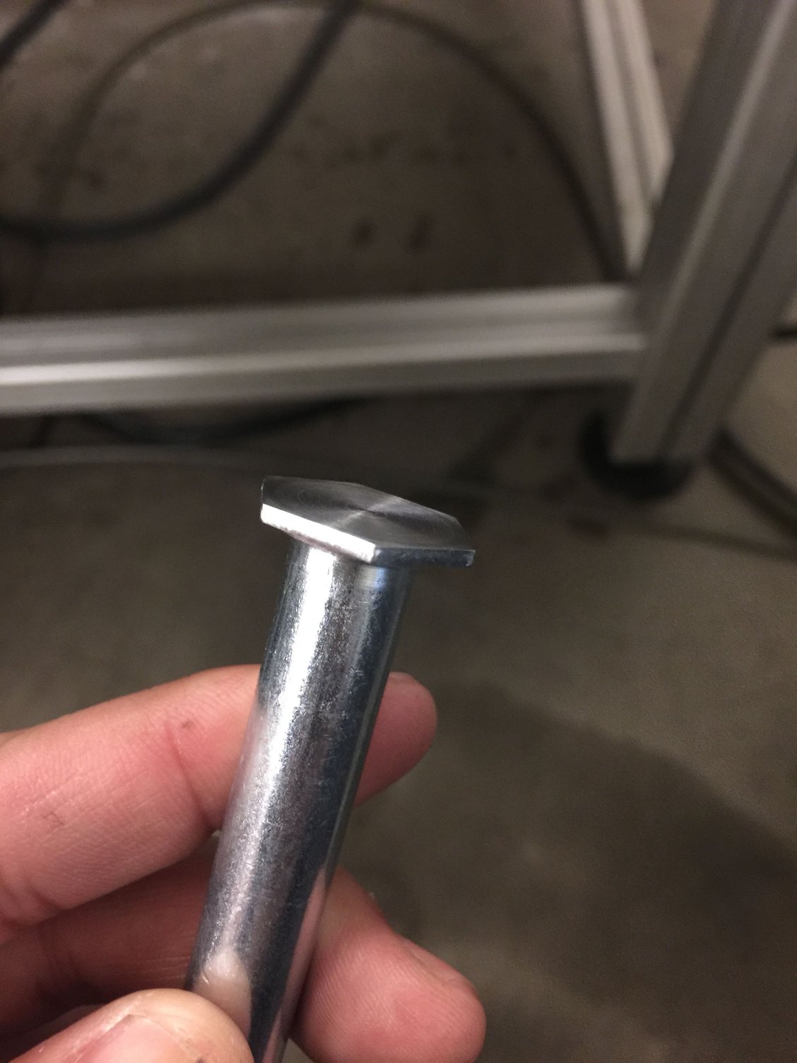

had the bolt grinded down .2 of an inch....um will this hold can i even put a socket on it to torque it???

machine (or grind) the Head Hight down to about .200 in.
Head should be about .200" Thick
It Does Not say remove .200"
