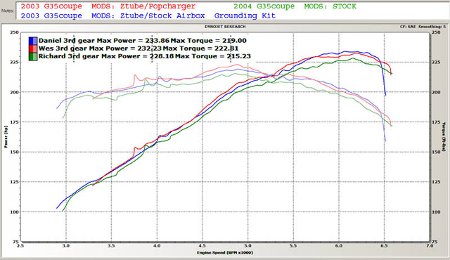

This is the 3rd time I've tried posting a reply to this thread. Each time I try to add a picture and the darn thing goes awry. Anyway, this time I'll post the data in this message and THEN try to follow with a picture to show what I'm describing.
The following picture is a dyno showing a stock G35 5AT coupe, a 5AT coupe with the Z-Tube and P/C, and a 5AT coupe with the Z-Tube and Stock Air Box. Notice the following...
1. The JWT P/C, with the hood open and fan blowing directly on it shows similar gains as the stock airbox. Compare the dyno in the following thread. Check out the area under the curves, they're almost identical.
2. The P/C, on the dyno, is in an IDEAL situation. The engines were not heat soaked, the hood was open allowing better than normal air flow, and the P/C was not injesting hot engine air, etc...
In summary... the P/C costs in the neighborhood of $120.00 for basically no performance gain over the stock airbox. With hot, humid summer weather the P/C really does lose hp. It can be felt by the seat of the pants and can be "logically derived" from the data shown...
...now here's to hoping the darn image works...

Originally posted by xXVanquishXx
So, would the best setup be Z-tube with stock air box and add a K&N high flow filter? Or, would adding Stillen's CAI with Z-tube be better or are both about even? Does the Stillen intake have that cool whistle sound like the JWT?
I cannot imagine running a popcharger for just another 2whp, given it is parasitic off the line, it has to get it's power from your engine and you won't realize the benefit of "7 whp" until something like 5200 rpm. I seriously doubt it shifts the hp curve up +7 from off-idle.
You would do better to look at things like possibly the larger plenum and incremental improvements unless you're up for a big boost via the greddy route or you want a new hood and a roots style supercharger from Stillen.
If you like the whistle, go join the Bubb Rubb Woo Woo crowd and weld plates in your exhaust
