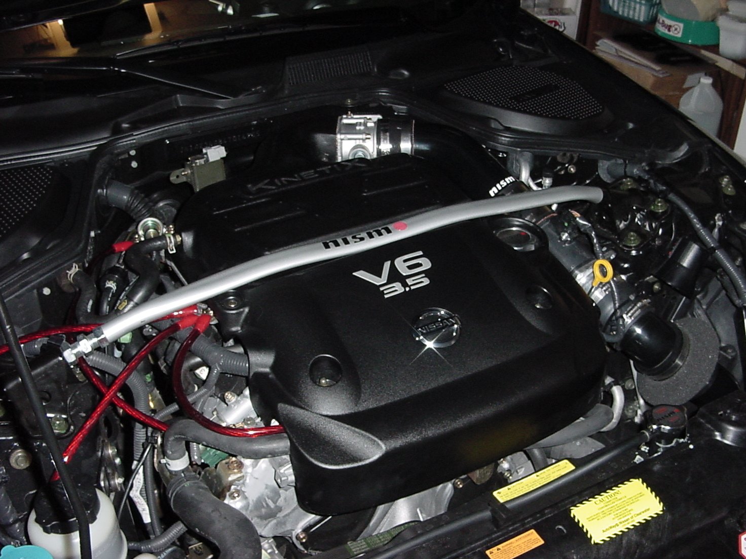

Just insert a business card between the bar and the plenum. If you can slip it through, you are fine.
http://www.quiros.net/350z/images/kxplenum2.jpg

I can slip a business card underneath it. Tried that after installation. Thats why I'm wondering whats going on. I think the motor mounts on this car allow the car to flex way too much. Going to adjust strut bar now

A credit card wont bend to fit. The stut bar fits into the indentation on the plenum that is specifically made so that the stock bar will fit. A business card can bend to fit through that indentation. As long as the bar is not touching the plenum, you are good to go.
