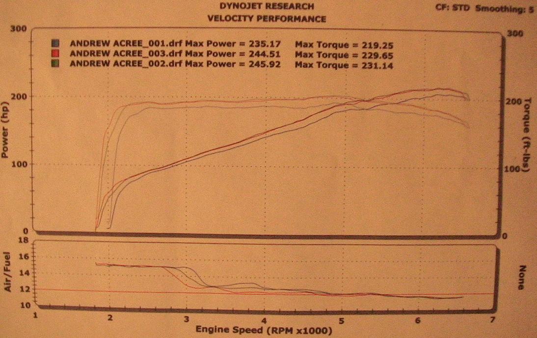

that is definately surprising for the new engine. i recently got my 05 enth with 8800 miles dynoed on the dynojet and had a peak of almost 246hp and 231ft/lbs. do you think that running rich up top is taking away that much horsepower? also, what is your daily driving style? personally, i am 18 and i drive the car like it is a sports car. therefore, i am almost certain that the car has tuned itself for more fuel consumption.
There are three basic maps that the ECU can select based on driving conditions. The trick to getting max dyno numbers is to take it out and really beat on it right before you hit the dyno. I mean take it out on the backroads near the shop and really run the car hard to redline. Pull directly up to the dyno and shut the car off. This will hopefully get the ECU in the advanced map which adjusts the AFR/timing for optimum power output.
I learned this the hard way and got some disapointing numbers when I dyno'd my car for the first time.
