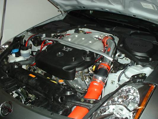

I just put it on right after my exhaust mods. In the driveway I can hear a whistle, but on the road its hard to hear over the exhaust. Since I did these all pretty much at the same time I cant tell one mod from the other, but on a hard launch it spins them through 1st gear and into 2nd.
2.5" Y pipe
Flowmaster 80
Injen
Grounding kit.
Plan to dyno again soon to see the improvements.

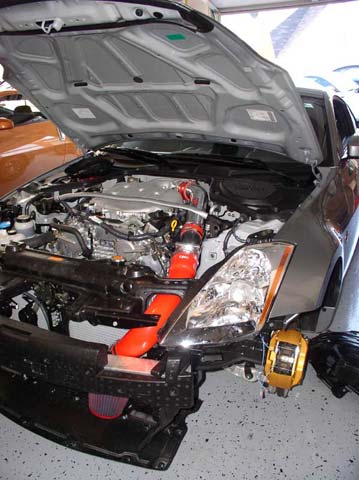

another pic of the intake. I'm sure there will be some comments about the install on 350zfrenzy.com later, as 11 of us met at my house today and did some installs and took video of my car for sound comparisons.

Thanks for the info. I will look for that on 350zfrenzy. I was concerned about how the red connectors and silicone tube would look on a CS car but the pics. I've seen don't look bad (including yours). Does it look OK in person?

I think it looks great! I was concerned about the whistle noise we heard in the garage with it not moving when I revved the engine, because we had a dinan carbon fiber cai on our old bmw and the whine was kind of annoying, but on the road I couldn't hear it at all.

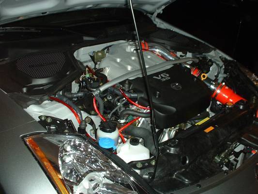

I liked the way it looked on 2003z's car. I am installing mine on my Le Mans Sunset this week. I wouldn't lose sleep over the color...I just want to go fast....
another pic of 2003z' car

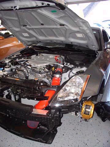

Do you have to take off your front bumper/fender?????

front bumper needs to come off, which entails removing 6 clips at the top of the bumper under the hood, 3 clips and 1 screw on each wheel well. 3 screws on each side of the bumper and about a dozen or so on the bottom trays, all in all, about 10 minutes work. Its very easy to do.

good deal, that was one of the things I was worried about. Thanks for the info.
