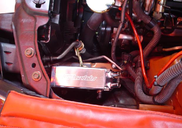

So which is it guys? Recieved my Greddy tank today. Looks like it might take some creative plumbing to get her hooked up. Seems the Injen hose (the one with the filter in it) is 17mm. Only place I found hose this size was on the Injen website. Probably could use 3/4 hose, but still only able to find heater hose in this size. Would really like to use silicon hose. Anybody have a lead on hose? Anybody used the Greddy tank? Where did ya mount it? About the only open space is the little area where the stock intake airbox used to mount.

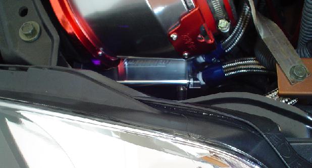

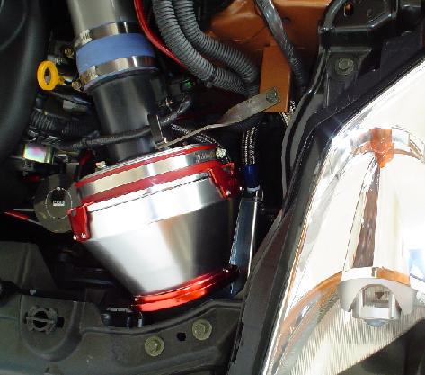

We have a really limited space under our hood to squeeze anything in. But managed to locate the greddy catch tank under my filter. We had a custom bracket made to hold it there. My filter heat shield was basically in contact with the tank, so I stuck an insulating sponge in between to prevent any rattle.
I opted for braided hoses for a more "showcar" look though it'll not be necessary as there is no high pressure involved.
Attached Thumbnails Took off my Injen intake last weekend and saw something I didn't like.-catchtank1.jpg

More pic
Attached Thumbnails Took off my Injen intake last weekend and saw something I didn't like.-catchtank2.jpg

last one
Attached Thumbnails Took off my Injen intake last weekend and saw something I didn't like.-catchtank3.jpg
