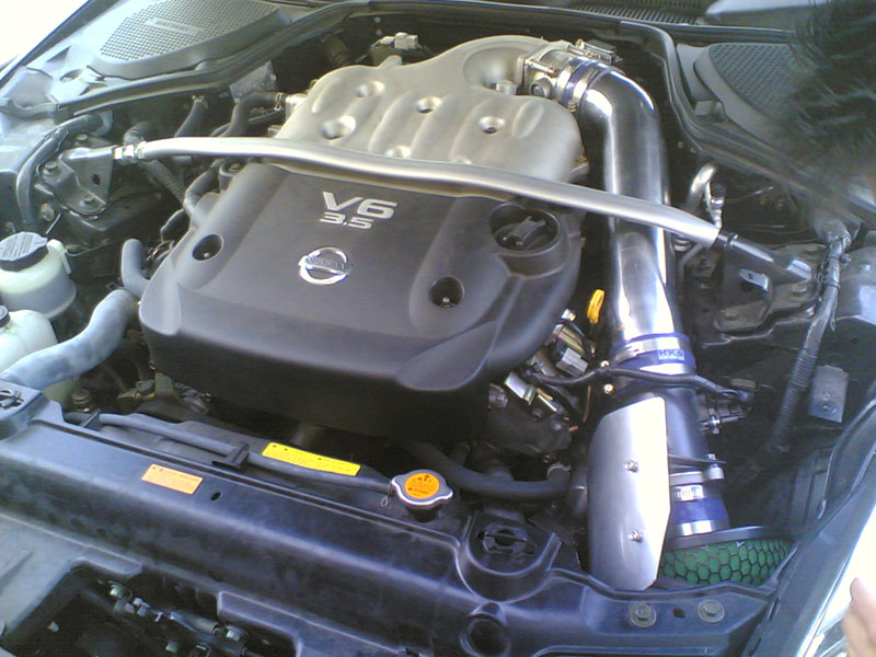

I didn't even take off the MAF sensor housing. I only disassembled the Factory air flow meter and with HKS intake, there's only one way to connect it.

iTrader: (32)
Joined: Feb 2005
Posts: 1,568
From: Woodbridge NJ
Looks like you put the housing backwards

How can MAF housing is backward if I didn't even take it off from Air Flow Meter Adapter?
check out this link:
https://my350z.com/forum/intake-exhaust/177606-hks-suction-intake-installed-w-pics.html
