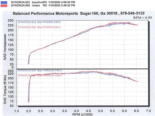

yep,
0.4hp over stock
3.3ft lbs over stock

if i remember right... after looking at your dyno graph.. there was something wrong with your first run (stock).. i think you made like 223 RWTQ.... that is about 10-15 ft-lb lower than stock should be. i cant believe you really got 20ft-lb from an intake... unless it includes nitrous also !!!
my numbers with just a k&N: 241.7 RWHP 237.9 RWT
m
oh yeah... next saturday i will be re-dynoing to see if the injen does anything over a standard k&n...
It doesn't matter if it was 150RWHP, some Dyno's read different than others. The proper use for them is to show what mods add gains (which is what I did) not to get the highest numbers you can.
I added the Injen and showed those gains the baseline numbers don't matter, they are irrelevant in this scenario.
As for something being wrong with my Dyno I am quite happy with it, its very sooth, smooth as silk, especially when I look at the choppy one just posted. My car runs great and all I have done is intake and exhaust at this point. My LS1 was always choppy and it always bothered me! Smooth is good and he used 5 which shows as much problems as possible. There were none.
Some people get too caught up in Dyno numbers. That is why I prefer track times. Much better assement of your car and what each mod did.
If you go do a 14.0 at the track and then add an Injen the same day in the same temps with the same track prep and you run a 13.8 to me that is a much better test than a Dyno run.
Just my opinion, and the Nitrous goes on tomorow! Then my Torque will be waayy up there!! I will add tons of torque with this mod. Should I plan on all this disbelief if I dyno with the Zex kit too? If so I'll save my 60 bucks because it doesn't really matter to me, I will be going to the track with the Nitrous!

2003z,
The dyno you are referring to seems like the car is having a problem with detonation or a lean air/fuel ratio. Most dyno graphs should be smooth and not choppy like the chart that was shown. Perhaps the person should switch to a higher octane gasoline and re-dyno the vehicle for more accurate numbers.
Phillip
Injen Technology

2003z
Posts: 4,959
From: Atlanta
He used high octane (93), so did I, mine was choppy like that too.
I actually lost 4 hp, with injen, y-pipe and flowmaster, but since I don't know what the culprit is, I didn't include that.
