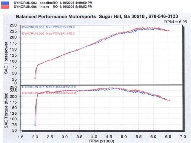

well I just saw the before and after dyno from Lemans350Z's runs with the Injen and it didnt even make 1.0HP over stock! And the ft lbs was about 2.5 I think. MUCH MUCH lower than what they claim! Anyone have an AEM before and after??

here is the actual dyno
GAINS
0.4hp over stock
3.3ft lbs over stock
+-$250

Default All Dyno's are different, numbers vary.
I posted back to back Dyno graphs that showed 3RWHP and 20 lbs of Torque from my Injen CAI!
Hogan,
Since I think you are switching some exhaust parts soon my 2 cents is the CAI over the JWT Pop Charger.
Less restrictive exhaust with more cold air in will provide better results performance wise. Exhaust out = good, cold air in - good win win situation and with 3 chambers back pressure will not be an issue, I think you will really like the growl with the Injen CAI too.
Of course this is an opinion, but I went down the road you are going down already and backed it with Dyno numbers.

im looking over your pics and see that there is also a few exhaust mods / changes that were being done. 20ft lbs to the wheels, hell even to the crank is nothing less than a bolt-on part miracle!! is this along side your exhaust mods too? or are you saying that you did a 100% stock baseline run to get you numbers, installed ONLY the Injen intake, ran it again and you ended up with 3hp and 20ft lbs more at the wheels from ONLLY the intake?????

I'm with kj-350 if 20ftlbs was possible from only a cai don't you think nissan would have done it?

If you look at MaxHax's dyno, you will see that all the torque comes in a big lump under 3000 RPM. I'm not sure if those numbers can be considered reliable, because after the REV's pass 3000, the torque curve looks pretty much the same as the stock.
I think the 3 RWHP gain is pretty accurate, because that happens at the upper end of the rev range, but I don't trust the 20 lb-ft of torque simply because the graph is not smooth at all.
MaxHax, do you have an automatic or something that would allow the engine to do some weird revving down low? I still don't understand how that dyno graph you posted would get that way.
-D'oh!
Edit: Here is a link to MaxHax's Thread - https://my350z.com/forum/showthread....threadid=17513
I also see that you do have an auto transmission. Do you think that might have anything to do with the strange hump?
-D!

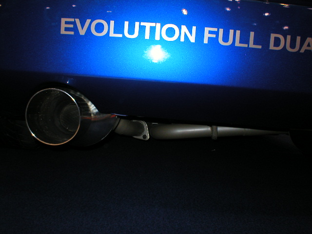

In regaurds to the true dual exhaust, if it is so great for the z why has only stillen produced one, while other companies are sticking to the stock setup or only one exhaust?

Greddy and 1 other company(I forget) had a true dual exhaust at SEMA ready for production. The biggest hang up is the routing is very tight using the stock sway bars position
