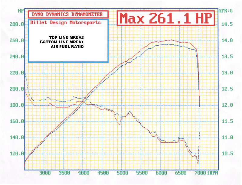

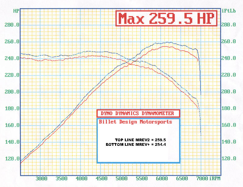

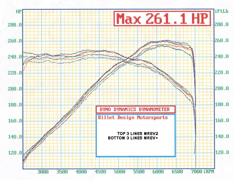

I decided to see if the MREV2 did indeed show an improvement over the MREV+ that I had installed.
The MREV2 arrived from Tony well packaged and I noticed additional machining over the MREV+.
I did have some aluminum dust from machining which I cleaned off using soap/water and drying immediately.
The swap was performed on the dyno per Tony's request and the engine temps were kept the same.
After doing the swap around 5 times, I had no trouble exchanging the lower plenum.
I did a total of 6 runs, 3 before, 3 after, with an ECU reset (pedal method) before the 1st 3, and the last 3.
I would like to mention that the run was done until the engine hit the rev-limiter so the last 500rpm or so drop off is really outside the normal operating RPMs.
In terms of the "Butt Dyno" I do see improvement around the midrange-topend.
It pulls to the top harder than before. I highly recommned this upgrade to anyone looking for more NA power.
P.S. Yes I know one of the plenum spacers was not installed when taking the picture.
Rob Dyno Video
Here are some of the Dyno's for you to check out:
Attached Thumbnails Revup MREV+ vs MREV2: Dynos Inside (both with 5/16th spacer)-allsix.jpg   Revup MREV+ vs MREV2: Dynos Inside (both with 5/16th spacer)-max261.jpg   Revup MREV+ vs MREV2: Dynos Inside (both with 5/16th spacer)-max259.jpg   Revup MREV+ vs MREV2: Dynos Inside (both with 5/16th spacer)-261afr.jpg

Did you need to adjust the A/F ratio??
Old Jul 13, 2006 | 06:37 AM
BocaCoupe's Avatar
BocaCoupe
Posts: 17
From: Boca Raton, FL
Not sure about the A/F ratio, but the car pulls stronger now throughout the mid-top end.

I know that these engines love to run rich since we also tested some z's and G's and they all behaved the same. Rich as hell!
