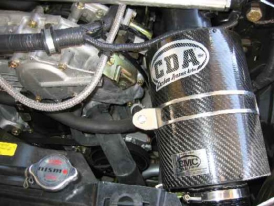

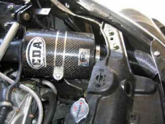

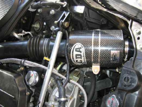

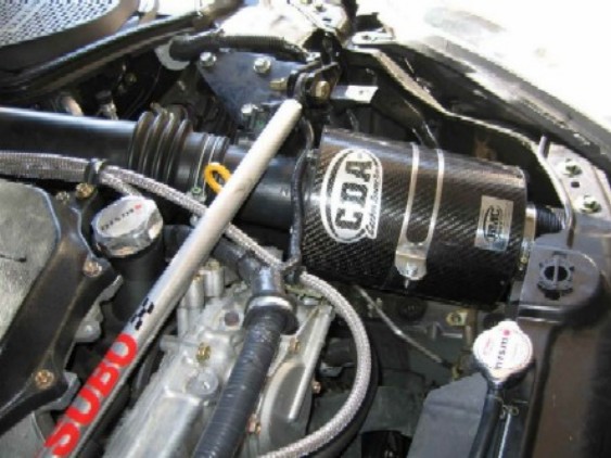

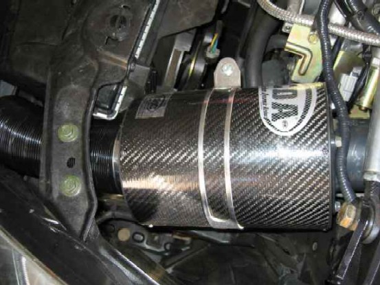

first of all i must give Performance Nissan a big thanks for basically giving me this intake. as all of you know who have dealt with these guys they are one of the best distributors out there. they have a very knowledgable crew and competitive prices. thank you performance nissan
the intake kit comes with a carbon fiber cylinder and a cone shaped filter inside. this filter can be cleaned and reused just like a k&n filter. the hardware that comes with the kit is below par...i ended up tapping out the holes where the map sensor tube mounts to the intake and using the same size bolts as stock but shorter. the screws that come with the kit are not adequate imo...the heads are barely bigger than the hole itself and they look like sheetmetal screws.
i don't have any pics of the kit before the install but this link does https://my350z.com/forum/showthread....&highlight=cda performance nissan took the pics before sending me the intake.
pretty simple to install the intake and the instructions are pretty easy to follow....with the exception of where to locate the strap to hold the intake. without the strap the intake stays securely in place so i left that out.
the numbers are as follows done on a dynojet:
234/217 with k&n drop in filter
239/222 with CDA intake (best pull out of the two)
i did one run when i got there before swapping intakes. the other two were with the CDA intake installed. i did a pre-installation of the CDA intake so the downtime would be minimal. i think the dyno is a bit misleading because we did the first pull shortly after i arrived. the commute was about 20 minutes.
unfortunately, i couldn't afford to have 3 runs without the intake and three runs with the intake. so i opted to do one run before i installed the intake and two after...ran me 80 bucks. i am also a little dissappointed given my mods which are as follows:
cda intake, crawford plenum, dc sports headers, crawford cats, fuji y pipe, and fuji ti catback.
heres some pics of the intake installed
Attached Thumbnails CDA Intake...pics and dynos-0011.jpg   CDA Intake...pics and dynos-0022.jpg   CDA Intake...pics and dynos-0033.jpg   CDA Intake...pics and dynos-0044.jpg   CDA Intake...pics and dynos-0055.jpg

Hey Road
Did you reset the ecu after the install? Also do you have a dyno graph, just want to see what your A/F is. Im sure there is some power to be made with a tune.
I agree, you should be making more power with those mods.
Good test on a new product though.
Later
Aceman
