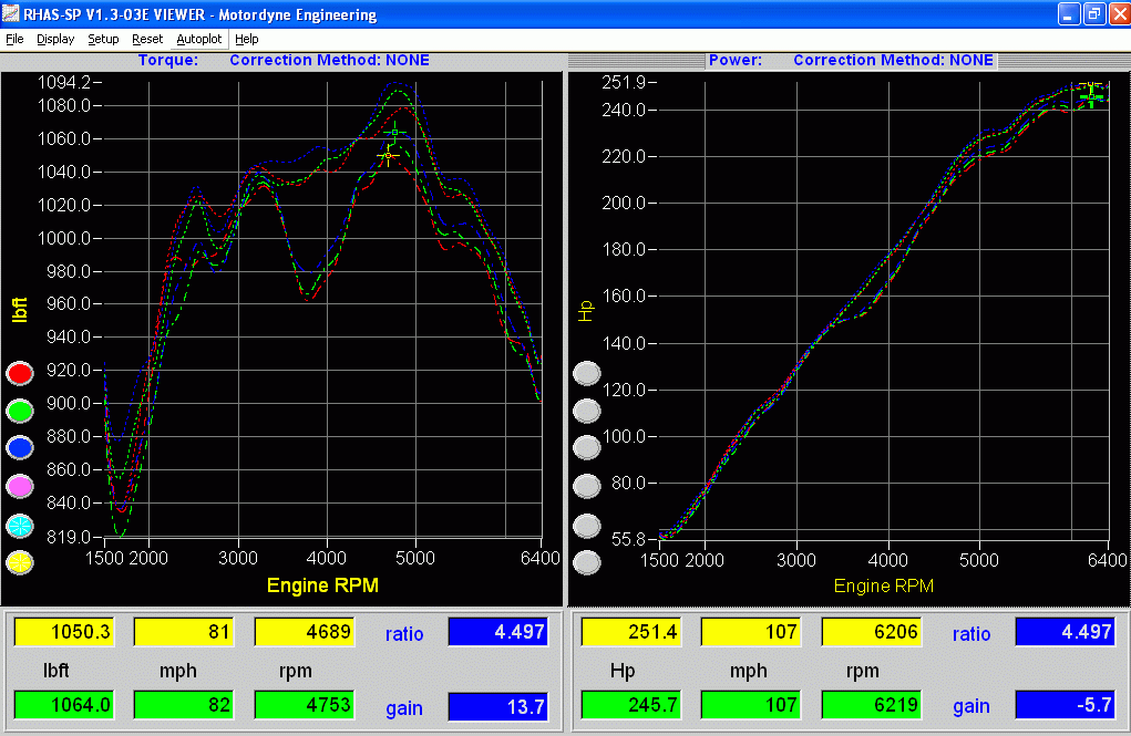

i dunno if i believe the 260 hp G sedan dynos exactly the same at a 287 Z. I have my doubts about that due to my boy dynoing sig less in his G then my stock 287 when i had her. There are differnces in throttle aswell as other minor differences mostly intake muffiling abit more restirctive, but i guess we would have to see a dyno plot of all models and plot them in contrast. Im not
saying u a lying but driving in both cars. Theres a huge difference in 2nd gear from what i seen. Its really hard to tell due to the weight etc which plays part aswell. But i have a really hard time believing the 260 tune is the same at all to the 287 becasue u would want to market the G at that hp to compete and surpass bmw which where showing less hp. Then again, with the new SAE standards its gonna be really hard pressed for anyone to lie about numbers or inflate without underratting i guess. However one major difference i did see at the dyno was the revup vrs the 287. peak hp was def improved drastically over the 287 tune uptop. But of course tq is decrese sig aswell. I guess until we have the concrete evidence maybey we will know for sure. especailly since everyone has diff dynos diff corrections factors.,lmao

The dyno data attached is from two different 2004 350Z's and G35 Sedans.
The overlaid plots are all on the same dyno, same dyno day.
Can you say with certainty which if from the Z and which is from the Sedan?
I assure you the only difference here is the daily mood of the respective ECU's.
Dont read beyond this point without first looking at the plots and making a decision
PS - the plot on the top is the Sedan. The only reason they have even a slight difference is the ECU temperment. They could just as easily switch roles the very next day.

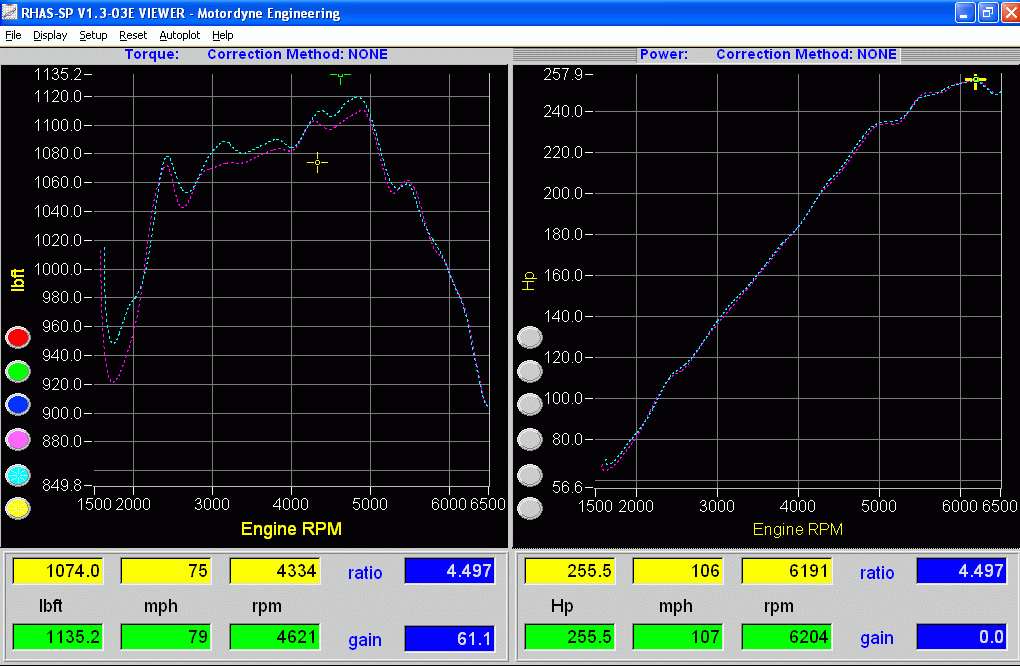

Attached is another dyno plot different day same dyno machine.
This is my G35 Sedan with nothing but a Greddy single exhaust. The exhaust sucks BTW. Its no better than the stock exhaust. The only reason I have it installed is because I welded in a O2 sensor bung behind the Y pipe. ...I didn't want to hack into the stock exhaust or the Stillen dual exhaust I had.
Compare my G35 sedan results to the results of the stock 350Z dynod for the Sport Z Magazine Plenum Mod Shoot Out. Essentially identical.
Compare the 350Z plot from the post above to the 350Z plot from the Shoot Out. They are within the normal variability of the ECU. So you can be sure the two 350Z are within normal range of eachother.
This isn't an overlay, but you can still compare them. Different day, but the same dyno machine. There certaintly is no indication that the Sedan has 27 fewer HP.
EDIT --> The link is a Z dyno. The attached picture below is from a G35 Sedan.
http://www.motordyneengineering.com/...tAnalysis1.gif

but, since Zs are tempermental at dynos considering i have seen Zs (287) dynoing 220 to 240 , isnt this not entirely accurate. But i do see that both vqs are tuned rather similar , though i would have to say that the ecu is deff more agressive in a Z then any other vq35de based platform. But i do see ur point. Greddy catback looks like it harmed u more then benefitted u lmao. I still to this day have not found a ehaust that give gains aswell as sounds good lol. HKS already seen many dynos of a wopping 5hp. So im confused lmao. Nice charts. Gotta love the line of a VQ though either way in its class def very linear.

It is. Assuming they are all done on the same machine, the G35's and 350Z's all have this variability and the same degree of variability.
The variability is driven by the ECU shifting all kinds of operational variables around. But in any case, its the same for all three vehicles.
If all three vehicles (G35S, G35C & 350Z) were blind tested on the dyno, there would be no way to distinguish one from the other. I'm sure it would be possible to reliably measure a difference in controlled laboratory conditions, but under real world conditions (a typical dyno day) they all make the same power.
